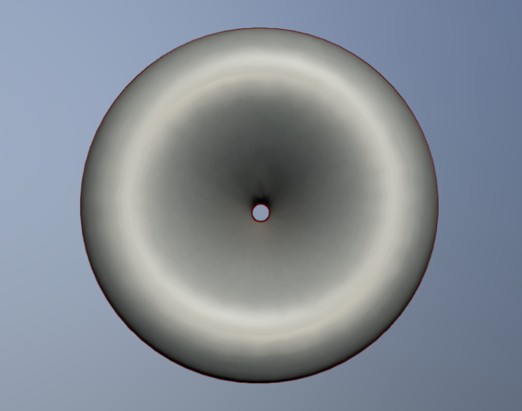

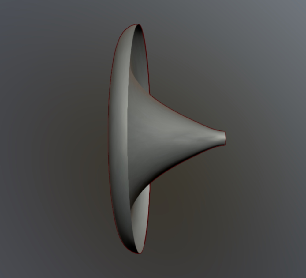

An oldie, with roundover as suggested by jzagaya.

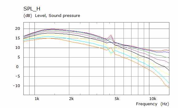

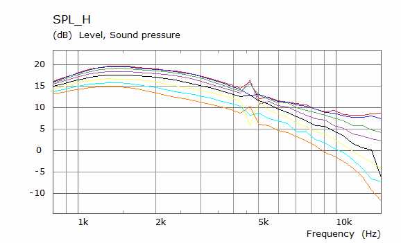

Here is one where everything looks quite good apart from one problem frequency, what do you think is going on here? Numerical instability or real issue?
Here is a medium density mesh
attachment.php
Then I made a much finer one to compare, most things are smoother but the problem area remains
attachment.php

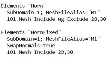

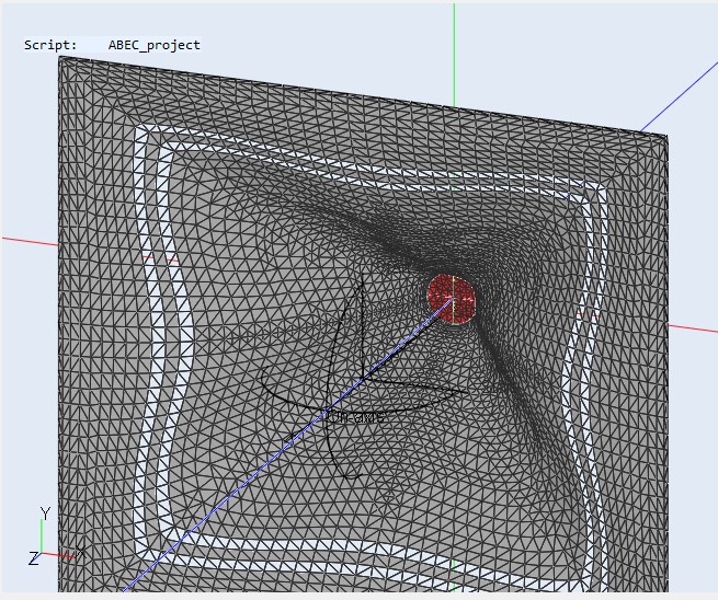

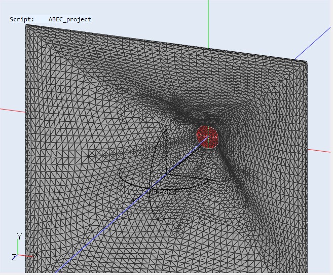

I have come across one small issue while simulating rectangular guides with cross shaped superformulas. Maybe this has come up before, I can't remember.
I seem to get some slices with reversed normals in the mesh from gmsh
attachment.php
With some guidance from DonVK I was able to fix it easily. Clicking on one of the affected triangles in ABEC shows the element number which can them be excluded from the mesh and re-included with the normals swapped like this in the solving.txt
attachment.php
Problem fixed :)
attachment.php
Is it a bug or something I'm doing wrong?

This is very strange and I don't have an explanation. All the slices are meshed exactly the same way so I have no idea how two of them could be reversed. I have never encountered this problem.
But I have a different hint. I noticed many times that with the new meshing algorithm (>= v4.5) the last slice at the egde of the mouth is very thin - this is genrally not a good thing. It should help to add the following line into the script:
Mesh.ZMapPoints = 0.5,0.1,0.5,0.98
You can decrese the last number (0.98) even a bit more, depending on how the last few slices will be meshes.
I suppose that narrow spikes in the frequency responses are related to so-called Non-uniqueness problem(NUC). If these narrow spikes occur I just ignore them.
It is well described in P.M. Juhl PhD thesis (chapter 5).
http://www.openbem.dk/docs/PMJ_Thesis.pdf
The non-uniqueness problem is a purely mathematical problem, inherent in the surface Helmholtz integral equation (equation (2.26) with P on the surface S), and was originally pointed out by Lamb [58, p.500]. Hence, the problem is not connected to any particular numerical implementation, but occurs regardless of the choice of e.g. shape functions. It was shown by Schenck, that the characteristics frequencies for a given exterior radiation problem (i.e. an exterior Neumann boundary value problem) are the eigenfrequencies of the related interior problem with the same body shape, when the pressure is required to be zero on the inner side of the surface S (i.e. an interior Dirichlet problem). For this reason the characteristic frequencies are also termed fictitious eigenfrequencies
That seems a likely explanation, Dimitrij.
NUC is mentioned in a lot of horn-related research literature, including the thesis of M. Makarski.

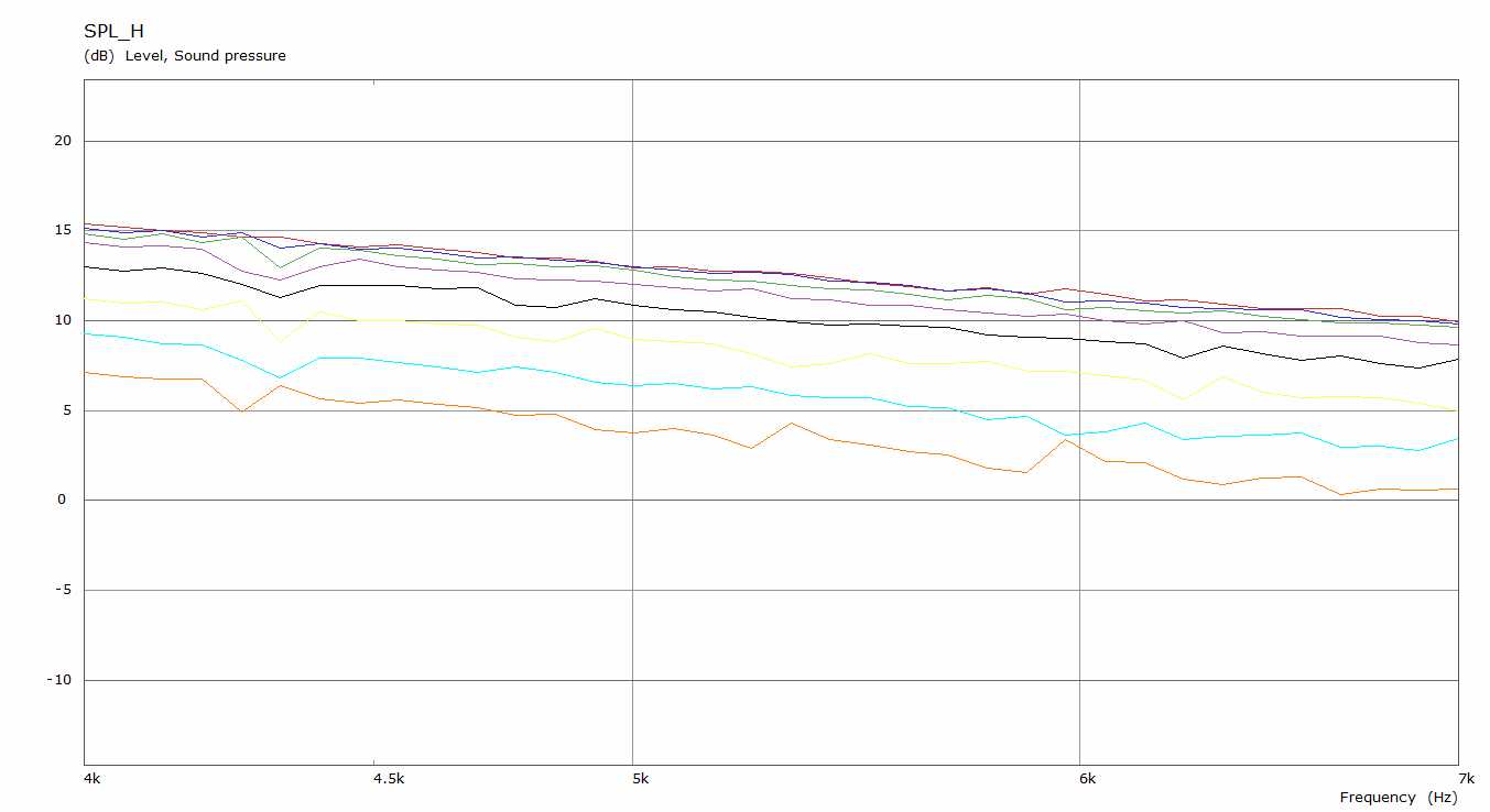

I bet on a "solution anomaly" as David mentioned. I can't imagine this could be real issue - it is so localized that I think this is not even possible. I would try to run it again limited to the range 4 - 5.5 kHz, with as many points as feasible (20 should suffice).

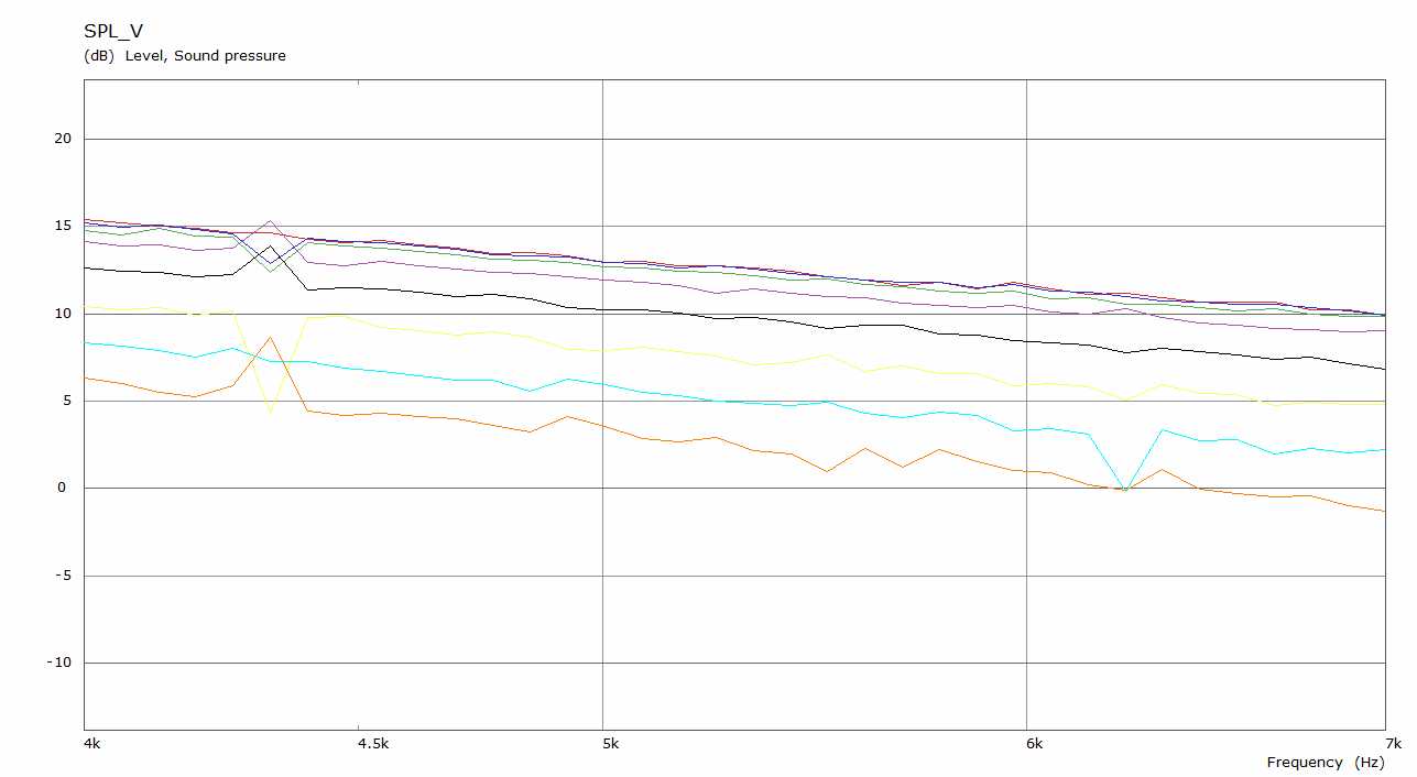

Problem area looks better when range limited between 4k and 7k with 36 frequencies
attachment.php
Now the weirdness shows up vertically when it was horizontal before
attachment.php
