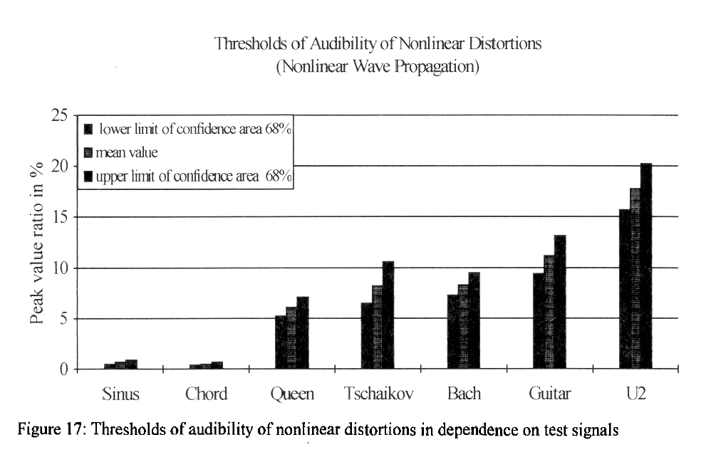

The graph below is from the same paper. It partially confirms the Earl findings, that audibility threshold of nonlinear distortions at some complex signals may be quite high (or may be strongly depend on the listening experience, in my understanding)
My conclusion was simply that: The audibility depends highly on the statistics of the signal.

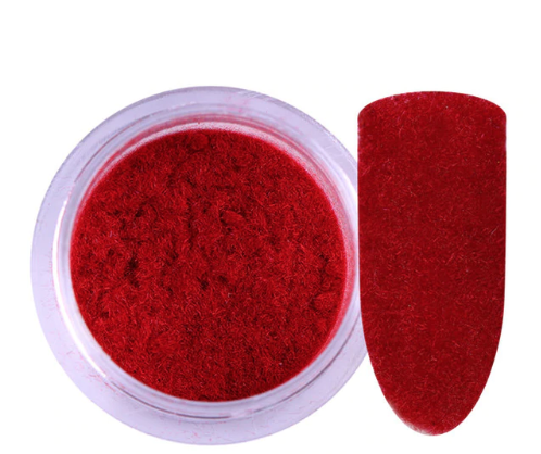

Thinking again about compression chambers in compression drivers, I'm wondering if applying a coat of velvet powder to the phase-plug wall facing the diaphragm could have a positive effect. Hasn't anyone experimented with something like that?
