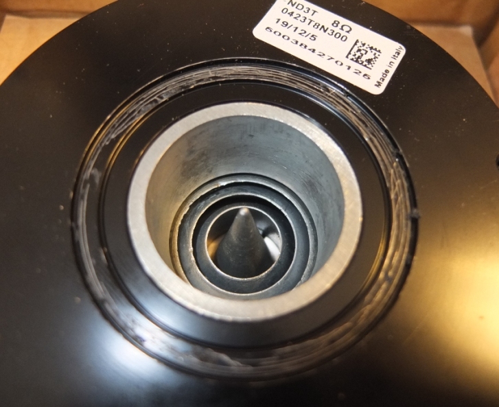

Well, I would be surprised if there wasn't an appreciable difference. Maybe not on both but the BMS 4554 has about 27° exit angle. Connecting this to 9° of the ND3T should be noticeable and detrimental, IMHO. I'm only not sure it will be possible to try.

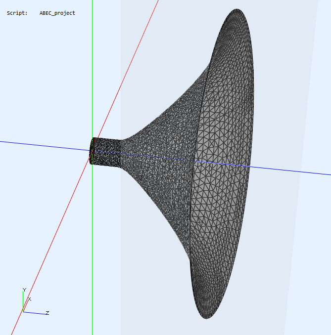

I don't know the answer myself. If you wait a while, it will be possible to simulate this easily - with Gmsh library it's a matter of a few lines of code to put a waveguide in a (rounded) box or even a sphere.
My mistake, I confused the ND3T with the ND4015 series that lack a conical exit section.
The ND3T wouldn't be my first choice to use with a waveguide.

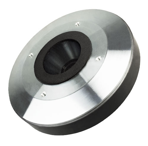

As for top octave dispersion, you'd probably be better off using a 3" diaphragm driver with 2" wide angle exit,
like this one (36° Conical):

My comment regarding the ND3T is just an assumption, measurements will show whether it is correct.

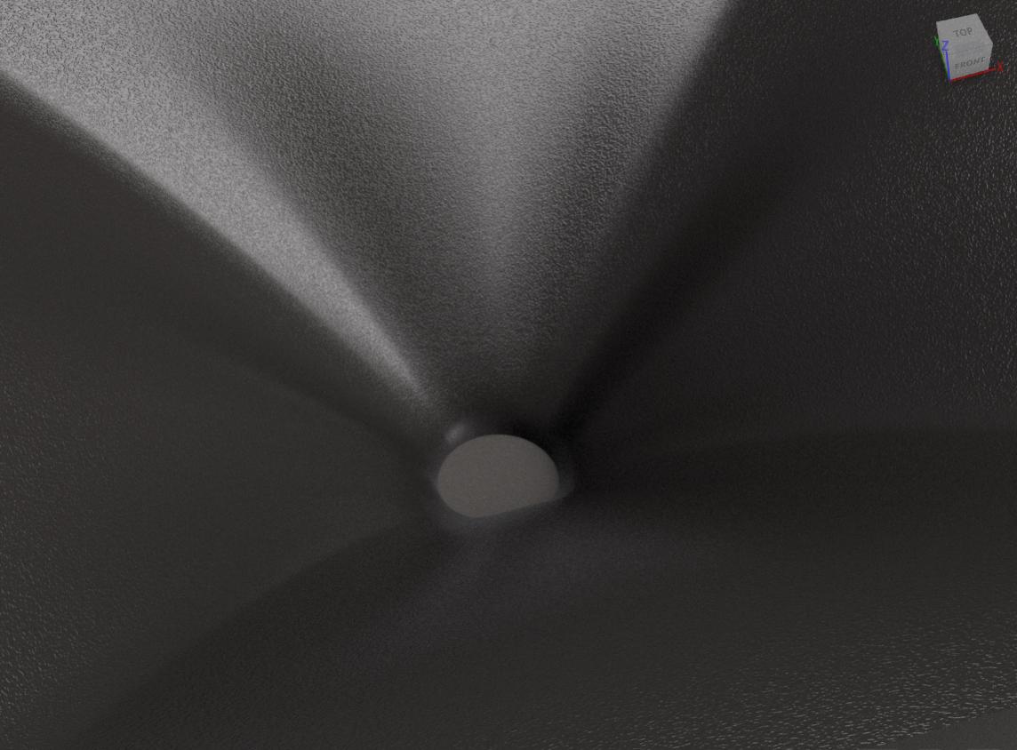

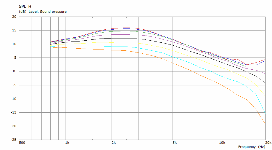

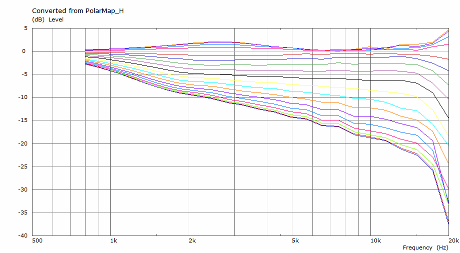

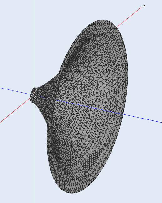

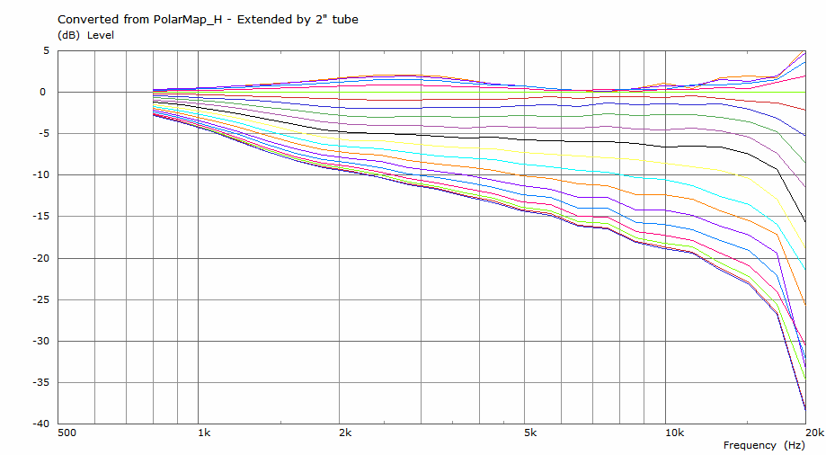

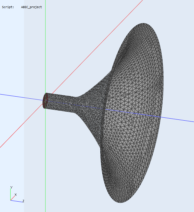

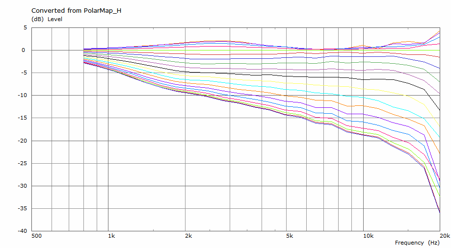

But I wanted to show something different - I extended the above WG by an 1" of a tube, driven by a plane wave (as before - throat angle is 0).
There is now a reflection, but the directivity is virtually unchanged. Some might have thought that the tube will beam by itself on high frequencies - that is not the case. It doesn't matter what's the "history" of the wavefront at the throat. In this case it's still just a plane wave as before.

Make it 2 inches (original on the left, extended by a tube on the right) -... I extended the above WG by an 1" of a tube, driven by a plane wave
What is beneficial is when the wavefront is already curved at the entrance of the waveguide for the same throat diameter (i.e. in the case of a higher exit angle of a driver of the same exit size, as for 4554 vs ND3T). I'd be not so sure that a higher exit angle in a bigger throat would still be better - this could be verified as well. Anyone can do it.
