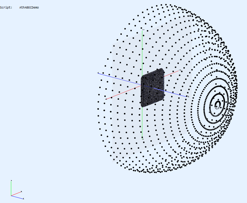

Ah, did you mean the "interface" (as in ABEC terminology)?
In the above the damping was added to the walls of the waveguide.
You understood correctly, damping should be applied to the walls, not interface (hmm, I have never tried to apply damping to the interior-exterior interface )

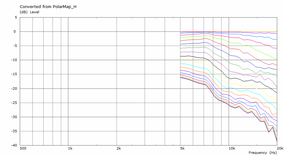

Yes, but even the value of 0.1 is to high. Typically I use the value around ~0.01
Of course, I wanted to see if it also dampens the numerical issues. For the value of 0.1 there are still some and for 0.02 it makes really no difference here:
But I'm actually quite happy with how it is - the mesh is still pretty coarse (high calculation speed) and the results are usable.
I would have thought that it would make no difference (as the interface should be completely transparent in principle), but Kees recently suggested otherwise (maybe I just didn't get it right, or don't remember it right).... hmm, I have never tried to apply damping to the interior-exterior interface

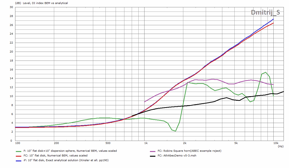

These are simulations of OS waveguides, as stated, so I don't quite understand what is the questionWhat is your target @mabat? It looks a lot like typical Tractrix-response to me with that gradually dropping energy response.
I was just wondering if you were trying to create something new, and had some kind of design goal.
EDIT: But as I read some of the latest posts, it seems like you are trying to get the right settings for the software so it is as close to real life as possible?
By means of these simulations I try to understand how different things behave. The goal of this all is to make better waveguides, without any coloration or other linear distortion. Which seems to be already fulfilled BTW. Only in the highest octave there is still place for an improvement - that would take the spherical wave phase plug.

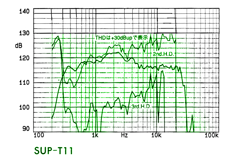

... This is not surprising as we commonly see 2 inch drivers are not capable of exceeding useful output past 14kHz.
Admittedly, it's not a run-of-the-mill 2" driver (4" diaphragm), nevertheless its response - clean up to 23 kHz - clearly rebuts your statement.
It outperformed the TAD TD-4001 by a margin.
This 1990s driver was measured by renowned MJ Audio Technology, the oldest Audio magazine in the world.
