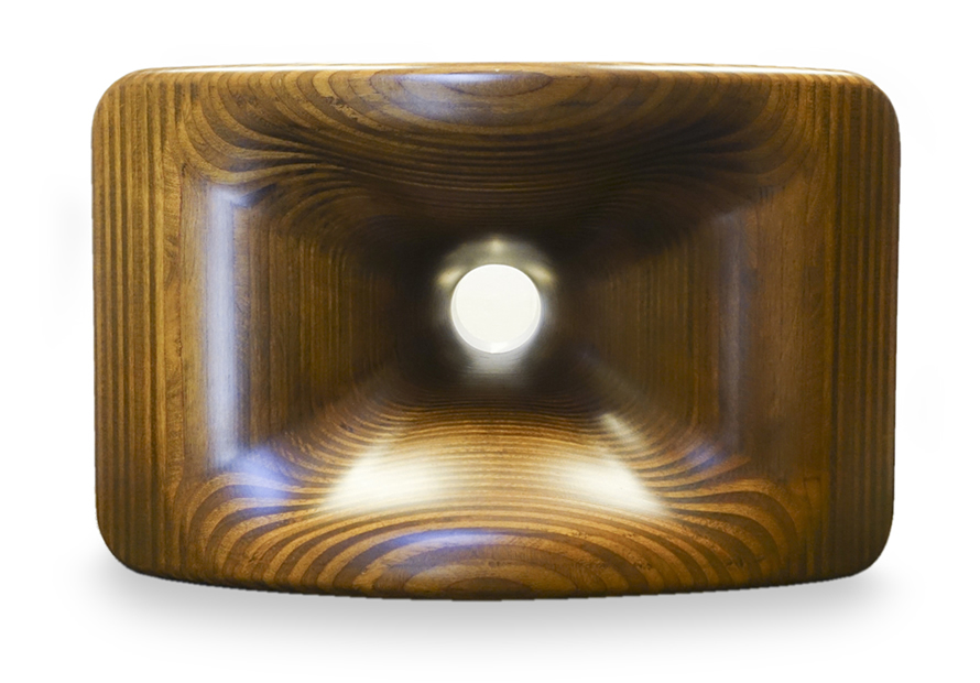

One of the corresponding horns (398 × 250 × 155 mm (W × H × D)) for the driver of # 2556 can be cloned - and improved upon, using ATH4.
Unfortunately that's too early to say, it depends on the driver, but even the biggest one should fit in about 105 x 105 x 65 mm (?). I just don't know yet.What are the expected maximum dimensions of the phase plug? I want to buy a resin printer in very near future.
What do you mean by "what was the horn"? This was a predecessor of the Tritonia waveguide I showed the renders of recently. I was actually an accident but worked pretty well. I could still reproduce the shape.

I mean what was the horn profile ? Was it OS or its modification?
Uh, that's difficult. At the beginning it is OS in every profile, at least for about 1/2 of the length, but as the final step this shape is stretched in the diagonals to form a rectangular mouth outline, so it changes - somewhere it is still exactly OS, somewhere almost OS, somewhere less so... So no, it is not OS (not to mention that a "pure OS" is only axisymmetric).I mean what was the horn profile ? Was it OS or its modification?

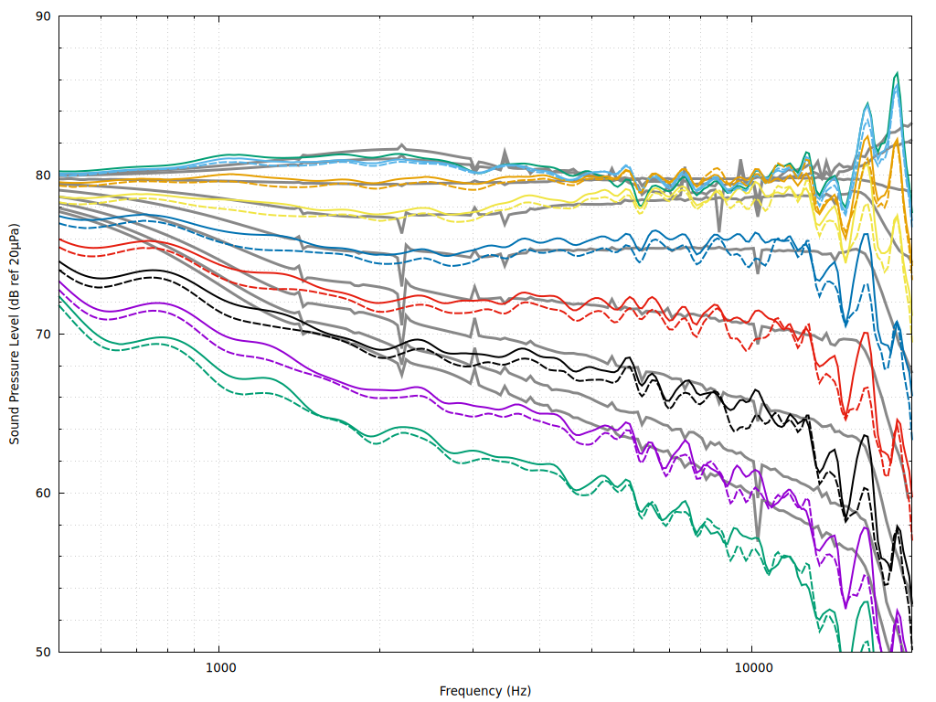

Here's some potentially useful data regarding simulated vs. measured as well as the effect of the cabinet:
This data is from my design (more information here). The grey curves are simulated (infinite baffle), 0° to 80° in 10° intervals. The colorful curves are corresponding measurements of the completed loudspeaker (solid is positive, dashed is negative... obviously I didn't get the 0° axis perfect 😱). The agreement is pretty good out to about 50°, but the measured data shows narrower dispersion beyond that, especially below 2-3kHz. I'm guessing that this is due to the diffraction around the cabinet. So, it appears that the cabinet actually improves the directivity vs an infinite baffle 😀.
Wonderful example, thank you so much. It's so good to see this kind of study. Bravo!
Thanks, this is something I wondered about a lot and hoped this would be the case. And indeed, it is 🙂...The agreement is pretty good out to about 50°, but the measured data shows narrower dispersion beyond that, especially below 2-3kHz. I'm guessing that this is due to the diffraction around the cabinet. So, it appears that the cabinet actually improves the directivity vs an infinite baffle 😀.

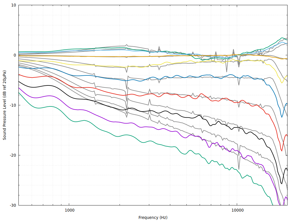

Here's another plot that should be a little easier to interpret:
The original plot had the simulated data normalized to the design axis (18°), but the measured data was not normalized. Here I've normalized both data sets to the same angle.
