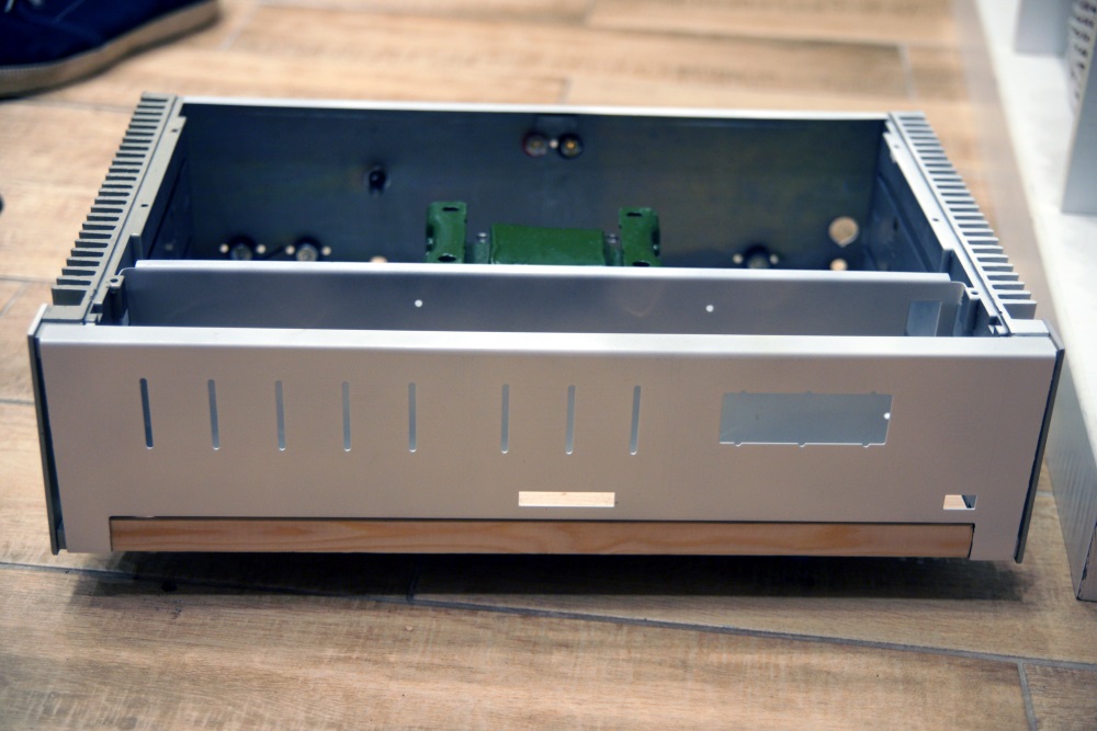

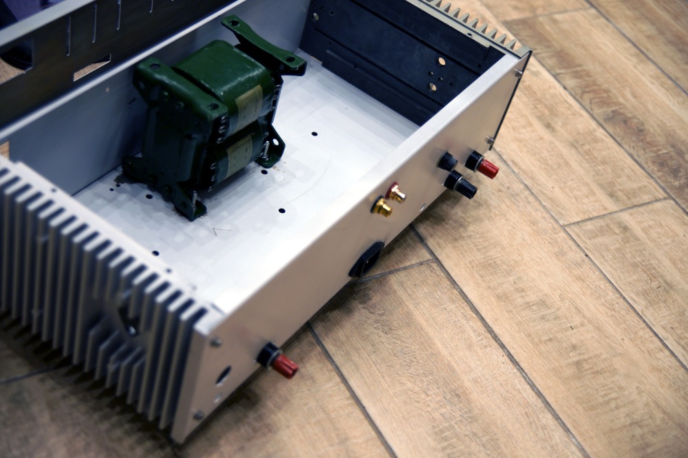

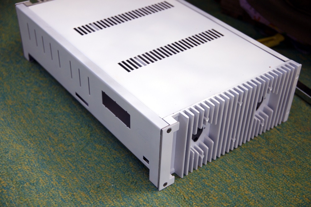

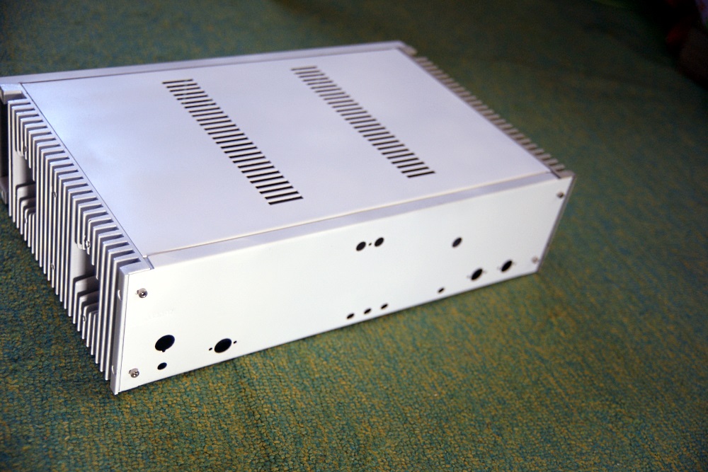

My reduced AB 100 to AB 60 is slowly being processed- still have to make PCB and wait for the parts to be delivered...

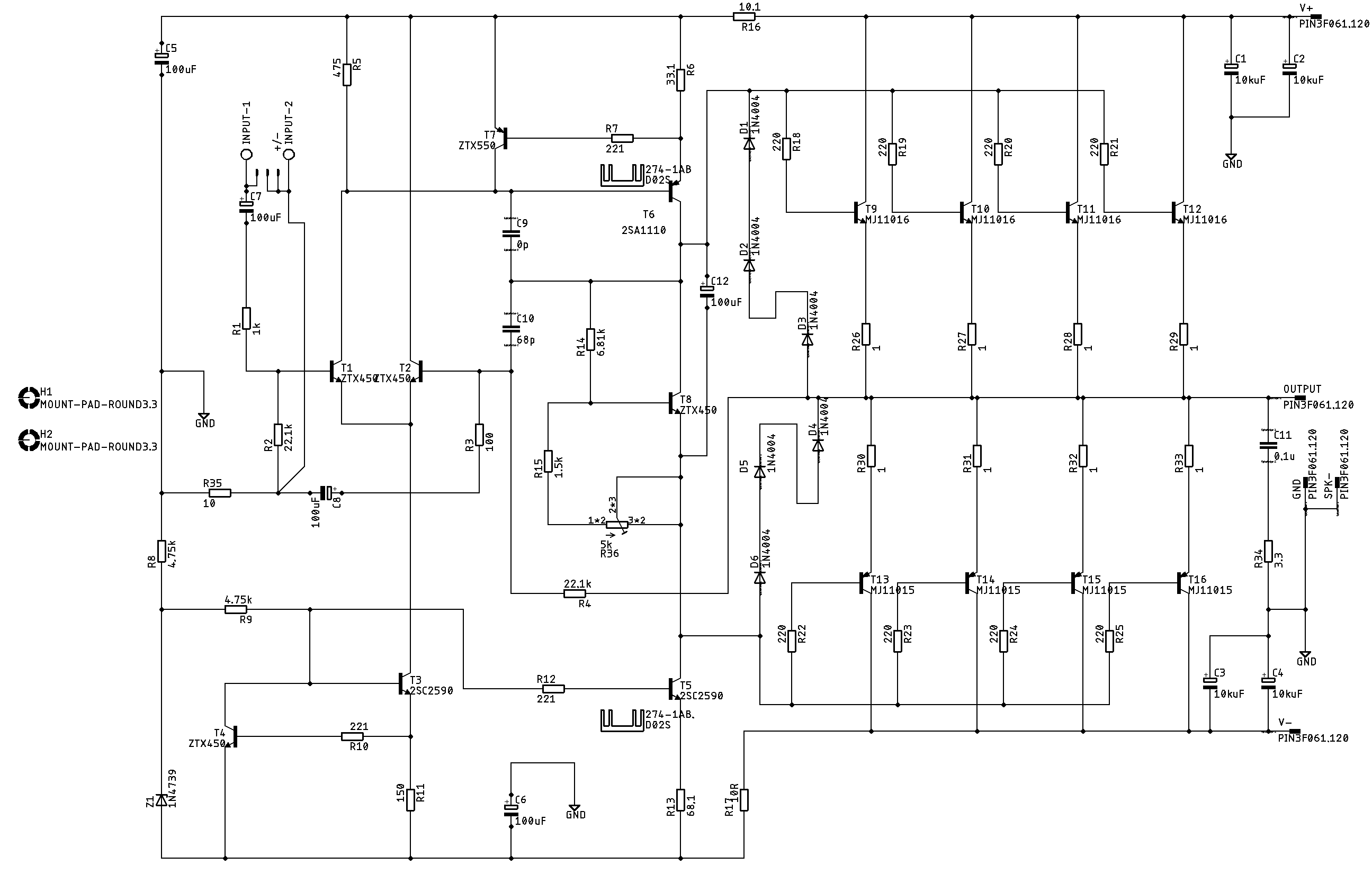

If you're referring R35 it's been mentioned a few times ... Consensus seems to be it's not necessary. Although I didn't see Mr. Pass chip in.
Hello uber,
I was wondering if something like this can be done, with R35 being used to lift input ground, R2 ground and NFB cap ground by 10 ohm resistor from the PSU ground.
regards
Prasi
The one and only
Joined 2001
Yes, you can do that.
Usually the idea is to break a ground loop in an two channel amplifier having
common input ground. Magnetic fields inside the amp and outside can cause
current to circulate from one channel ground back to the source and then
back to the amp via the other channel's cable ground and ultimately causing
noise pick up. If you break one channels input ground connection and replace
it with a 10 ohm or so resistor, you can break that loop.
Doesn't always work, but easy enough to try.
:cheers:

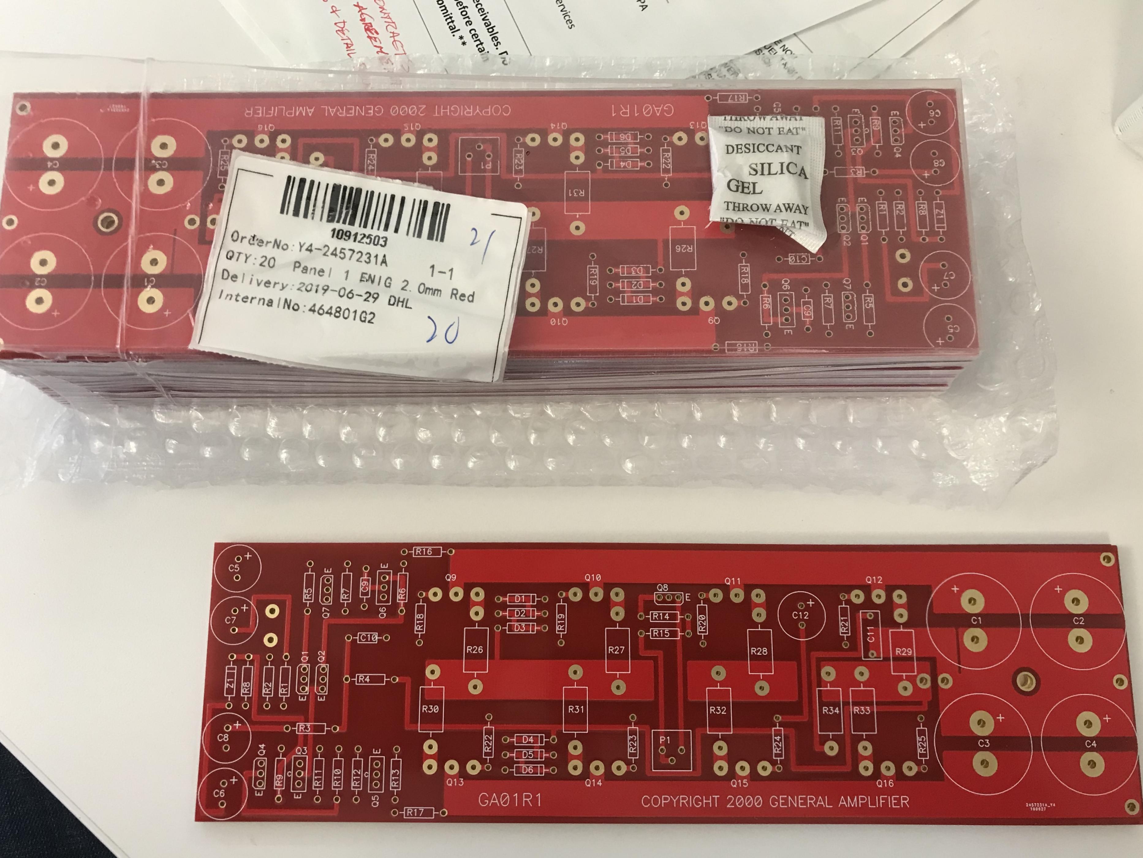

Boards came in a day early! DHL from Shenzhen is amazing! They turned out fantastic. Each boards weighs 2.75oz. This was a heavy package. I have one pair of boards left. If anyone is interested, PM me.
