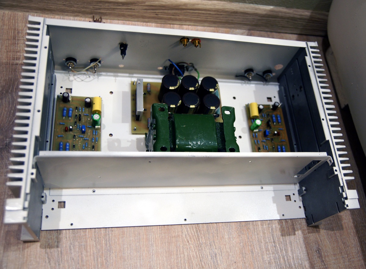

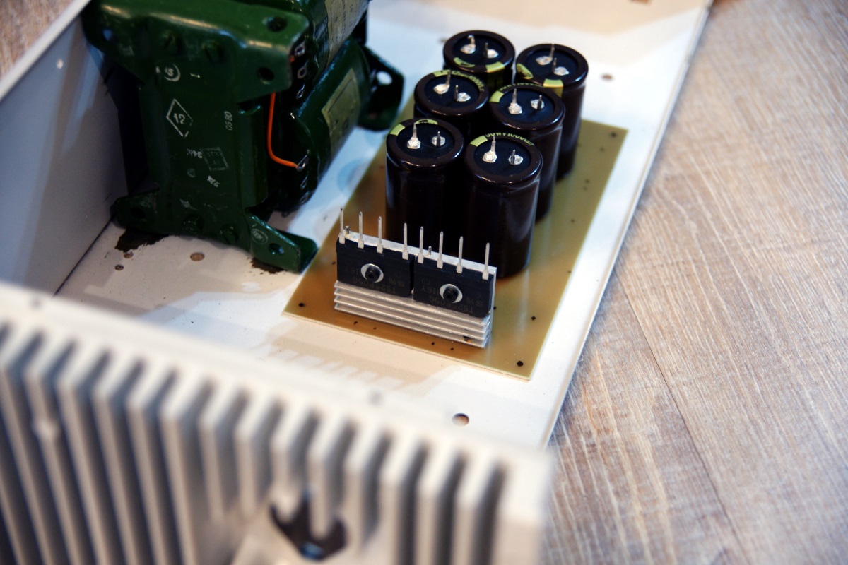

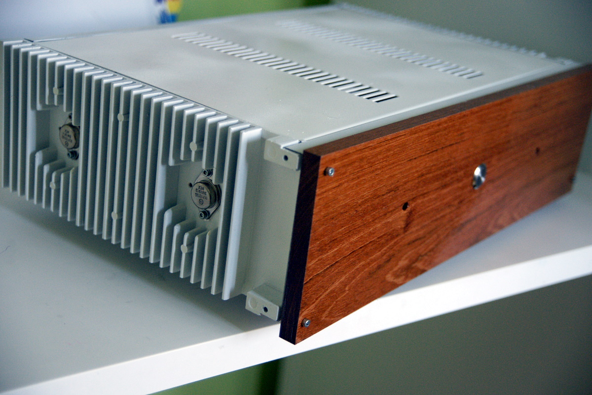

I've gathered most of the parts for my reduced version of AB100 (only ztx 450 and output transistors still waiting) I will use for VA BD 139/140 and maybe also a multiplier transistor will be BD - because it is easier to attach them to heat-sink. PSU will be double bridge ( for some extra voltage drop - and i like double bridge config). 30 000uf per rail. Snuberr cap + resistor will be soldered on transformer pads. I think i will get some 35- 36 VDC per rail from 26,26 VAC. It will be fine for BD as VA and for one pair of 250W MJ 10115/10116 darlingtons IMHO.

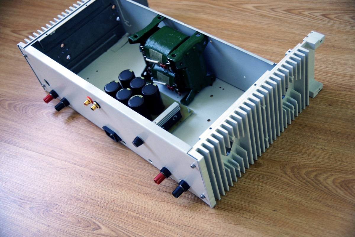

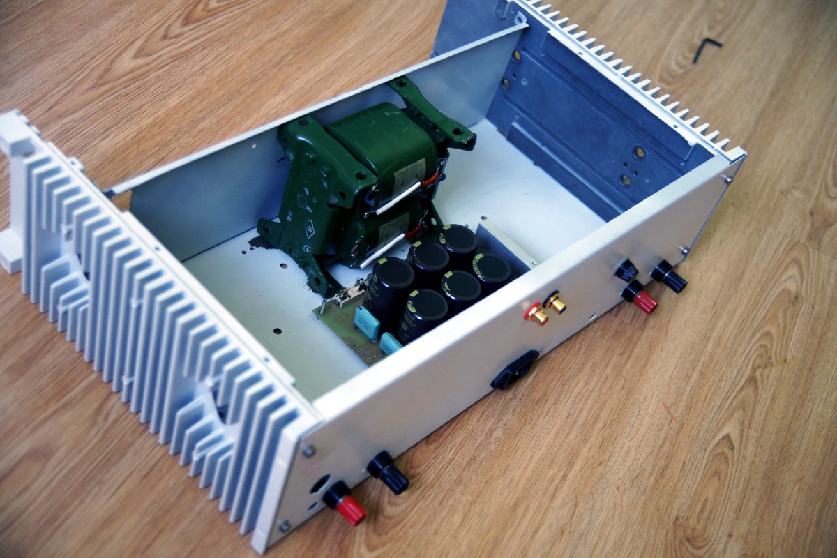

this time I try to use the salvaged parts ( transformer, enclosure, binding posts etc) .. some kind of eco friendly build :D
Semiconductors and other parts will be new ones - vishay resistors, ER will be two 0R47 in parallel, input cap - poly 3,3 uf, feedback cap - green muse bipolar.
Power supply unit tested - it outputs healthy + /- 37V...
It will be necessary to re-paint the scratched surfaces - maybe I'll paint it too early,,,:D I try to use the existing holes in the enclosure as much as possible.

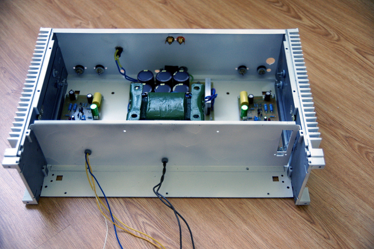

everything done - only transistors left to solder - delivery of heat-sinks is delayed, i do not want to solder transistors without them - i can miss the right height ..

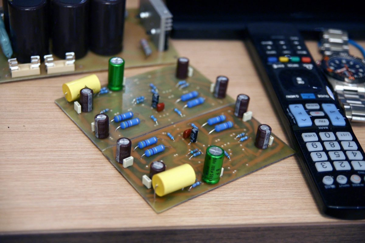

Very slow progress for me ... still waiting for LED indicators, rubber feet .... Main wires tightened- transistors screwed. Wood panel finished.
P.s. first seen ON semi BD 139/140 all-plastic housings with insulated colector.
