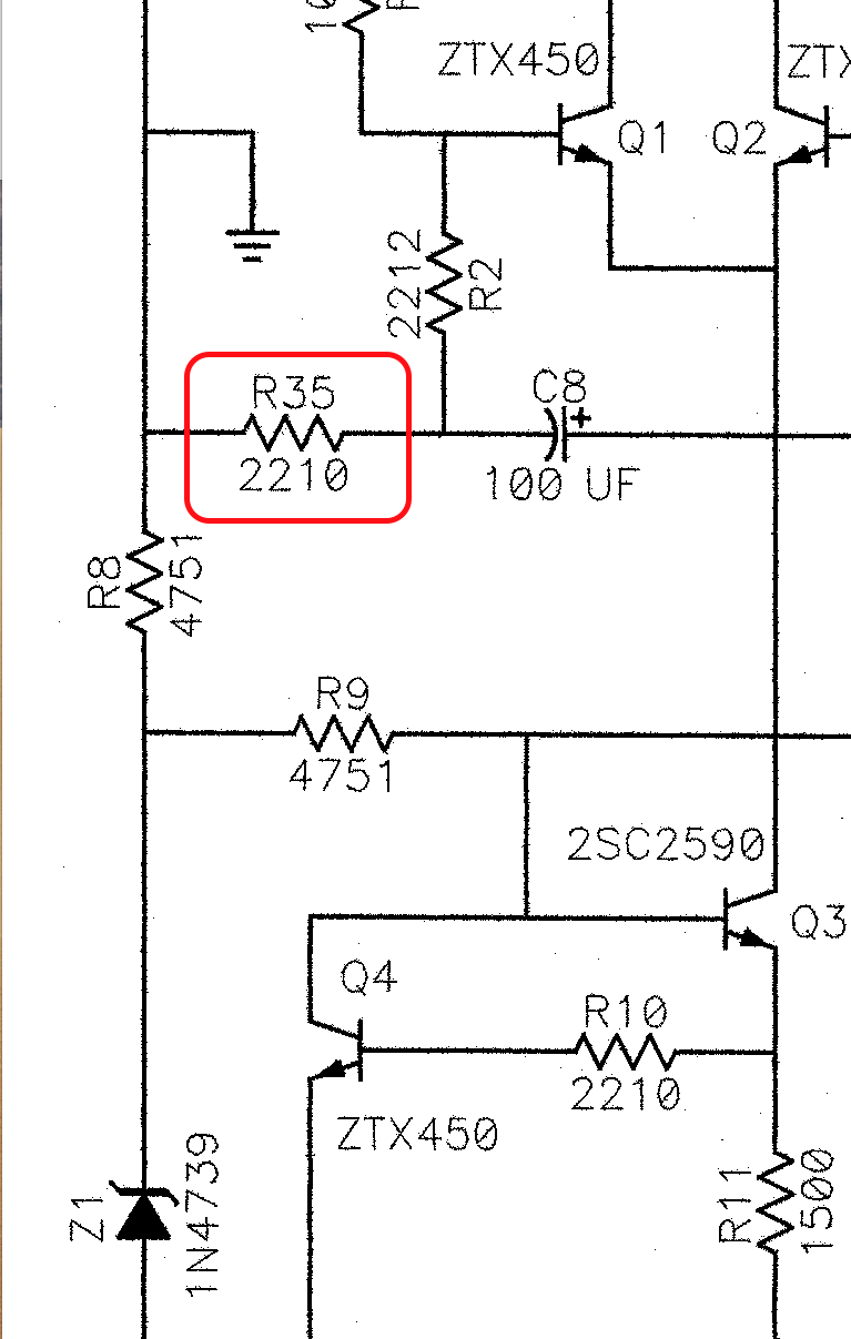

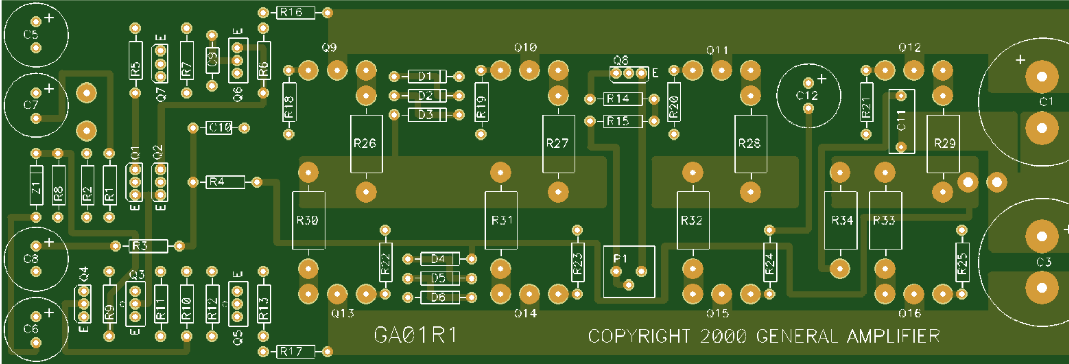

@ZM,
in schem is a R35 but not on the board.

if Papa omitted it , who cares 🙂
I can bet that reason for having it in first place , was much more hilarious than reason for letting it out later
(That's "just" 220R in series with 22K , being connected to voltage reference ; so , 1% isn't much to be left out ; on the other side 220R is much compared with also series R3 (1K) , but 1K is already low in value so no practical difference between 1K vs 1K+220R ; who knows - maybe Papa put it in first place while laying out pcb - to jump across some trace , instead of jumper)
R35 is (was) a bootstrap resistor whose purpose is to increase the amplifier's input impedance.
Which may not be necessary if the person to whom you sold the amp board, drives it from the wiper of a volume control pot, as the links in Nelson Pass's post #530 indicate.
