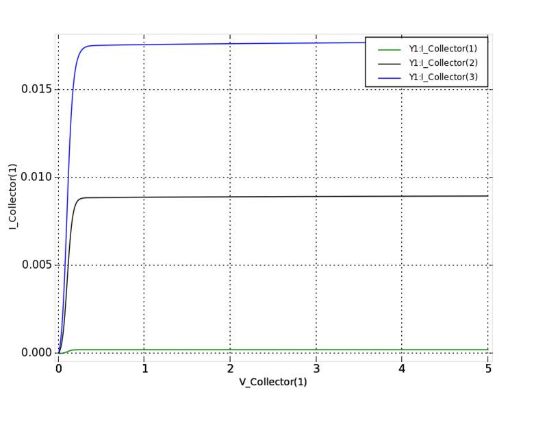

What would "excellent" mean in this case?
First, the much-used KSC3503E. At 15mA Ice, when Vce drops below 5V, Ice starts to shut off. This would be the opposite of excellent quasi-sat behavior in my opinion. I grappled with this recently with a VAS stage that was visibly distorting long before clipping.
Next, the TTC004B. At almost 20mA Ice, the Vce where the transistor starts to shut off is less than 0.5V. This would be excellent quasi sat behavior.

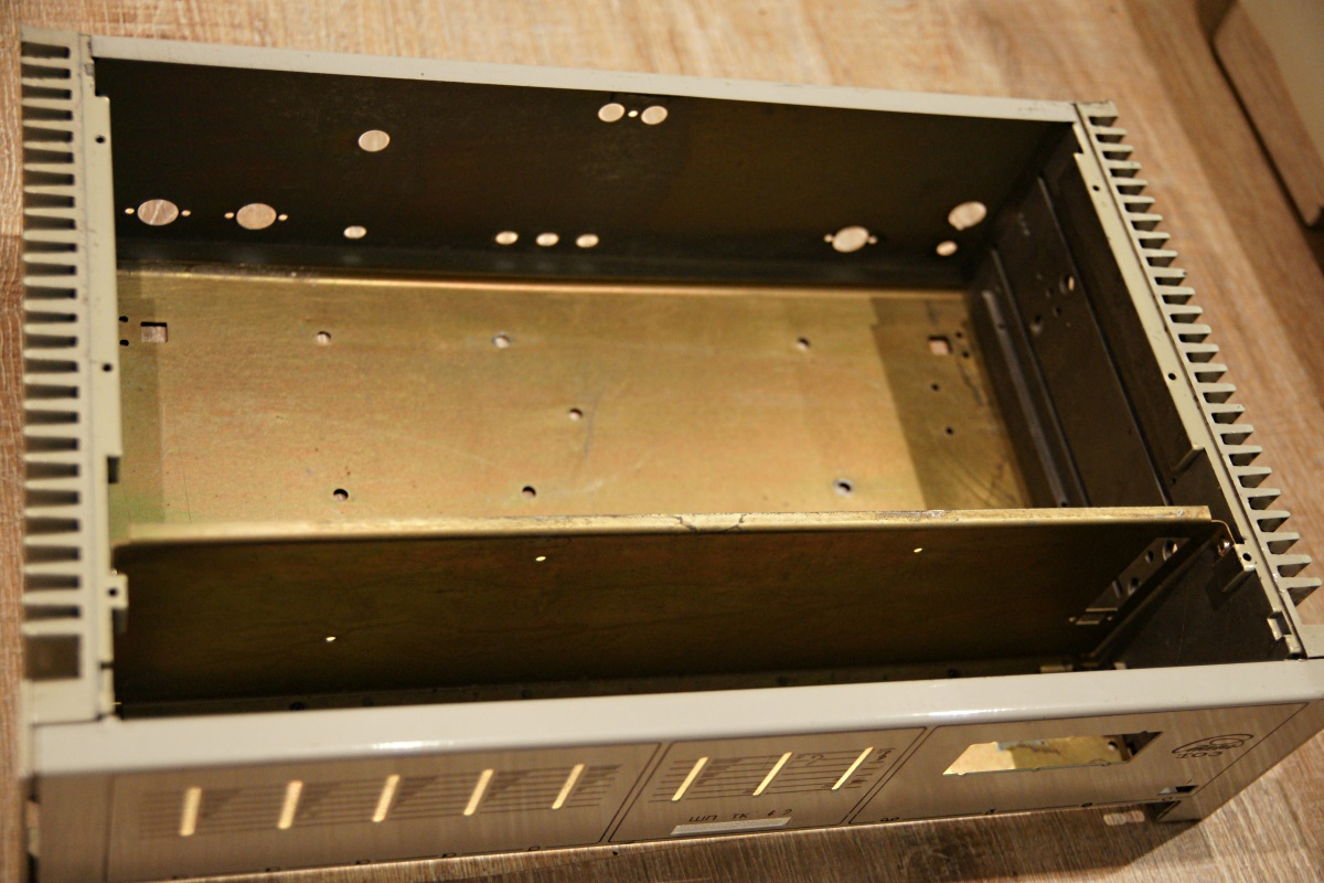

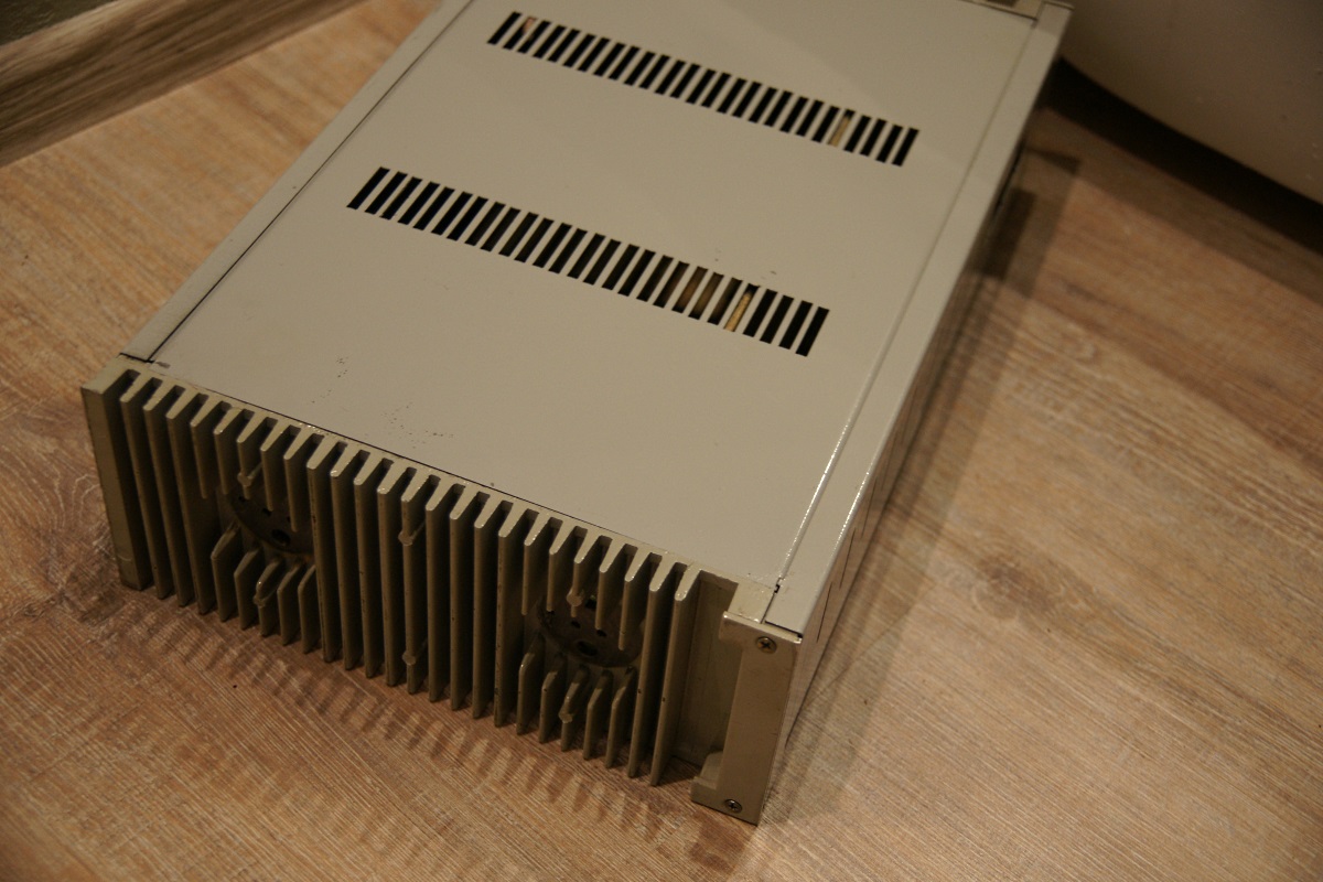

A few days ago I got such a nice "donor" , each side heat-sink to-3 pre-drilled, but only for one pair.
think I could get in there smaller AB100 - let's call it AB 60 as ZM suggested 😀.
I will have to paint it white and make a new aluminum or wooden front panel.

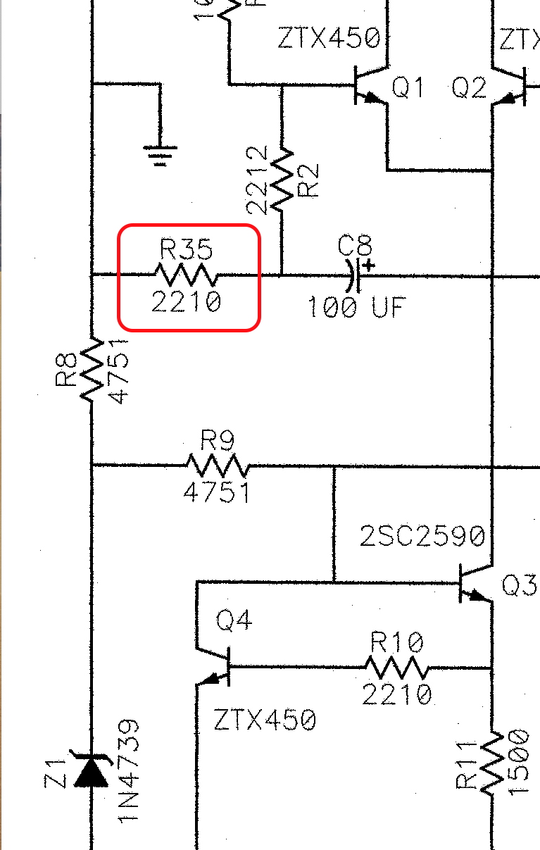

where is R35 on your boards

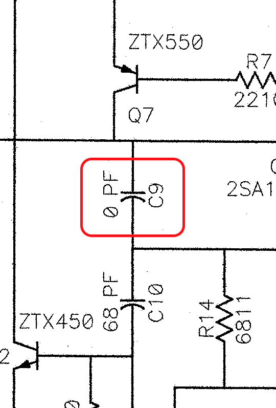

C9=0pF - what means that?
means 2210=221R / 4751=4k75R

C9=0pF is a synonym for DNI. Do Not Insert.
It means that there is a "footprint" for C9 on the PCBoard layout, but your assembly technician is told not to stuff or solder any component in that footprint. The amount of capacitance we want in this position is: zero. No capacitor at all.
One reason you might put this in your design is: for future flexibility. If, God forbid, WhizBang Semiconductor stops making the BL74JSK device, or if they accidentally let their inventory pipeline go empty*, you have a plan. You'll buy the almost-as-good M44D74GN from ErsatzPLC, and compensate for its imperfections by stuffing an 8.2pF capacitor in position C9. This reduces the amplifier bandwidth by 15% but you're still in production. Now instead of ±0.25dB from 2 Hz to 110 kHz, the modified amp is "only" ±0.25dB 2 Hz to 93 kHz. Still quite listenable.

Hello Mark (hope it ok),
thanks for your answer for C9!
Sorry, my english is not the best ... what I understand is: flexibility and if C9=8.2pF then is the bandwidth "only" ±0.25dB 2 Hz to 93 kHz.
There is only one person who knows exactly why Nelson Pass included C9 in his PCB layout, and that person is not me.
I offered a hypothetical scenario including fake names of semiconductor companies, nonexistent part numbers, and completely bogus bandwidth specifications, to illustrate one possible reason why someone MIGHT include C9. It was a hypothetical scenario. A work of fiction. A story from the land of make-believe.
The good news is: you don't need to know why there is a footprint for C9 on the PCB. Just be sure not to stuff and solder anything there, and live a happy life.
