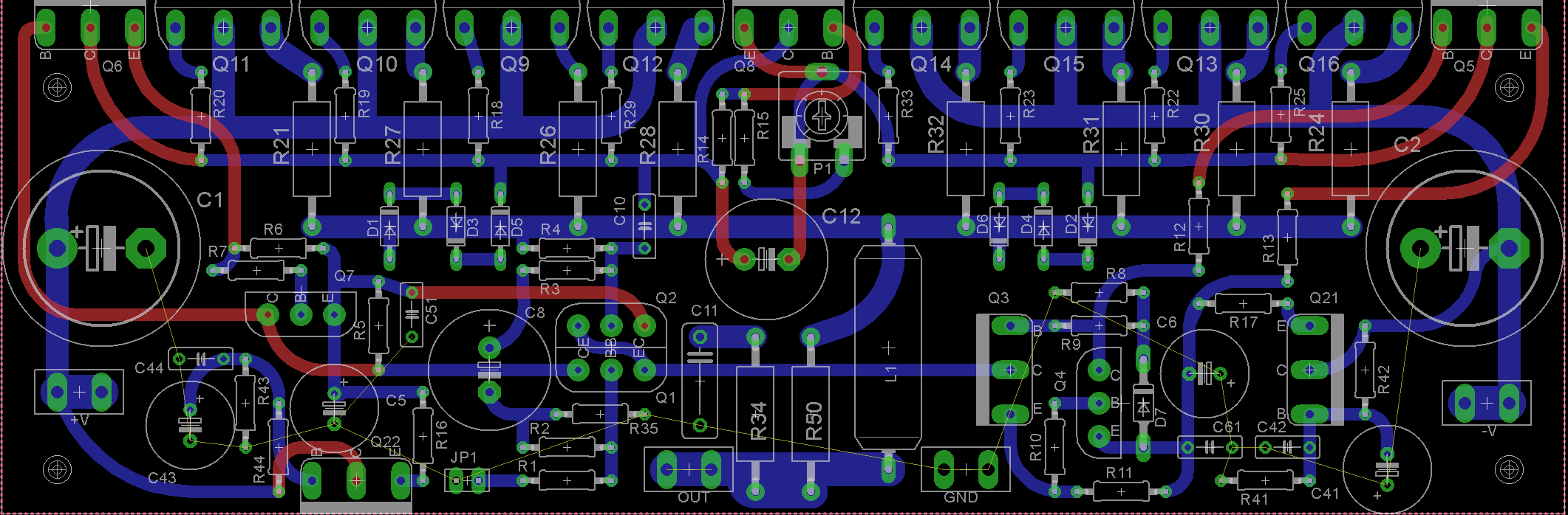

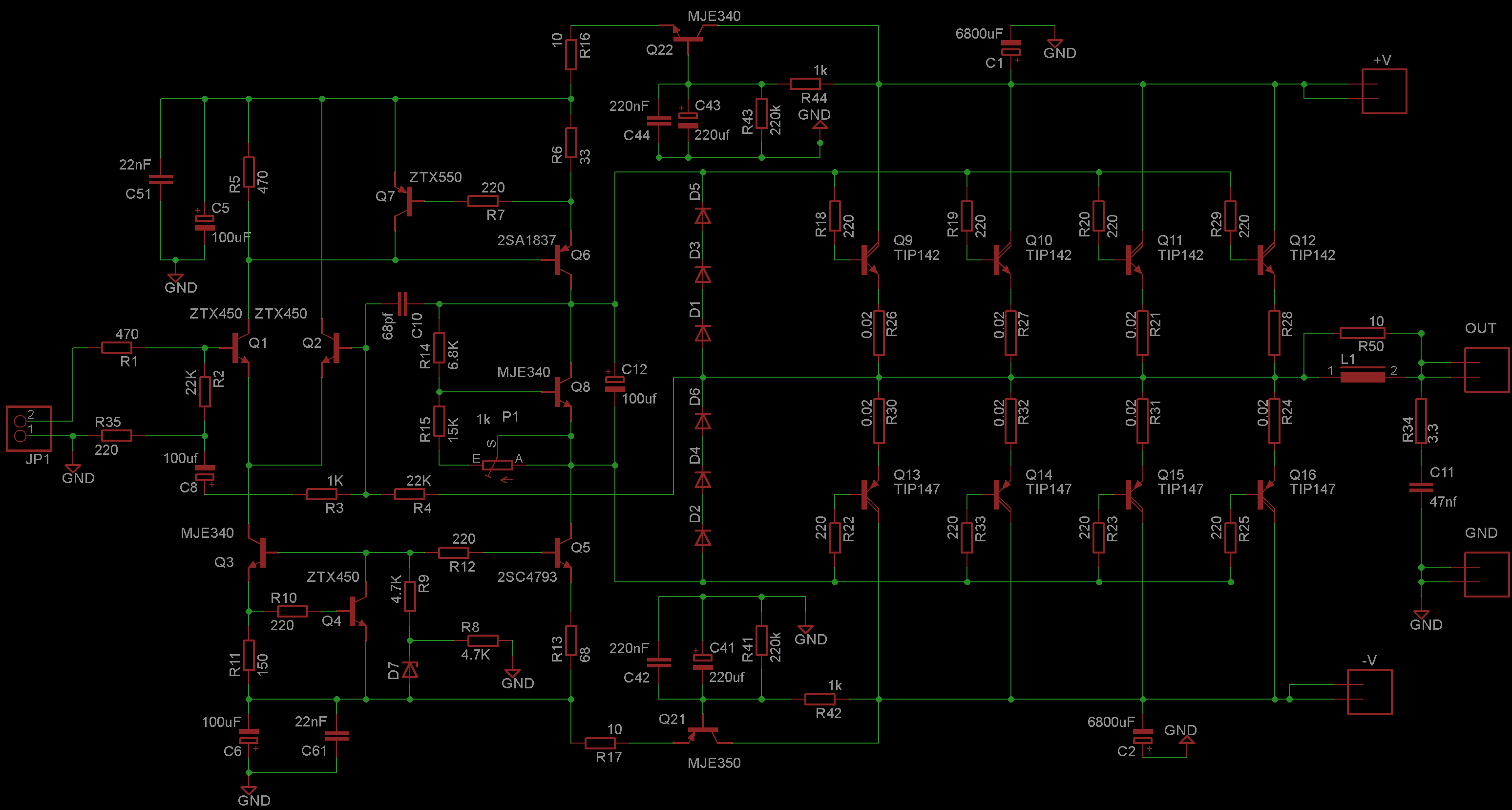

Managed to tidy up my schematic: i have made a few modifications in this version (removed fuses as i have them on PSU now). attached boards and schematic including gerbers. I will be buying a bunch of these next month so let me know if anyone is interested.

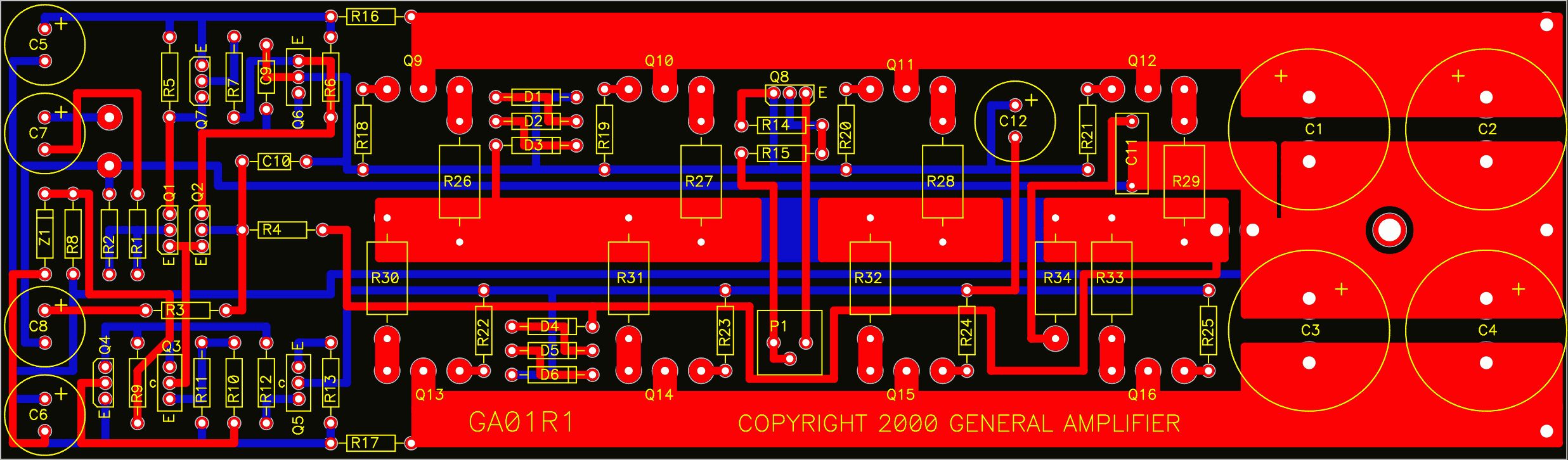

I suggest that you beef up the traces for the collectors of the output transistors the way that Nelson's layout is done, as attached.

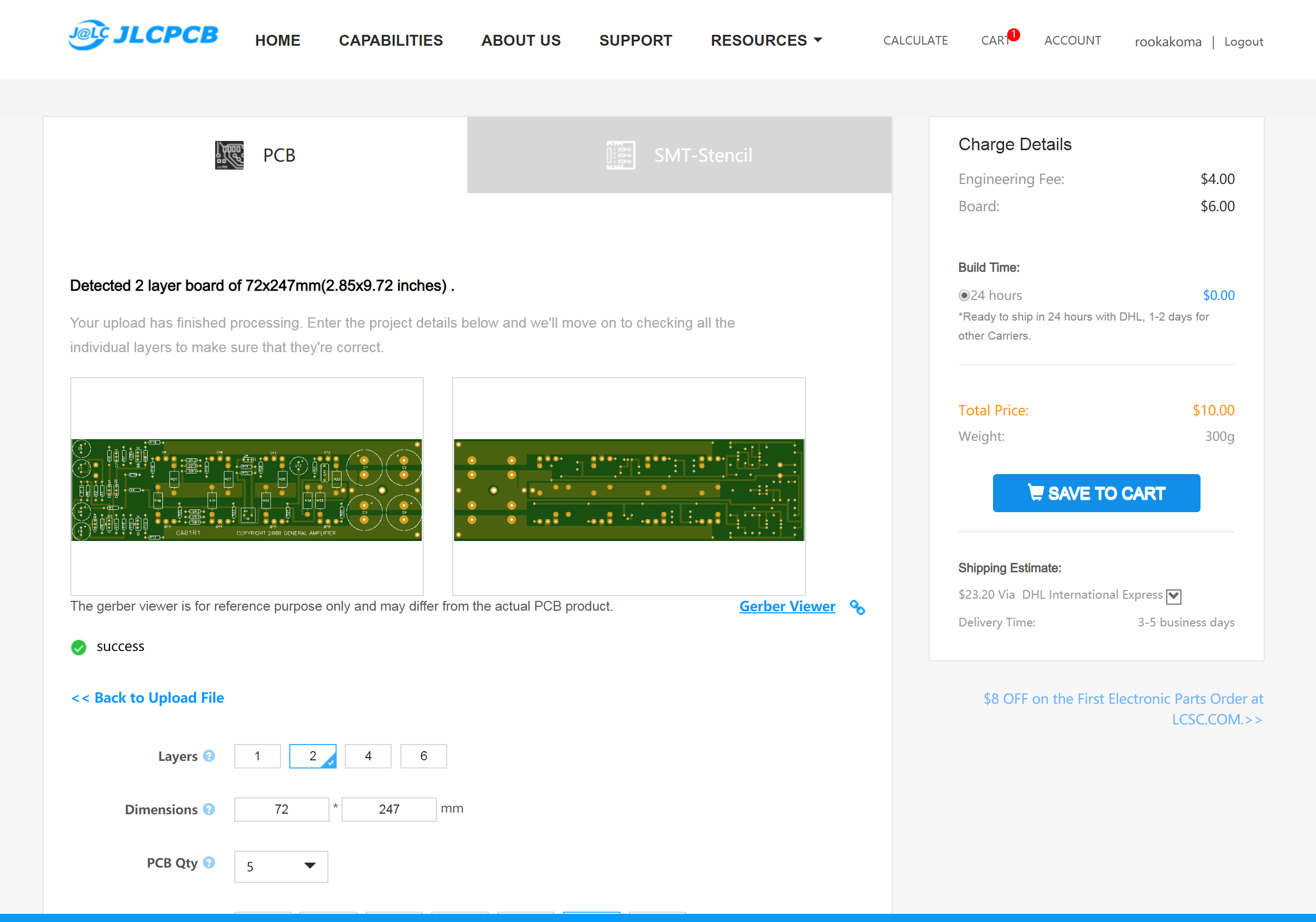

Not to step on toes, but here are my files.
Board is 2.85" x 9.725" and the Gerbers are in the format that pcbway.com
seems to be happy with.
I recommend the jlcpcb, which is cheaper than pcbway.
The quality is really good, we used it regularly for production at Norma Instruments. 5 boards is 10 USD+ shipping, which is 25 USD whith DHL.
They are very fast and professional.

Dear mr Pass (Papa),
first thanks for all your effort for the diy community and also thanks for the files!
I ordered today 10 Boards and i will send to others diy friends here for postage and a little fees (like for an padded envelope, if there will be customs charge the i share it on the 10 boards, it is Germany and here nobody knows how the customs "ticks" ;-) ).
