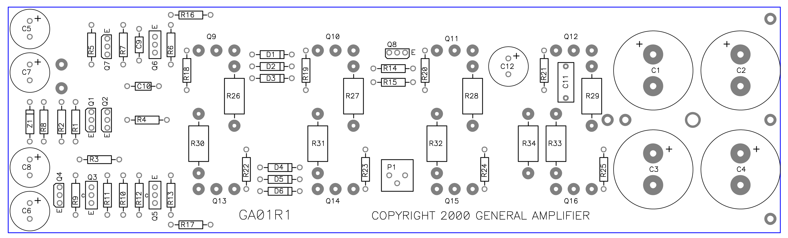

I don't know if the PCB is ok or if corrections are needed.

Thanks Jim, are gerbers available anywhere or do we need to make it ourselves.

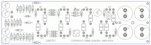

I have no problem sharing mine if its of interest. I also have spare PCB's but posting them internationally will be cost inhibitive. Let me tidy up the schematic and board layout and i'll upload them.
Not to step on toes, but here are my files.
Board is 2.85" x 9.725" and the Gerbers are in the format that pcbway.com
seems to be happy with.

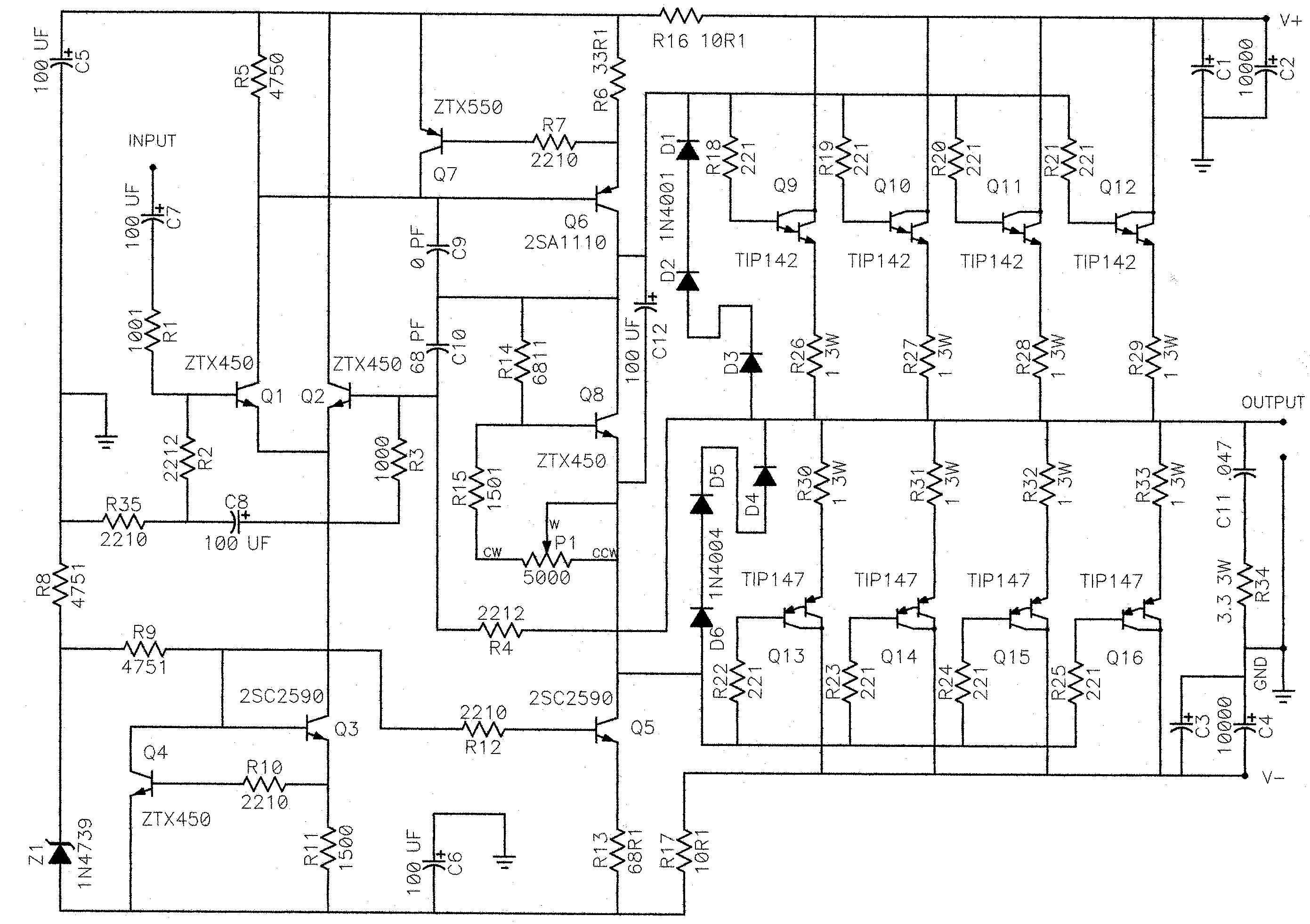

I do have a question Nelson regarding Q3; is there a particular reason why the 2SC2590 is used in this place? Why not just use a ZTX450? I suspect it may be the higher voltage capability of the 2SC2590.
Unfortunately i do not have any 2SA1110/2SC2590 hence I've been trying different transistors in the IPS and VAS to hear any differences. The 2SA1837/2SC4793 in the VAS is sounding better than the MJE340/350. I have also used a 2N6517 in Q3's place.
Thanks Papa, also please share the schematic of the same
It's not a very special transistor, but the ZTX450 is probably not adequate
from a dissipation standpoint.

Here's the schematic again.

If it get noisy, you can reduce R8 to 3.3K, but probably not needed.
And lower rails gives opportunity for higher OS bias.
Nelson, Many Thanks for the reply.
I was thinking exactly like this, to reduce the rails to +/-25 to 30 Volts, to use only 2 pairs of output transistors per channel and to increase the bias to 150 mA or so per transistor.

Do I need to look for any current replacements from your schematic of the mosfets and transistors? Or should I go with the rated ones as per your schematic.
thanks again.
There are only bipolar transistors in that design.
For equivalents and replacements, you can take a look at the links
I provided, and there is plenty of leeway in the selection.
