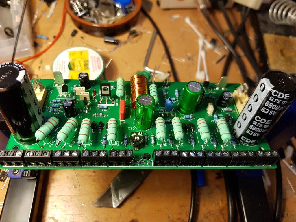

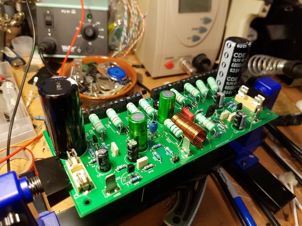

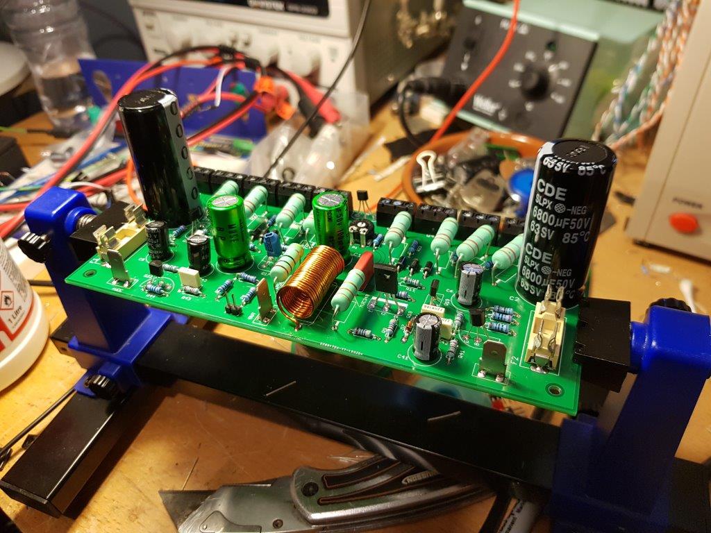

Testing my AB100 now. I'll let you know the outcome 😀

Is the air coil also in the original schematic?
We never see that in class A designs?
Is it at the output? ….for stability reasons?
Is the air coil also in the original schematic? No i added it.
We never see that in class A designs? This is a class AB amp.
Is it at the output? ….for stability reasons? Yes in parallel with resistor. Provides stability when the amplifier is loaded with capacitive loads. See D.Self's ISBN 978-0-240-52613-3 book for a comprehensive explanation.
Thank you! I have ordered the book.
I know it is a class AB design. I have wondered why such a choke is never used in the Pass class A designs we see most of in this forum. I assume it is an advantage of class A that the higher bias makes the amp more stable in capacitive loads. I can probably read more about this when I get the book! …..the paperback version!
In cheaper class AB amps….I think the choke is always there…..as I remember from looking inside.
