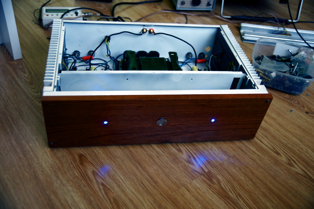

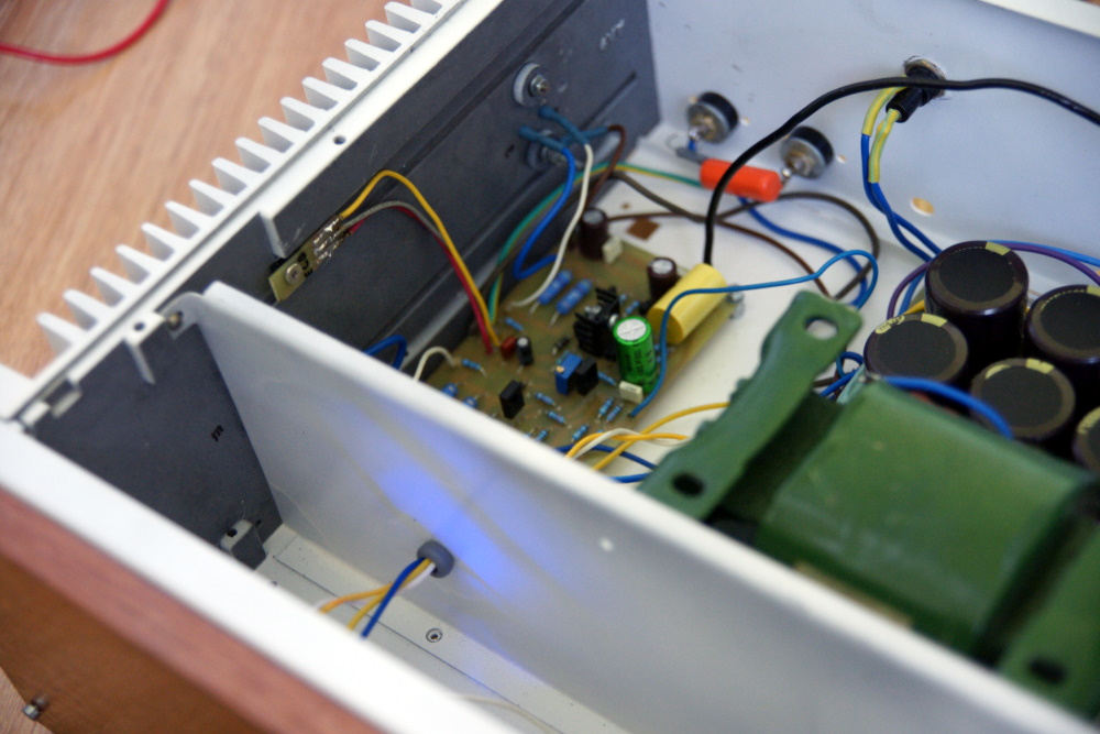

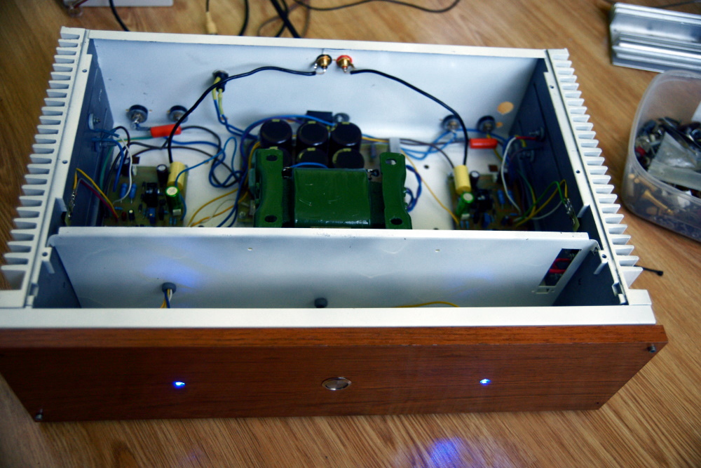

Hi, thanks for the suggestion..but i never use them ... in this case the heatsink is painted and the transistors are far away..i like the look of naked to-3 .I know the safety instructions - but there is not that much voltage.
My second AB 100 ( ok AB 60 ) already singing..I made fast measurements:
95W @ 4 ohm (depends on actual mains voltage) ; 56W @ 8 ohms.
Bias -100mA per transistor. Noise level with shorted inputs -0.04mV and 0,3mV with open input.
DC offset - 9mV on both channels (i matched input ZTX with mulltimeter)
Wiring have yet to be sorted out - I still waiting missing panel mount LEDs...

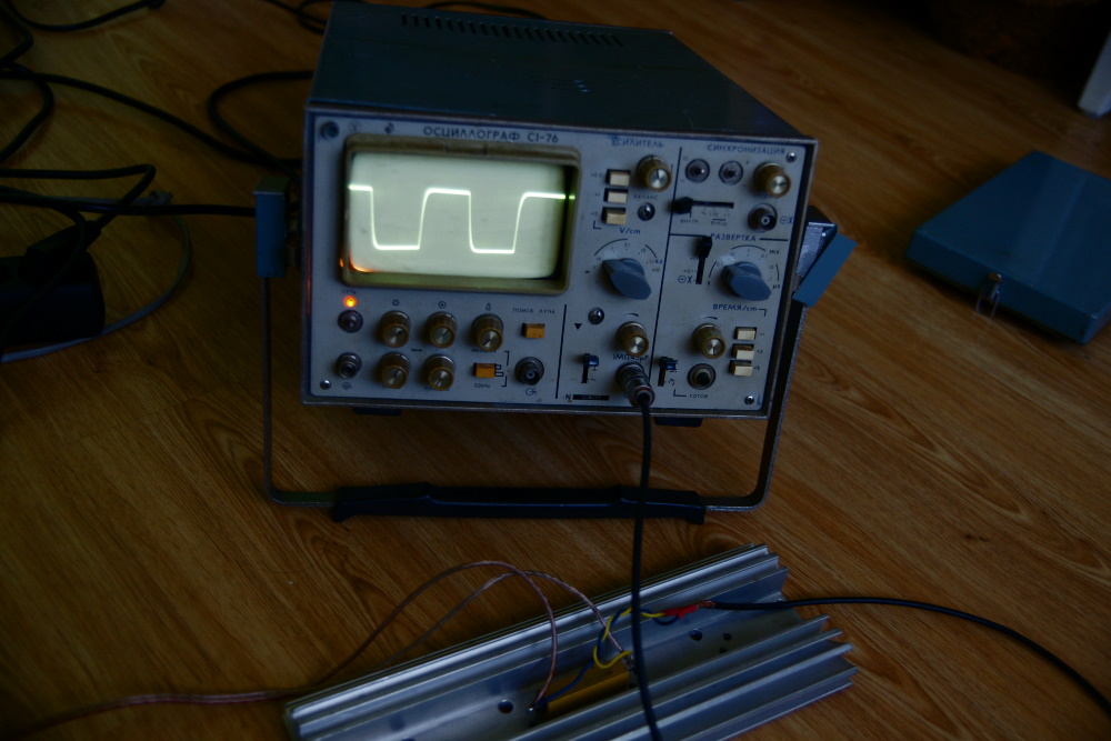

accidentally running 100Khz at full output- wonder why there is no clipping but 2H distortion at MAX input.. then I realized my mistake - the heatsink was hot and the transformer started to sing - but the amplifier survived @4 ohm.
Sounds like previous amp - bass is descent!
20Khz square wave picture attached.
MY amp differences from original:
input cap - 3.3 UF poly
Feedback cap 100 uf muse bipolar
capacitor instead of 68pf - 47pf mica (because I had them)
RE - 0,235R
bias generator - BD139 and 5K bias pot

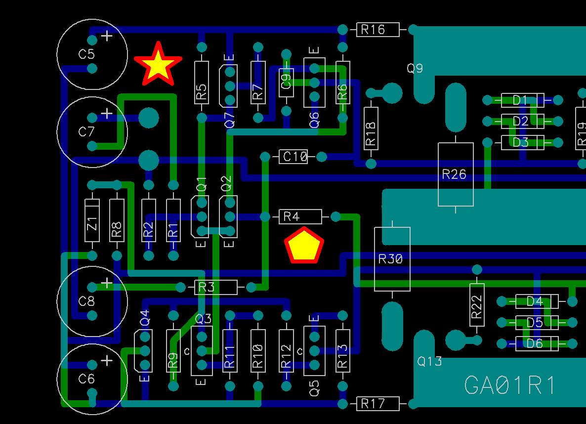

There are a couple blank regions on the board, where it has no top copper, no bottom copper, and no component bodies. Two of them are marked in yellow, below.
You could drill a hole through the board, in one or both of these locations, creating places where attachment bolts can be affixed. If you're clever about the diameter and clearance of these holes, you probably can use standard metal (electrically conductive) bolts and nuts and washers, without shorting the heatsink to any copper traces on the PCB.
But if that frightens you, switch to nylon (electrically insulating) bolts and nuts and washers. McMaster Carr sells them at typical McMC prices. With nylon fasteners you have much greater freedom to put the holes closer to copper traces, with zero danger of short circuits. So a nylon user can probably drill many more than two extra holes.

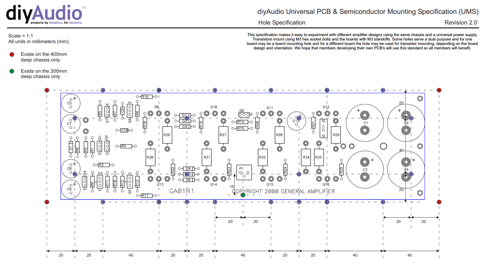

Experiment in MS paint shows Mr. Pass PCB can be mount on UMS heatsink only by solder mounted TO-247 transistors to PCB.
I mean without drilling extra holes in heatsink or pcb.
Edit:
I will add that I am not 100% sure my sizings on attached picture are correct.
Online gerber viewer measure between TIP's center leg holes shows distance about 48mm.
And for UMS it should be 40mm. So not sure PCB are for UMS..
That's what I did. Drilled in the area marked in a star at the top left. It seemed there was a bit more room there.
