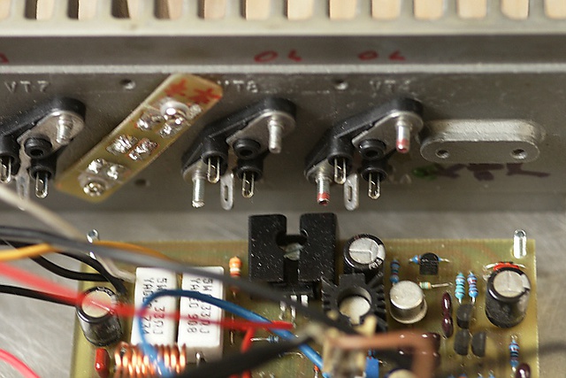

As far as build goes does the ZTX 450 at Q8 make contact with the heatsink for thermal tracking? And if so how did people achieve that? Mounting to the underside?
Does a jumper need to go into the C9 position if no cap is used
No, nothing needed.

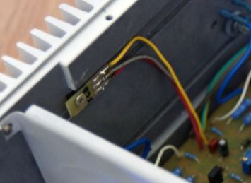

Does the Q8 transistor make contact with heatsink. How do people acheive that?
Maybe on original PCB Q8 can be soldered on the other side of PCB at the correct height so that it touches the heat-sink ?
In my boards i use a small diy pcb which i screw on the heatsink (Please find attached pics - this principle can be applied to small bias transistors) .I've also seen factory made transistor holders, but they are rare.
So I notice you are extending yours with leads. Does that present any issues? I could extend mine from leads that are a 2-3 inch long. Can that cause any instability issues? The schematic calls out a ZTX450 for Q8. What are you using? It would be nice if I could use something that would have a screw down package like TO220 or something.
No problems with extended leads/wires. In first ab100 i used ztx450, in second one i used BD 139...here is nice diy solution for mounting bracket:
