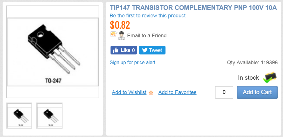

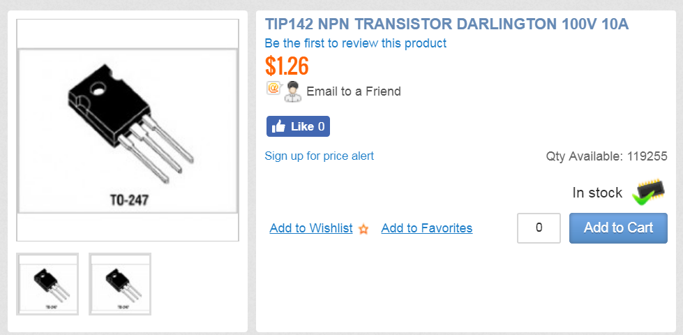

AB100 is an exercise in getting maximum watts per dollar. Its TIP142/7 output transistors are half the price of comparable Sanken devices (2SB1647) and one ninth the price of the massive, brutal 300W TO-3 devices (MJ11033). If you want to increase AB100's output by a factor of N, increase the number of TIP142/7 devices by that same factor of N. Or design a new amplifier with different goals.
