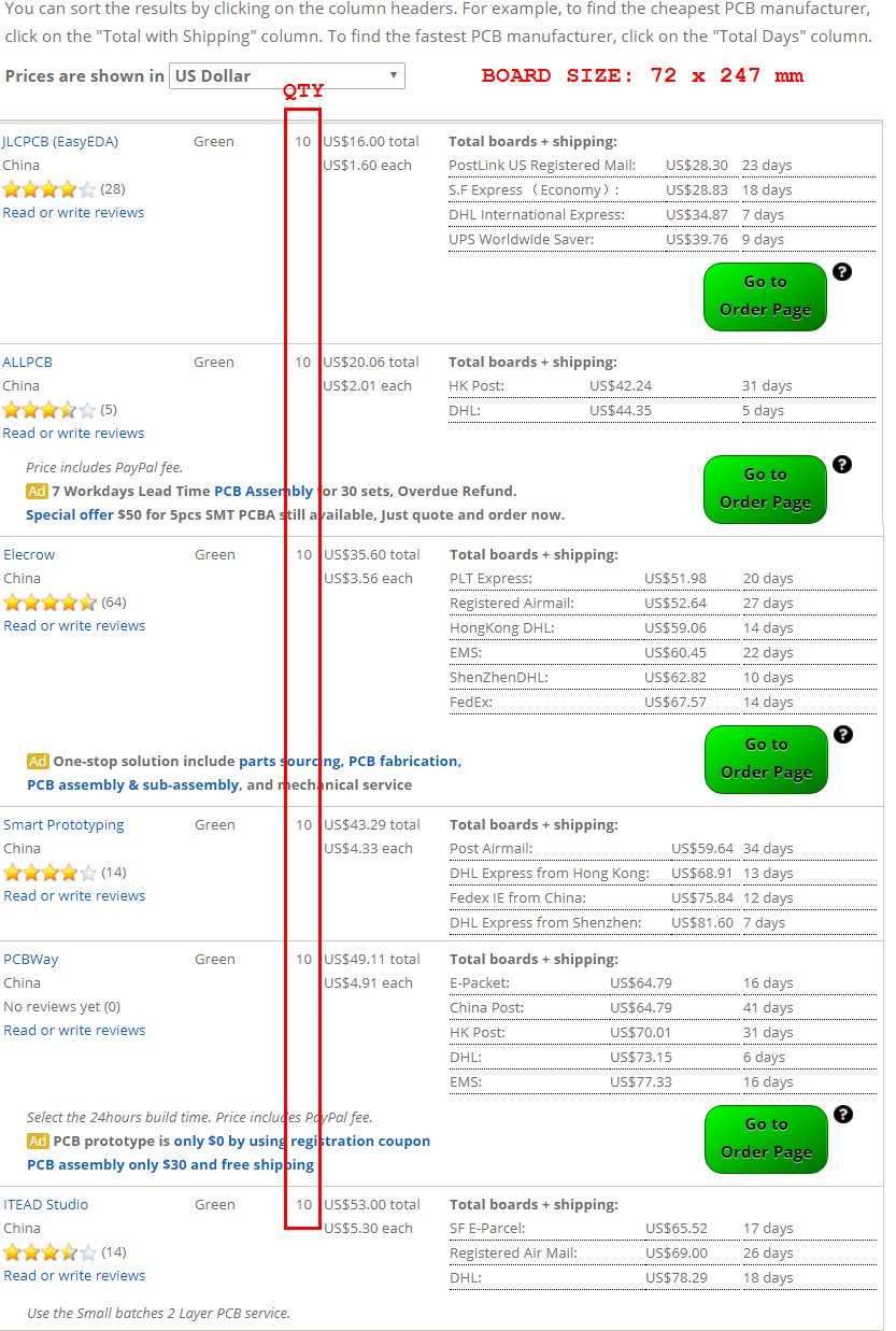

Nelson Pass posted his full and complete Gerber CAD files (the "blueprints" for a PCB) here in the thread. You could send them off to a PCB fab in China and have 10 copies made for $35 including shipping back to Kansas. Use one, sell or give away the rest.
It is possible to pay $70 to have ten AB100 boards fabbed and shipped to you. As shown in the quote below, from a website I highly recommend (pcbshopper dot com), it is also possible to pay $29 for 10 boards.
Click on the image and then click on the white "X" at bottom left, to see it full size.
