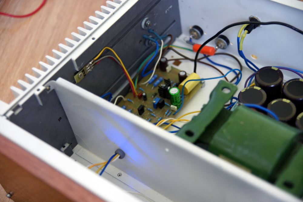

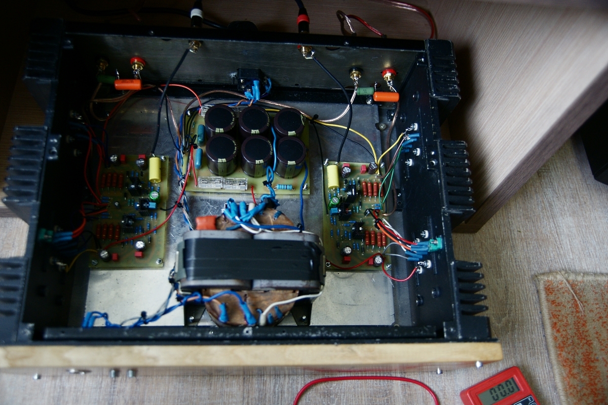

Well I've been listening to this amp for a cd's worth of music now. WOW very impressed. This thing is holographic. The first thing that it's sticking out is fantastic imaging! Maggie IIc's, Aikido Pre and Cambridge CD player. The amp is running on temp transformer. It is a 2kVA trannie so plenty stout. Dual bridges. 45 vdc rails. I have been running a HB for about 2 years now and an A40 before that. Dead quite when silent. Very Very good so far. I see a lot of people fretting over the fact that it is an AB. i'm not.
Only now I saw that you finally completed both channels -Congratulations!
I agree about the sound - very detailed and "3d sound" and very good bass.
Freecrowder - Did you build the boards using the values from the schematic, or did you change anything? I'm especially interested in the 100uF input capacitor and the 1 ohm emitter resistors on the outputs.
Freecrowder, I’m interested in RickRay’s post and what VAS transistors did you end up going with in place of the 2SA1110 and 2SC2590?
For the VAS transistors I used the MJE340/350. Emitter resistors I used .68ohm 3 Watt. The coupling cap is a nichicon audio rated electrolytic. The newer Nichis and Panasonic audio graded electrolytic sound just find from everything I'm hearing.
So I'm already thinking about the next version. I would like to push this design to around 300W/chan. I would attempt this by raising voltage to 52-56 rails. I would change outputs to T-03 package MJ11015/6 or the same ones in the A40 if available. My question would be does anyone see issues with connecting outputs with short wires from the board to trannies? The A40 is built that way actually output wires are not that short and the 40 doesn't call out base stopper resistors. Match some outputs and lower Re to around .3 Ohm
No problem with the To-3 transistors and their wires IMHO - I put the 100R base stopper directly on the base pin and 100R on the PCB. But I think we could do without it. In my amps (Mj11015 / 16) one has 0.5R (two 1R parallel) RE resistors and the other has 0.23R (two 0,47R parallel).
