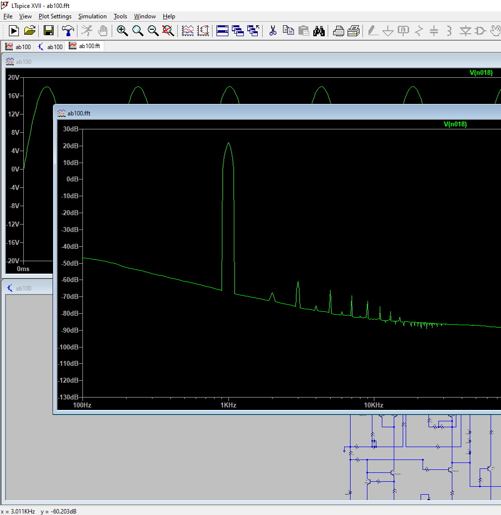

I do a little simulation:
original connection looks a bit better (2 & 3 H) - but total thd seems to be better on "alternative" connection - 0,021 vs 0,02 ( its seems little underbiased with 20mA per transistor with 0,5R in my sim with 20mA per transistor- with 0,5R its better to rise bias to 30mA per transistor - THD and harmonics will be reduced to the same level like 1R and 20mA )

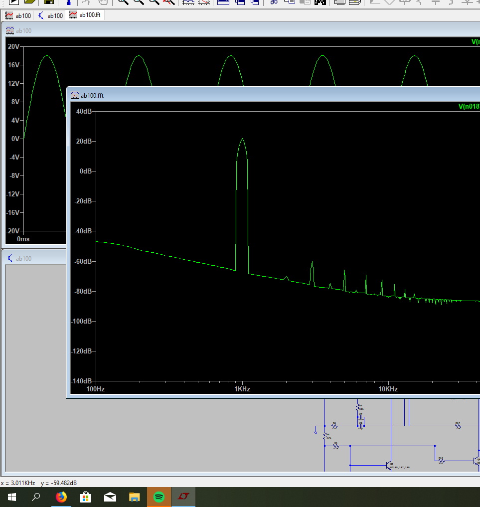

Can this amp be "converted" to a A100 by adjusting the bias to let's say 3A ?
It could be interesting to see the distortion profile between the two to see if we by measurement could see a "sound difference"?
i have simulated AB 100 with some 20-24V rails @ 2-3A - the harmonic spectrum is dominated by 3H .. 2H is not practically visible and the highest harmonics are also absent. But heat dissipation will be 120W approx, and maybe no need for 4 pairs of darlingtons. But I think this amplifier is designed for other purposes - more power at less cost and it should sound good.
