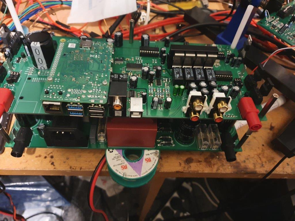

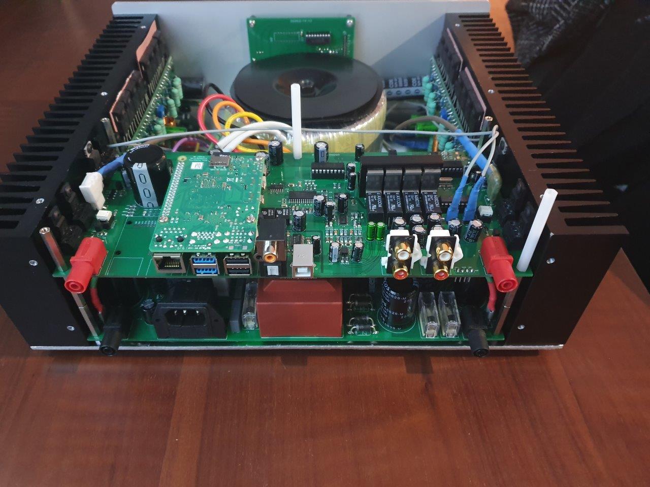

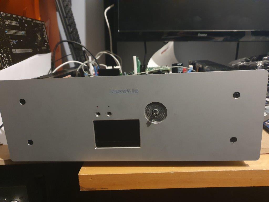

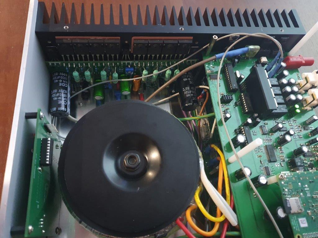

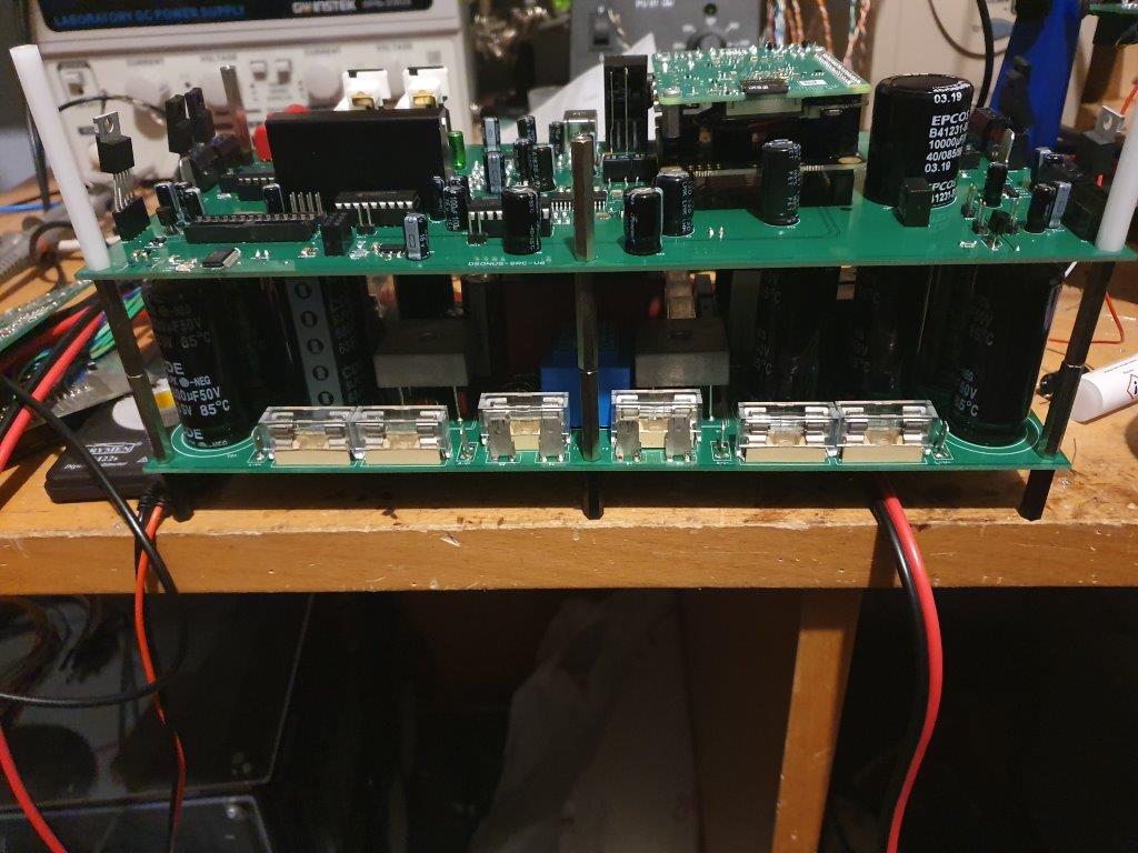

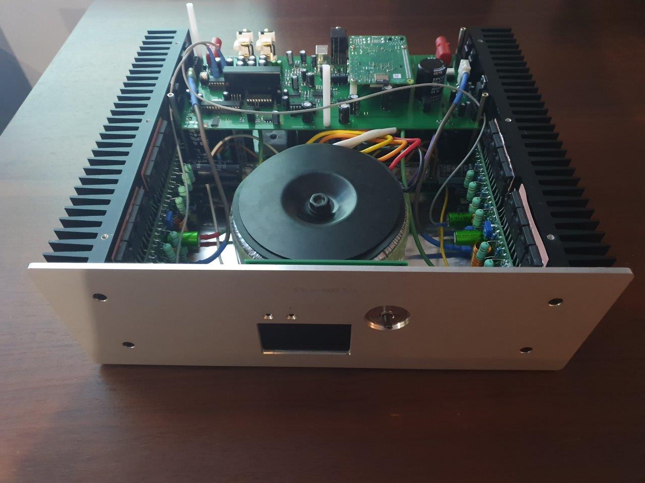

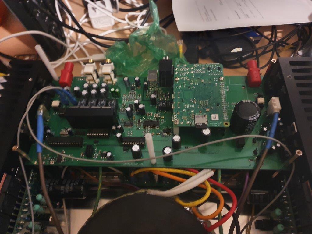

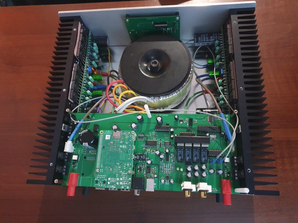

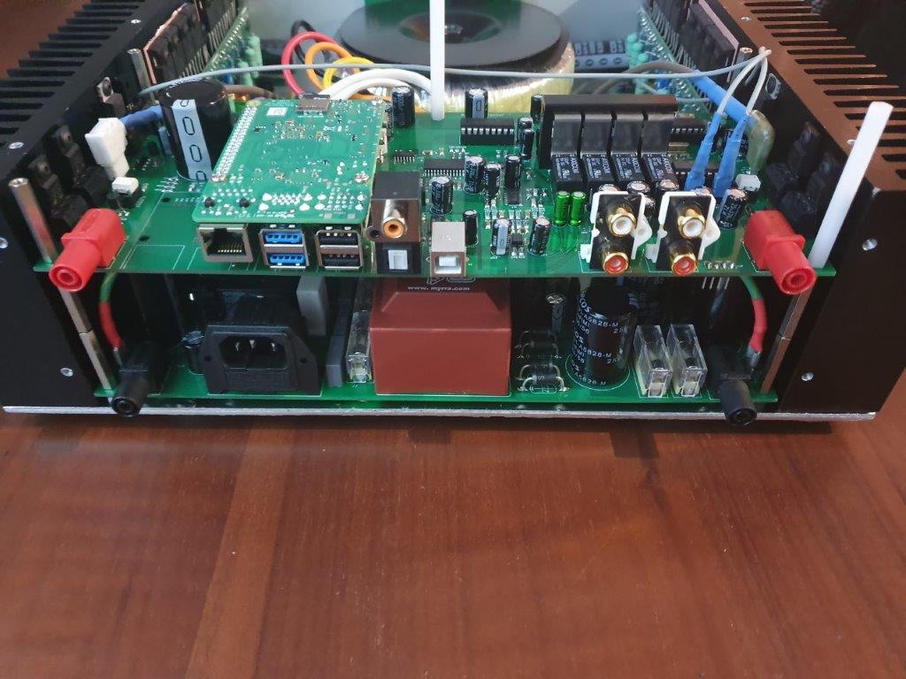

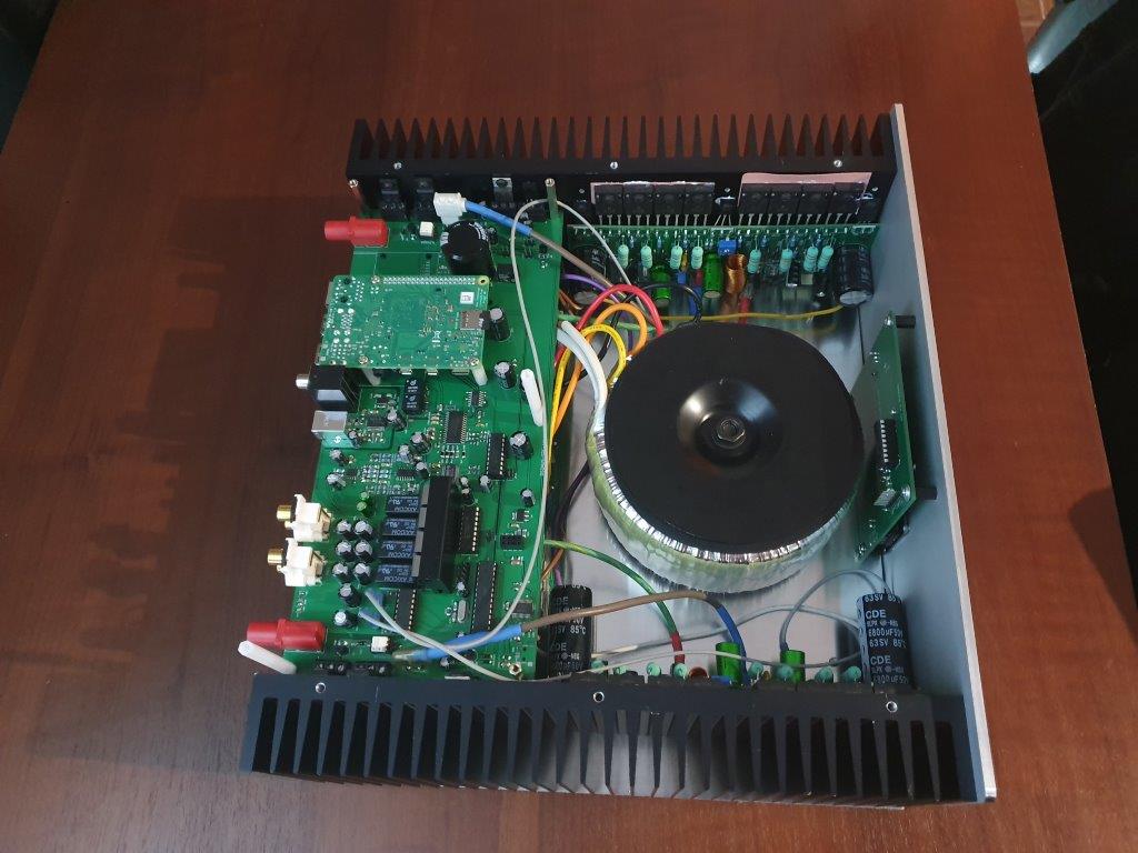

My Integrated Amp coming along

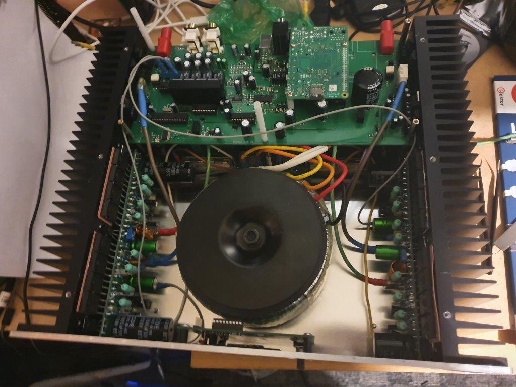

Well i ended up going down a rabbit hole, opening a few cans of worms and then came out the burrow on the other side of the planet!
At first I wanted to control the volume of my "AB100" remotely. (“” because my AB100 is a slightly modified version of NP's; this is DIY audio after all).
I then thought well it would be good to control the input to the amplifier so I can have multiple sources connected.
And then why not think about including a digital receiver and DAC……
Eighteen months later, twelve prototypes, various DACs, various IV stages amongst others and an extensive “oops” pile and I have finally agreed to a design freeze.
My integrated amplifier utilising the AB100 with volume control, LCD, DC protection, remote control, thermal protection, cooling fans, PCM1798, PCM1906, CS8416 and the option for an embedded Raspberry Pi, Up2Stream or Bluetooth module.
I’m awaiting delivery of the final PCB layouts from JLCPCB to complete the project however here is a pic of the last prototype before ordering the final PCB’s.

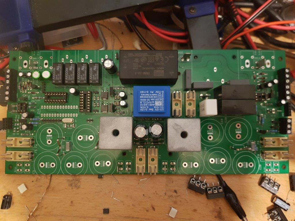

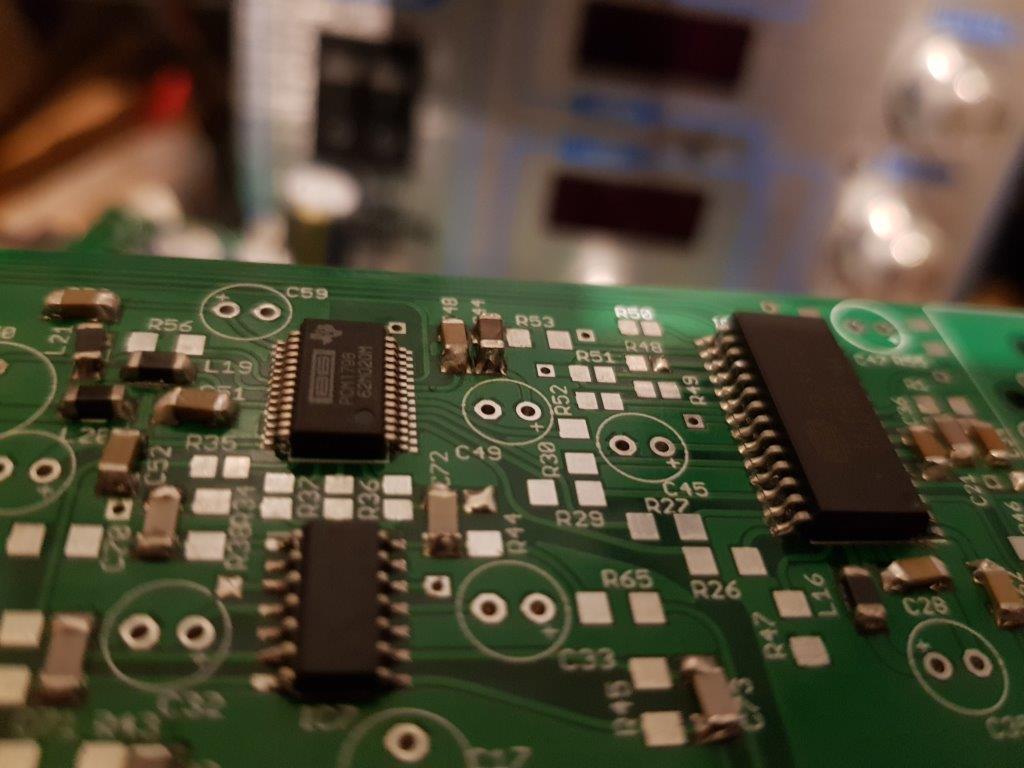

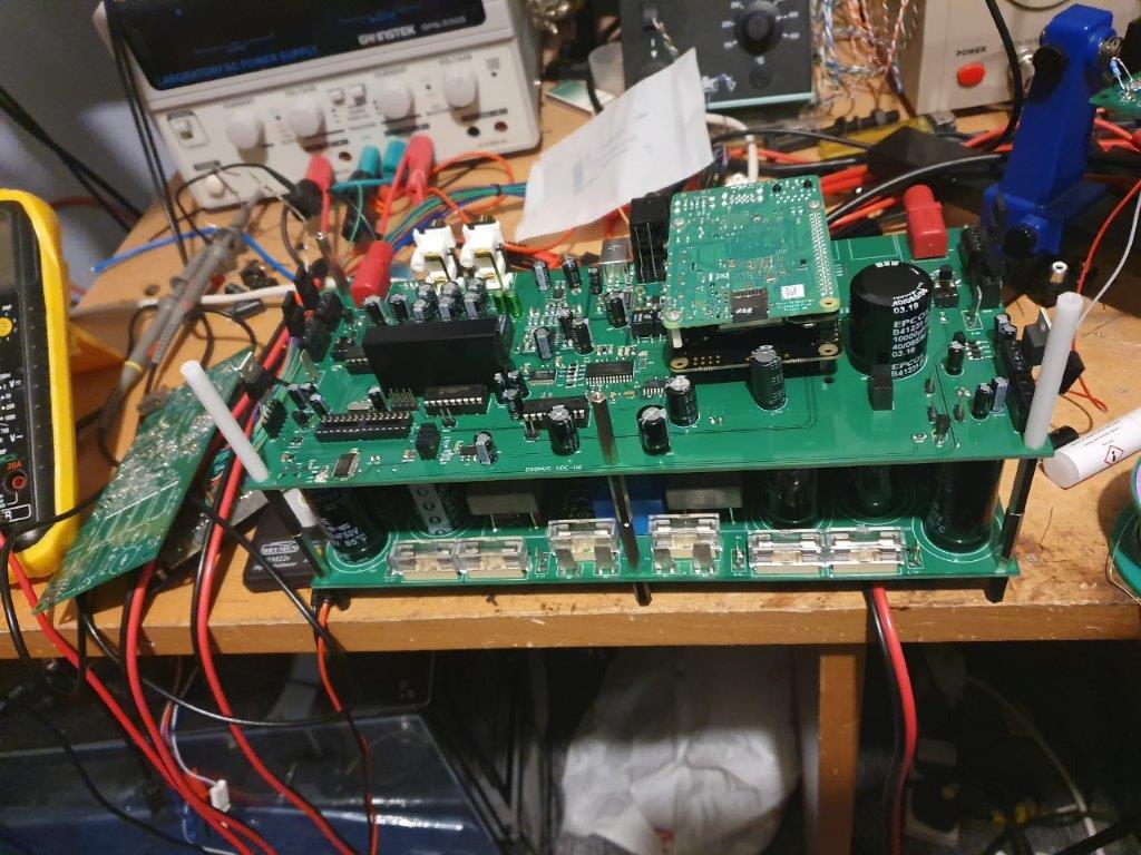

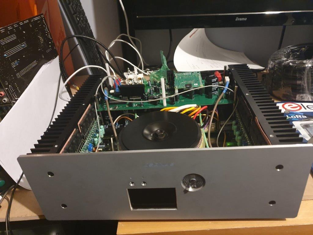

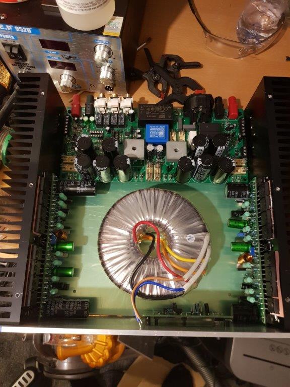

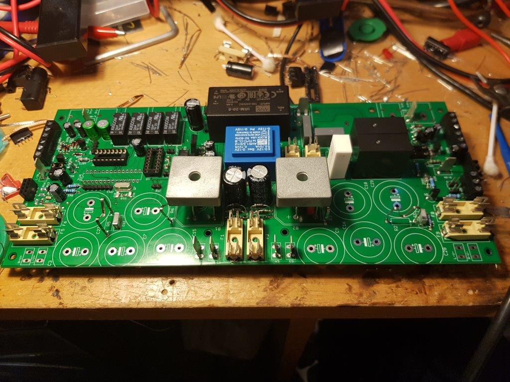

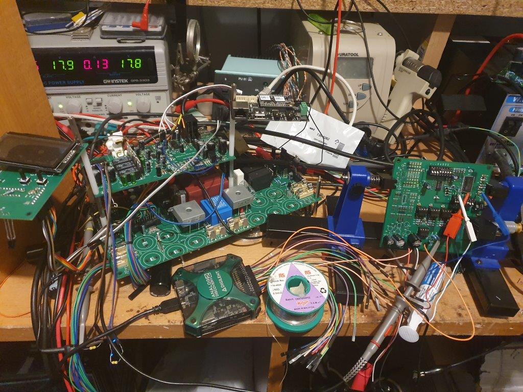

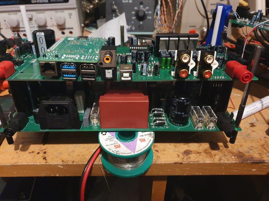

Thanks folks. Here is some more build pics. Albeit it is not the final design (i should have that built in 2 to 3 weeks time 😀).

Few more😛

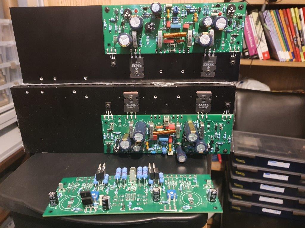

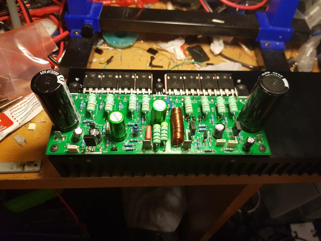

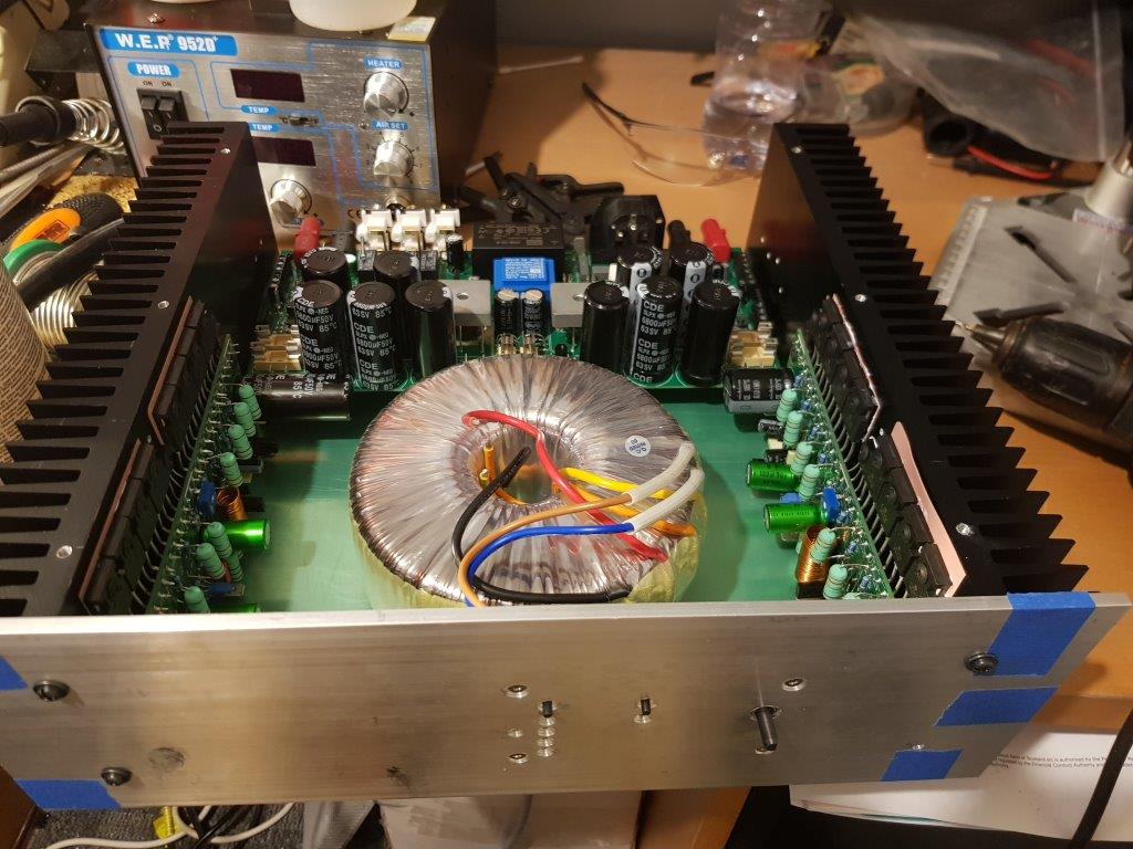

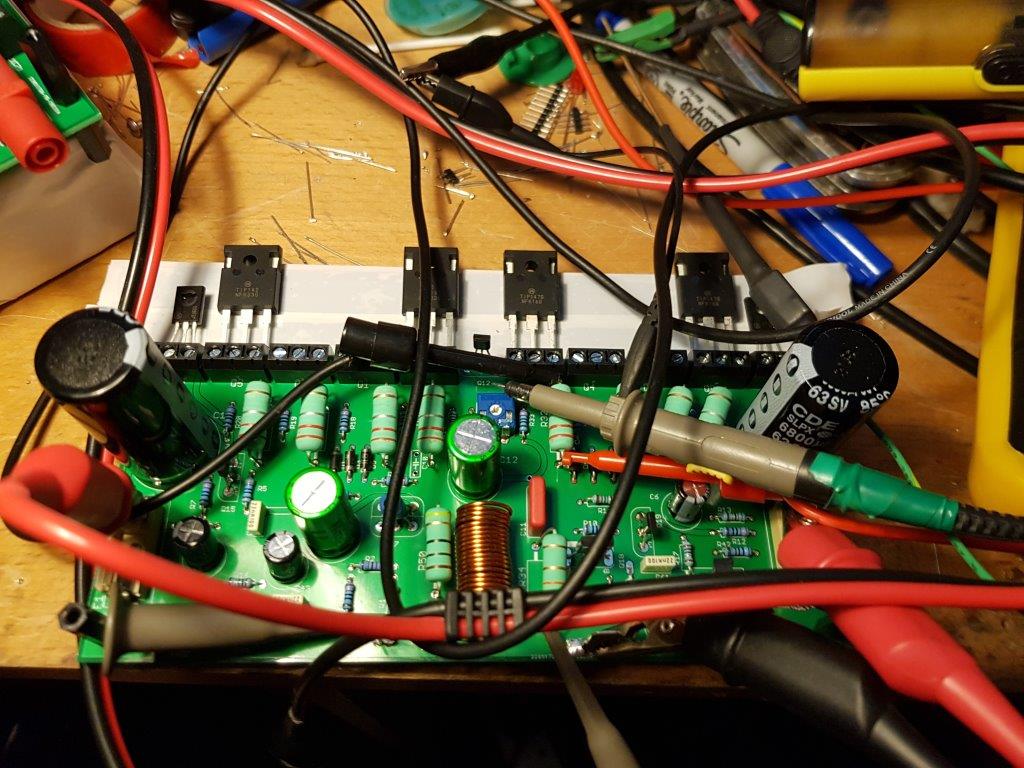

You may also wonder why I didn’t use the original PCB layout and the reason for this was to create my own universal mounting system (sry 6L6). I have now designed and tested several amplifiers with the same heatsink drill pattern; that way i can switch them out for listening tests etc without any great trouble. Here is a pic of a LAT FET amplifier (similar to PeeCeeBee design) and an NP F5 variant PCB partially populated. I also have a Honey badger and SymaSym variant with the same heatsink layout but I haven’t built these yet.

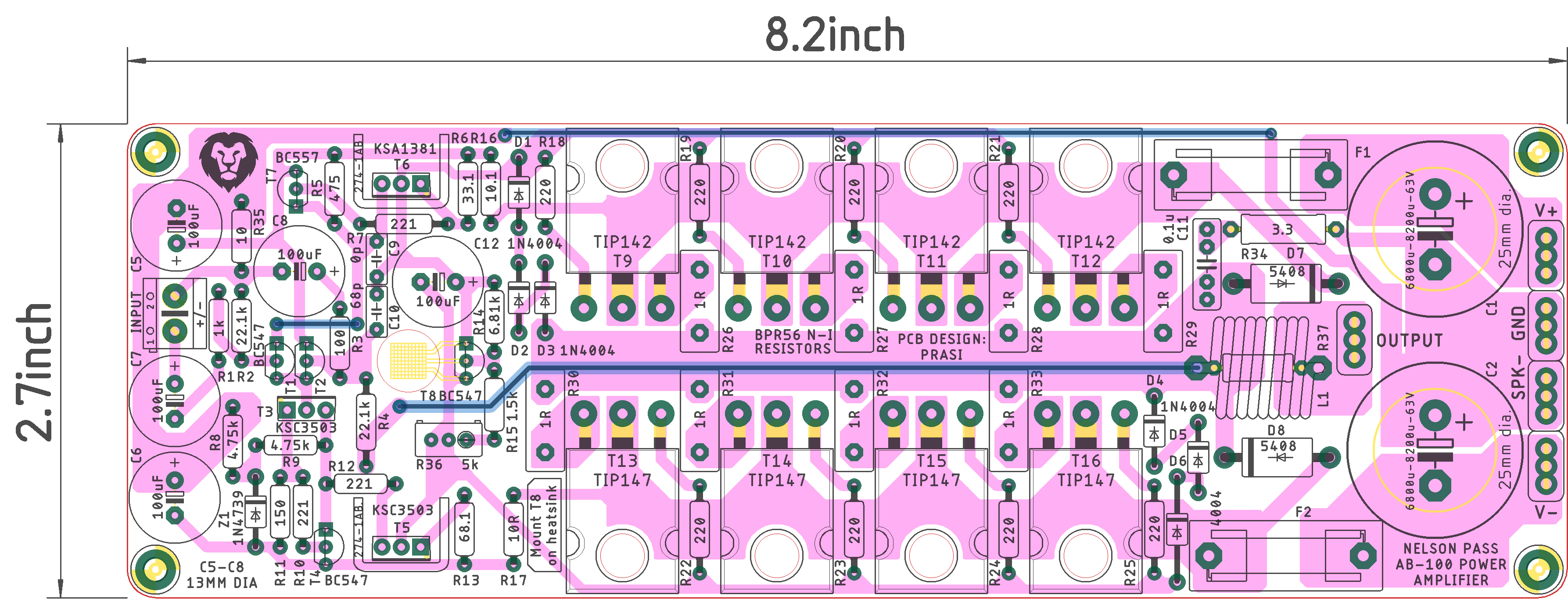

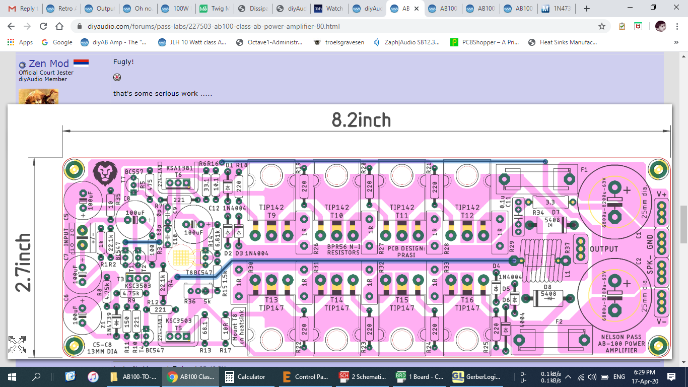

Here is a "DIY PCB" version of AB-100. Can be fitted into case like this
Dissipante 2U – diyAudio Store
I have included output inductor and rail fuses. Also included are the output clamp diodes for reactive loads.

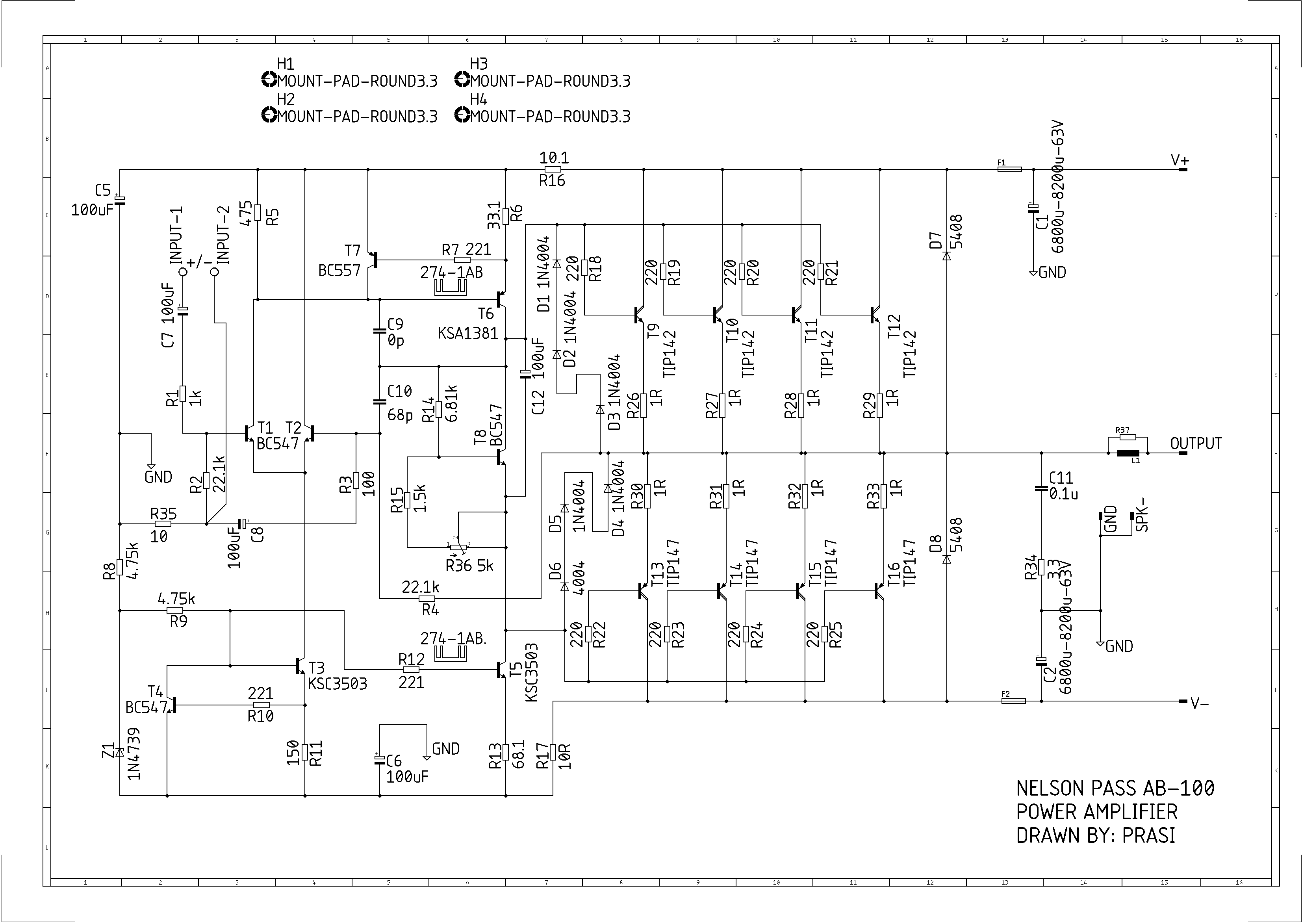

I have a query, if R35 is used as 10ohm Hum Breaking Resistor (HBR), then should R3 value be increased to 330ohms to have correct gain of 36dB as per post #1?

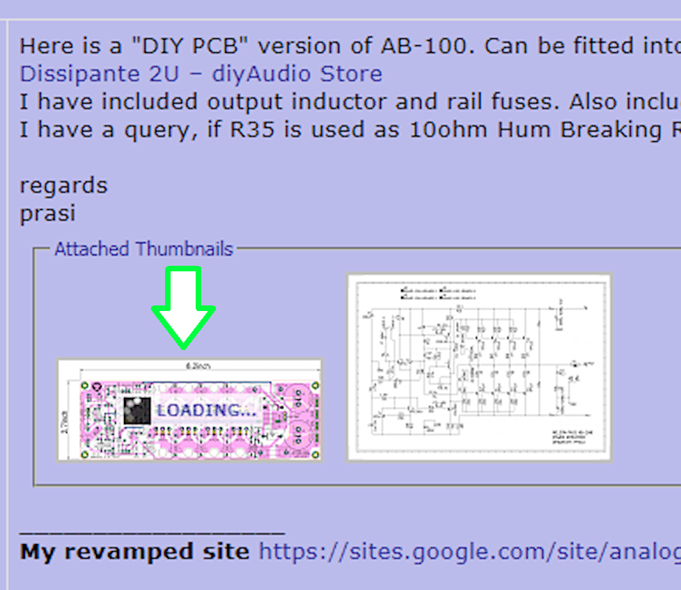

Hello Mark,
probably slower internet connection or I was editing the post. Try again now and see if it loads..

P.S. loads for me pretty quick.. its just 188kb in post 798.
