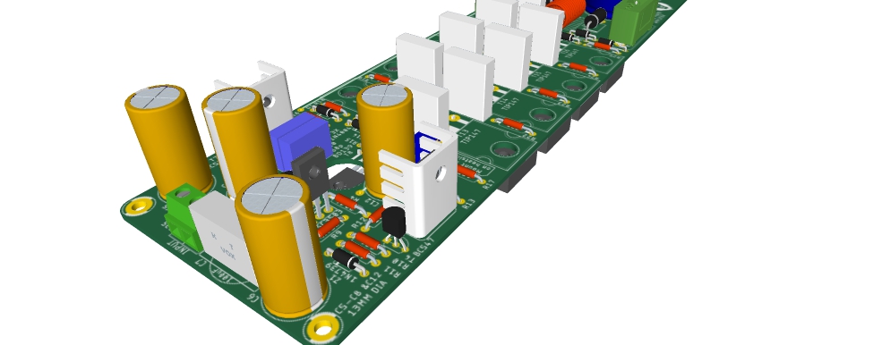

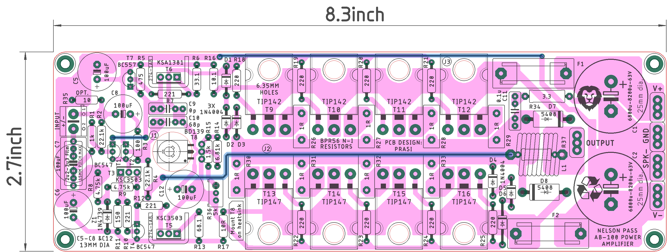

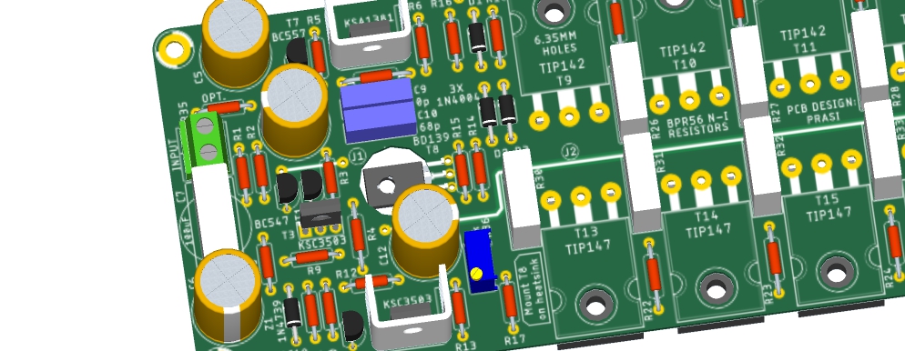

Tnx Prasi for nice board, in NP original board R35 was omitted, maybe you can consider the input C to be film cap - 2uf2 or 3uf3? and maybe use some to 126 for bias generator ? nice board anyway.tnx.

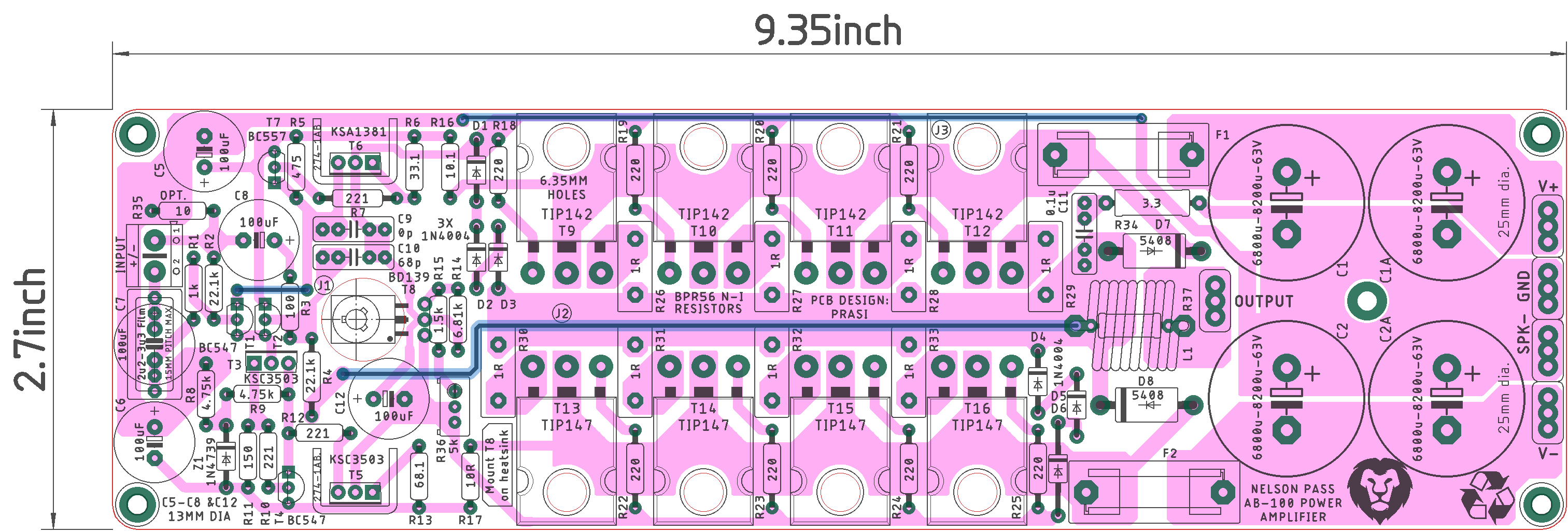

That would be really great. Both suggestions... And maybe allow the 100uF-caps to be 12,5mm in diameter so that they could be my favorites (UBX as polarized and UES or RFS in feedback). Thanks for the board anyway 🙂!
Edit says they're in 13mm already as it's printed on the board. Sorry, I should have put my glasses on 😀.

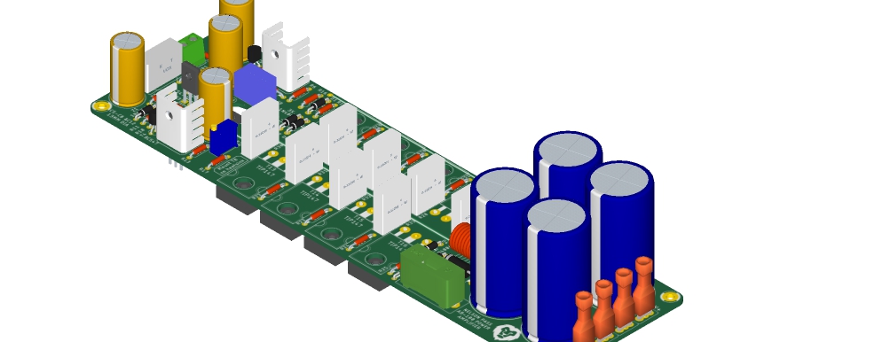

Four pads for decoupling-caps as in the original version would also be nice. The board is only ~20cm long by now. There is space for something more in the dissipante-cases 😎.

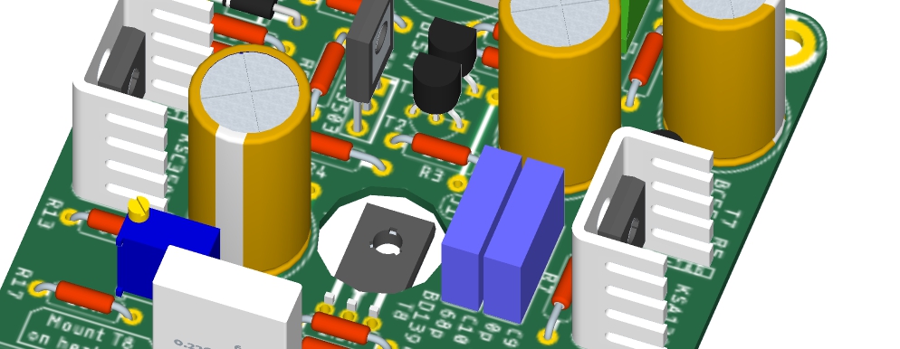

Thank you all, would a BD139 be adequate in the bias generator place from voltage point of view? OR do we need to use something like KSC part?

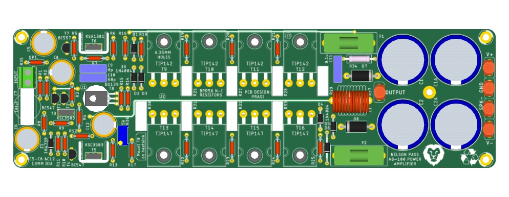

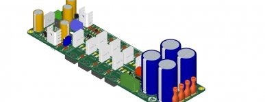

Here are 2 versions with 4 caps and 2 caps.
In both also included upto 15mm pitch film cap and TO-126 transistor for bias.
I will post gerbers and pdfs here if there are no more comments.

Thanks osscar,
here are all the files...
