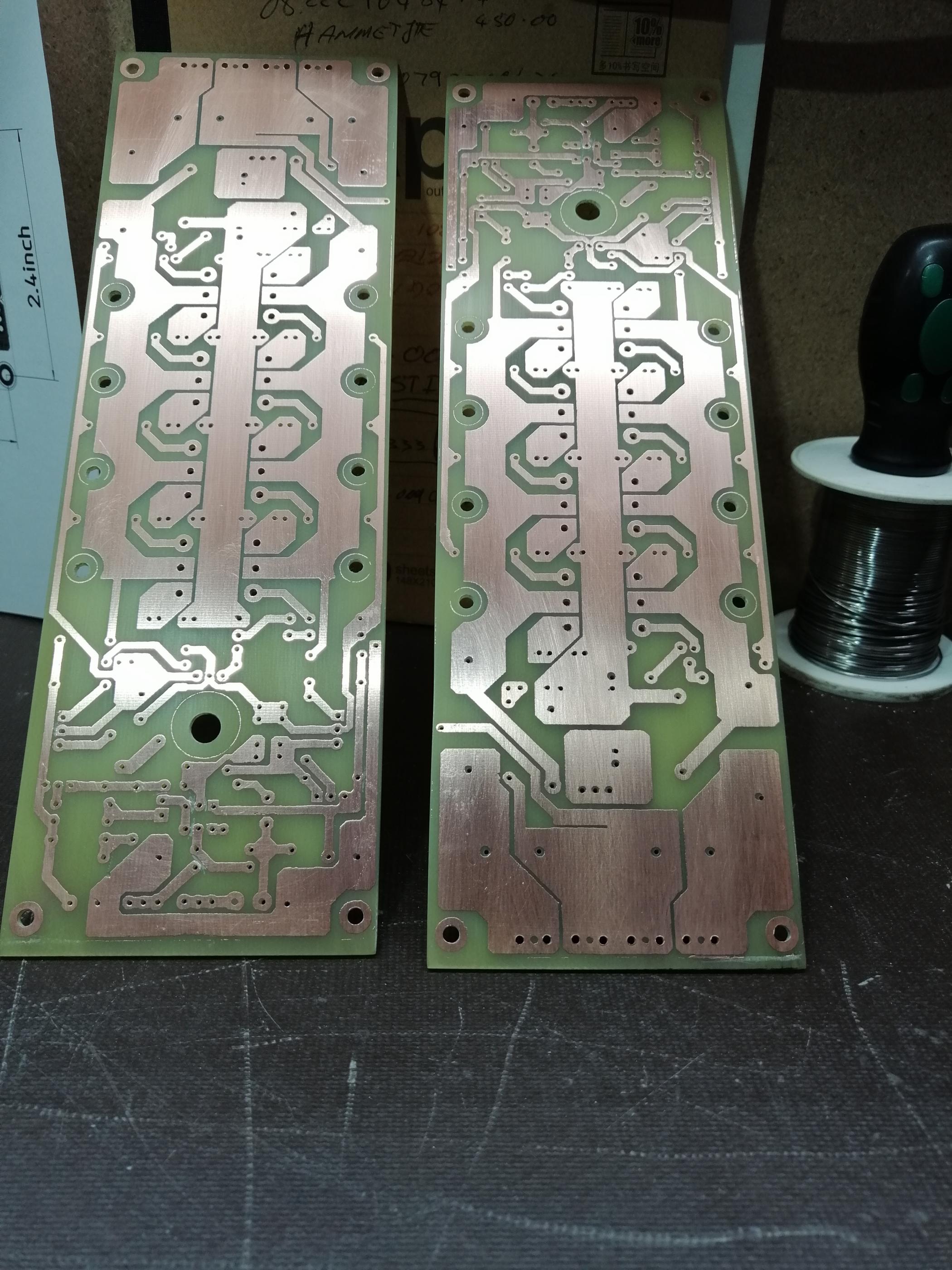

Finished with boards, now waiting for spares in this dark Africa !😀 Prasi, thank you very much, boards came out beautiful, well done !
