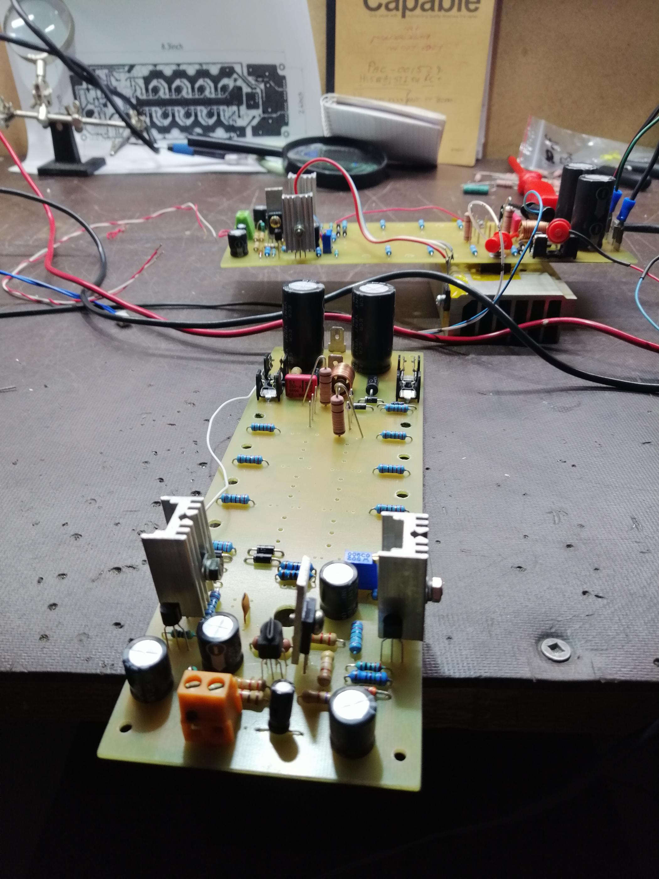

Hi, used 2uf2 and 3uf3 caps at input ( even with 1uf you will have 7Hz cut off frequency) . For my first build i used 0,5R emitter resistors (two 1R parallel) and 0,235R for second one ( 2wo 0,47 R in parallel) to lover gain i changed R3 from 100R to 1K.

Amp ha been completed and it sings like crazy 😀
Everything worked even without test boards. No hum, dc offset 2mV and 10mV per channel.
Bias 40mA per transistor - runs cool.
no turn on/off thumps.
PSU - +- 45V 30 000Uf in each rail.
indicator diode foe each rail.
Transistors - ztx450,550,MJ340/350, mj11016/15.
0,5 ohm emitter resistors and base stopper divided-100R on PCB and 100 on transistor base pin.

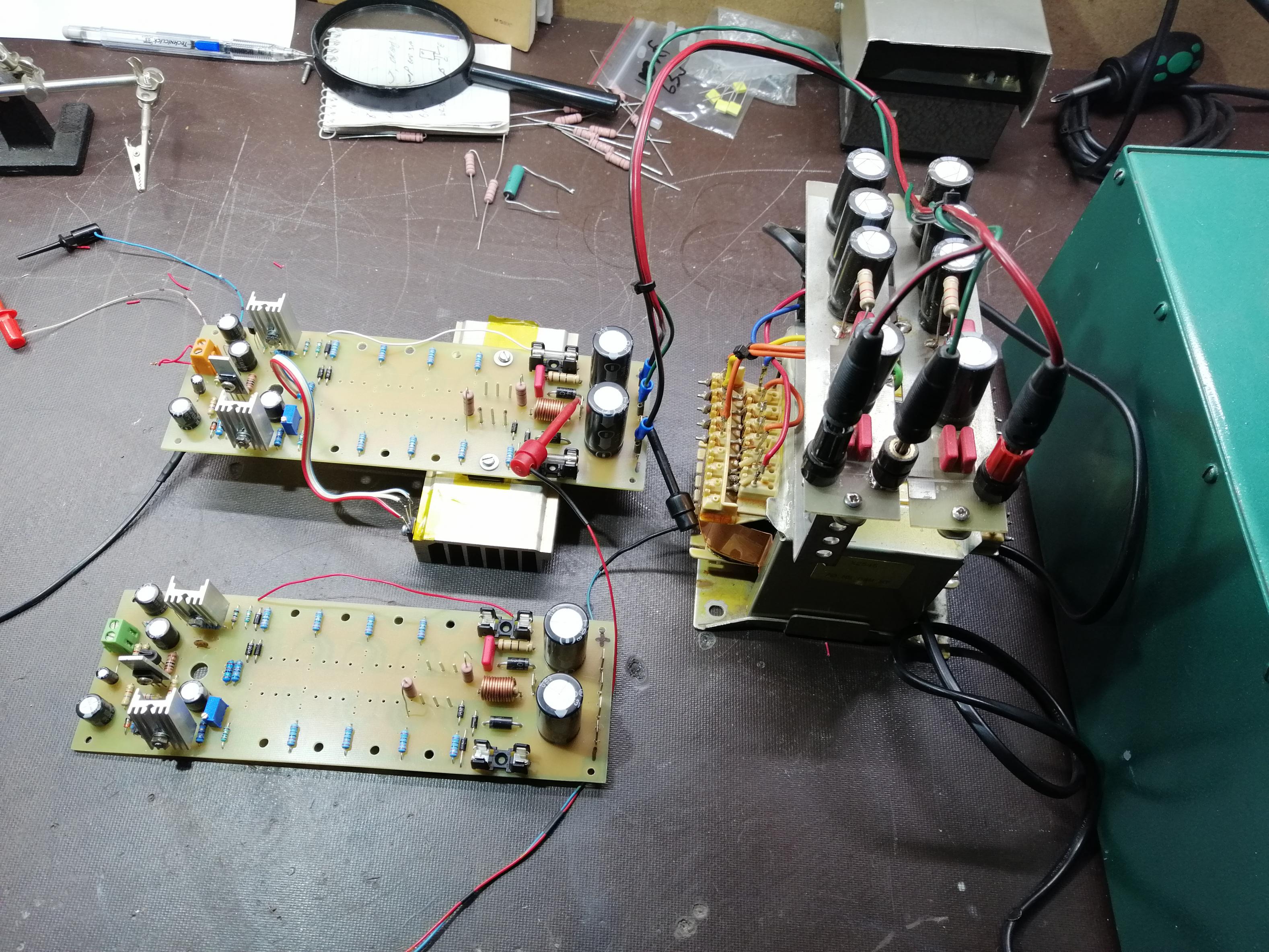

Got a chance to finish the boards. I have installed just 1 pair of OP transistors for testing. Running on +-40VDC. Bias is set to 20mA, DC offset on boards is 9-12mV and 15-18mV. I have just HFE matched the input transistors. Square wave looks good, 1kHz and 20kHz. I have used all die original resistor values except R3 is 1K.Sound is good, high frequencies are more subtle, sounds like more H2. I think I need a little more gain, maybe change R3 to 470R. I will first test with a decent preamp and not using a phone as source. What will the advantage be in changing the emittor resistors from 1R to 0.47R ? Thank you Mr Pass and Osscar for the help and thanks Prasi for the great pcb layout !🙂

Looks very good, no ringing etc. Yes , you can adjust gain. According to D.SELF's book - the smaller Re - the better, but you need a greater bias current and a greater risk of burning something
usually i see that all amplifiers use 0.22R or 0.33R or 0.47R.

osscar, thanks, Am I correct when I say the lower the Re, the more the output power ? or does it change the sound as well ? yes, I have used MJE's and I'm using 10uf input cap for testing purposes. Signal transistors are BC547,557.
not so much output power - but more each output transistor bias - with 1R N.Pass has specified approx. 20mA per transistor.
With one pair and 0.235R I set 100mA per transistor and with 2 pairs and 0.5R - 50mA on each. with these settings amps run cool and sounds nice.
Ok thanks, think I will get 0.47R Re's, now I first have to wait for the machined heatsinks. Thanks a lot !😉😀

Well I have tested both boards today for an hour or two on idling with input shorted. 9-11mV dc offset, bias very stable at 20mV. It might be that the caps have reformed a bit but the sound is great, I'm sticking with 1R emittor resistors for now, can always change if needed. I might use another transformer with +-50V rails, but I dont think it is necessary. A very happy chappy I am.😀
