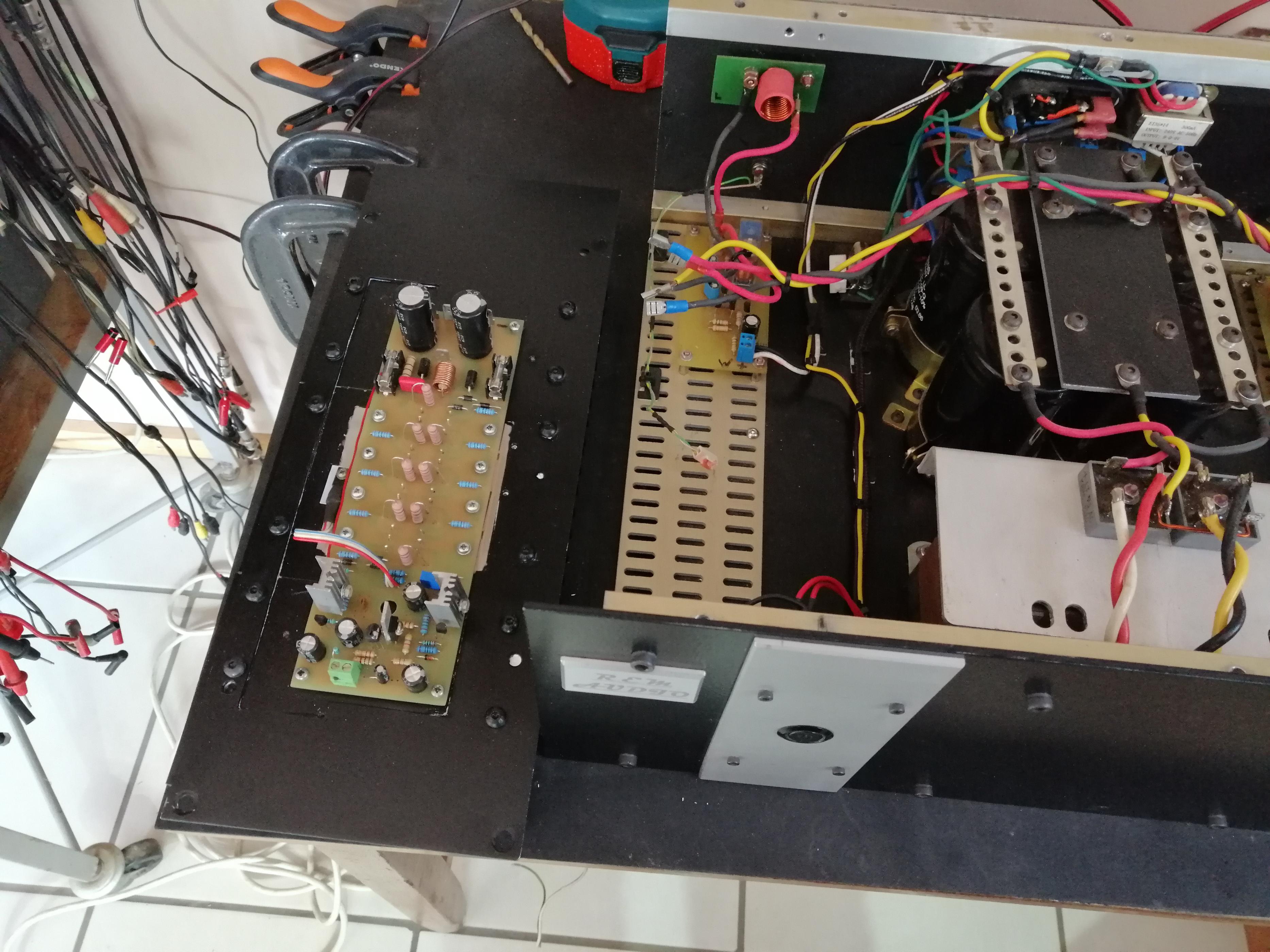

AB100 Class AB Power Amplifier
Almost finished, I decided to replace the MJE transistors with the KSA/KSC trannies, it sounds much much better, midrange and highs are great !
