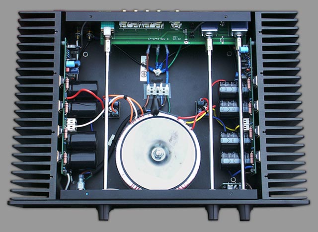

I think this is the AB100,
Portal Audio Panache Integrated Amplifier
To me it looks like there was no "separate" capacitor bank, just the ones on the amp boards, fed by a dual output 425 VA toroidal transformer to two bridge rectifiers.

So was looking for some feedback in earlier post on bridging output and using with a 6 ohm load?? Too much for this amp? Notice that it is rated for double output into 4 ohms so that is a good sign.
In the amp you built, what did your power supply chain look like?
Did you just have the transformer into a rectifier onto the board?
Any Pics?
