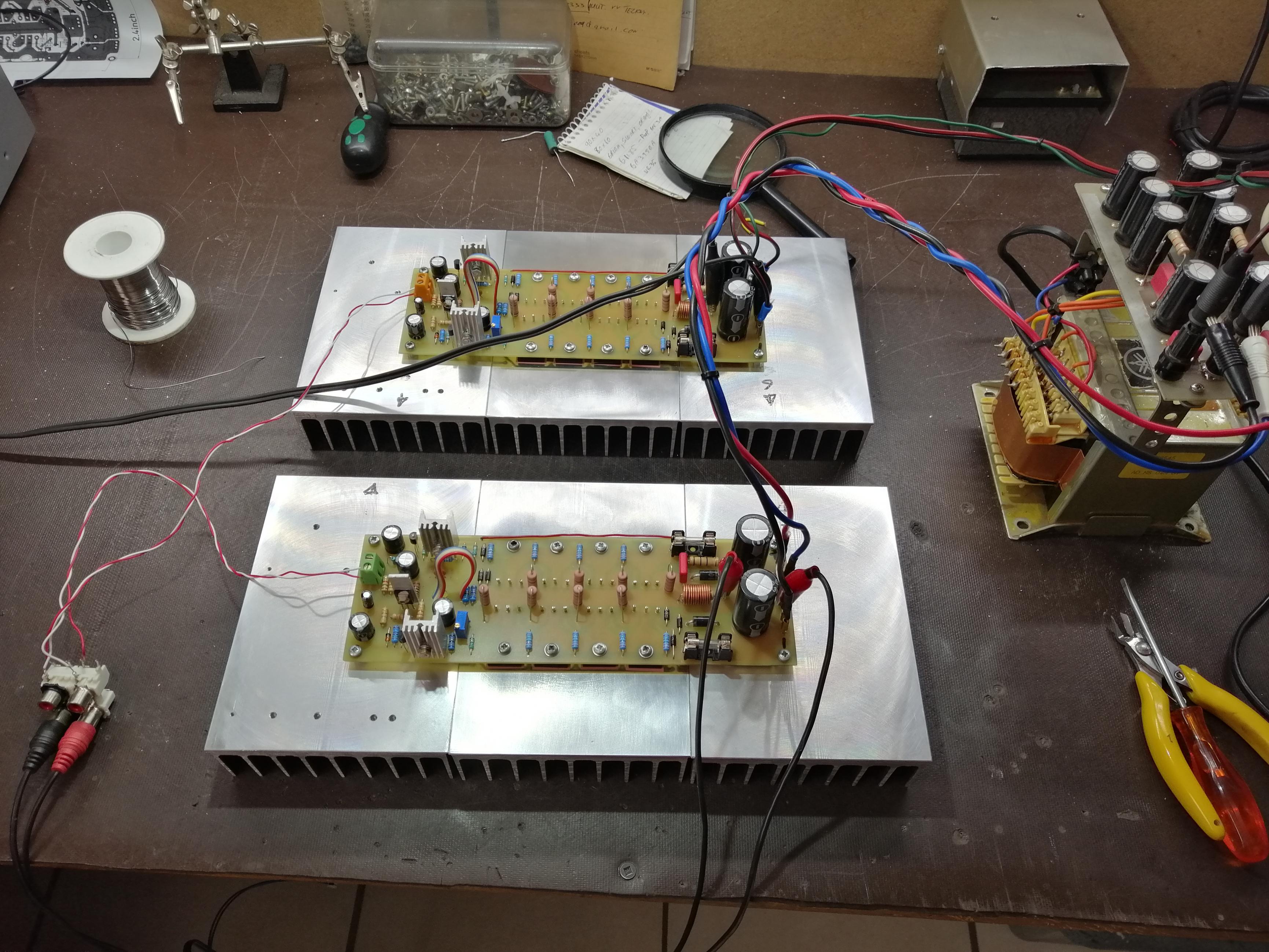

Had a chance to do some work today, one channel finished. Only have 5000uf per rail currently, I will connect some plenty more tomorrow and see how it sounds. DC offset 10mV and bias 20mV per emitter resistor.🙂

Looks good :violin: !

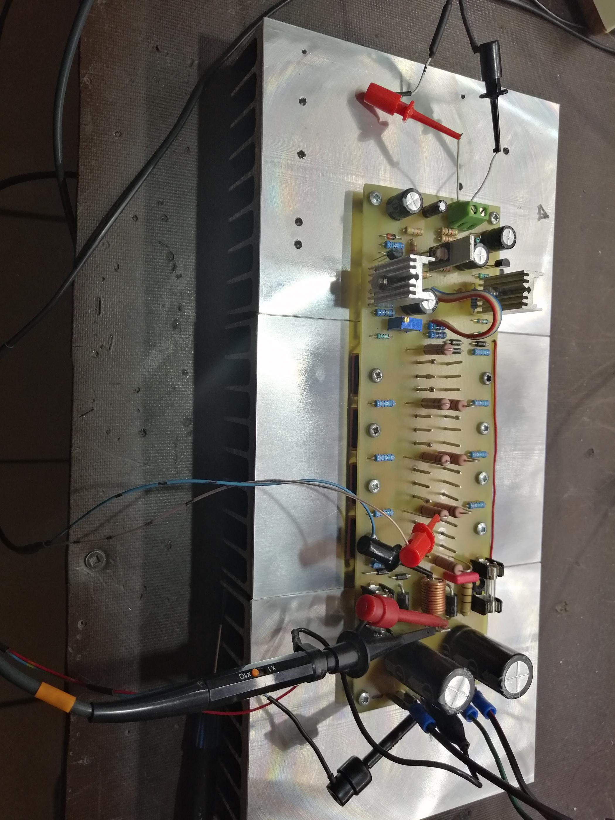

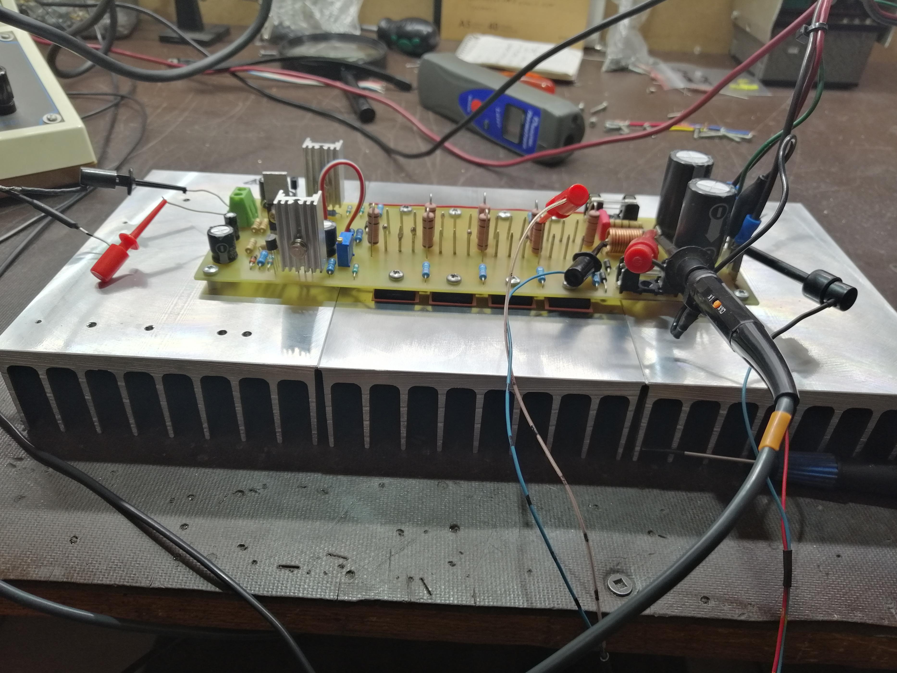

Thanks osscar and Mr Pass, both amps sounds good and it does have a tight bass that sounds superb !🙂 And none of the terrible oscillation that were predicted by Sakis. Sakis, plse build a channel, you will be surprised.😀
