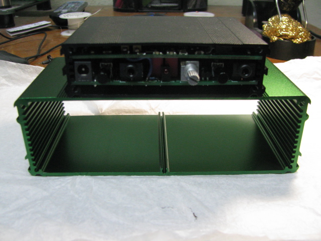

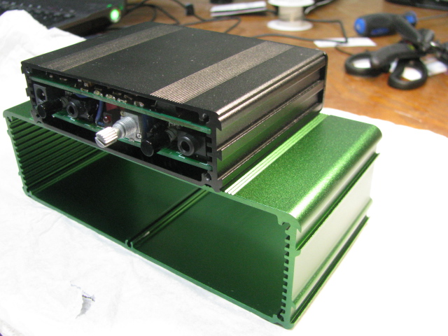

Here is how the O2 and the ODA cases stack up size-wise:
