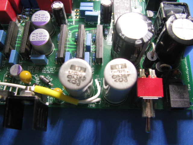

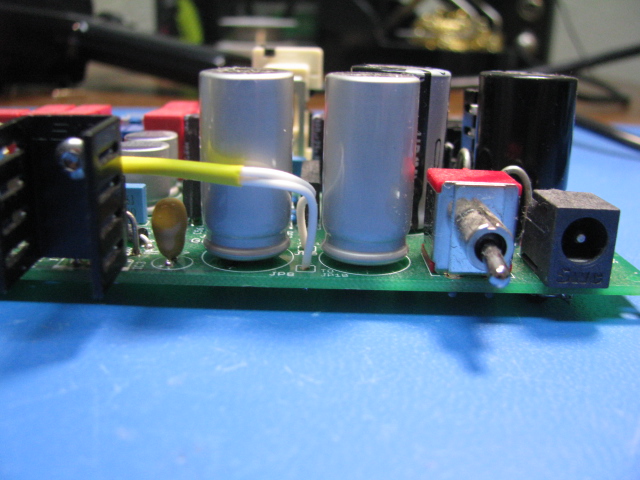

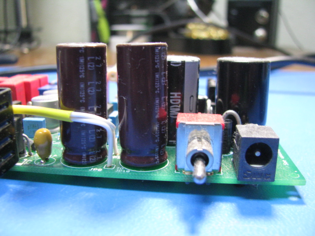

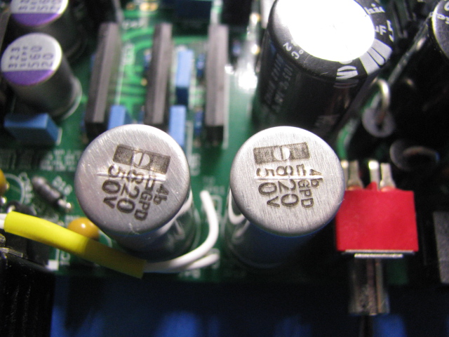

New 820uF, 50V, 25mm tall caps are in stock at Mouser
The new, shorter, 25mm tall 820uF 50V power supply filter caps for this project are finally in stock at Mouser as of two days ago.
I've just updated the BOM out at the Google Drive link in the first post in this thread. Up until now I've had these new caps listed in the BOM as an alternative in yellow background, until Mouser started stocking them.
Photos below showing the old 30mm high caps (brown) vs the new 25mm high (silver). The negative lead on the new caps is denoted by that black bar on the top of the cap. All 4 filter caps are now 25mm tall, leaving lots of spacing to the top case slot for any future board additions there.
Mouser appears to have all the other "out of stock" stuff in now too: the 1K linear volume pot, the vertical RCA jacks, and the 24V coil relay.

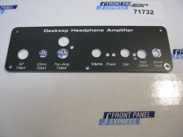

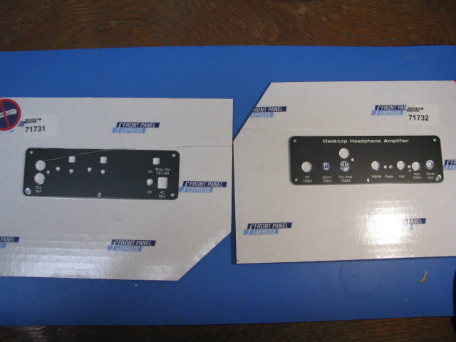

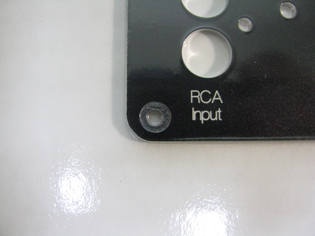

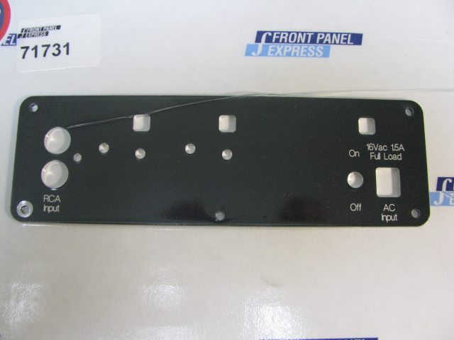

B2-080 case blank panels sent into FPE - CAD files
I've finally had an opportunity to try mailing the two blank panels that come with a Box Enclosures B4-080 case to Front Panel Express to use as the drilling stock. The finished panels arrived today. I'm happy to report the results are just excellent. The panels that come with the case have the edges color-anodized too and slightly rounded for a nice professional look. The aluminum stock that FPE would use normally is milled out of a larger sheet so the edges wind up as bare aluminum with a square, sharp edge.
The photos below show the panels as shipped, then a close up of an edge of the new panels (black panel and edge) vs. a blue panel from a previous run that used FPE's own stock and wound up with the bare aluminum edge. That isn't a scratch on the rear panel. They are still blister packed to the shipping cards here and there is small crease in the blister plastic.
The Front Panel Designer CAD files have to be modified to remove the five panel-to-case holes, since the blank panels from the case already have those drilled. I've posted the new CAD files out at the project Google Drive link. Under "panels" there is now a subfolder for using FPE's blank stock or mailing the B4-080 panels to FPE. When the panels are mailed the order number(s) from FPD just have to be written on the shipping box somewhere and/or included with the blank panels to match them up to the order.
The procedure for using the panels form the case is pretty simple. In the CAD program there is a checkbox under "file" -> "panel properties" that says "use customer provided material". Just check that and everything else stays the same. The panel color selection is ignored. The box has already been checked with the new CAD files. The origin also has to be specified in an email to FPE with the order numbers that FPD generates. In the case of these panels the origin is off-panel, since the corners are already rounded on the blank panels, at the intersection of the left edge and the bottom edge, and the blank panel oriented so the 5th mounting hole is at the bottom in the middle.
The one concern I had is how well the countersink around the lower left moutning hole, to break the anodization for a good electrical contact, would align given the pre-dilled panel hole. As can be seen in the 4th picture the alignment wound up being very good.
