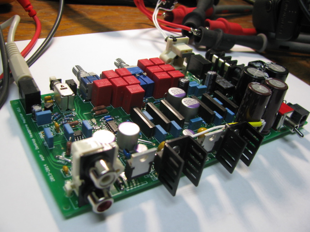

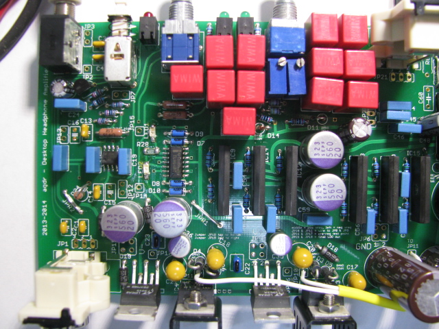

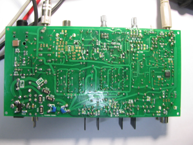

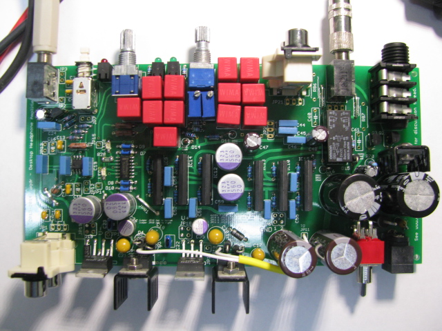

An update on the V2.1 board building and testing. I have the full power supply built up now on a V2.1 board and it works. I'm going to use that board as the rear board in a 2-board ODA V2.1 build. The transorb across the power line is back - I realized that a leaded version can simply be soldered across the AC power jack on the bottom of the board. I have about 90% of the rest of a V2.1 board built and should be able to test it when some parts arrive from Mouser on Tuesday. If all works then I will finally be able to ship some boards out. 🙂 I'll send PMs to everyone on the waiting list when the time comes.
The ODA V2.1 PCB works
It works! 😀
I finished an ODA V2.1 today and did some testing. Works great. No layout errors.
I want to run it 24hrs for a couple of days. I'll send PMs out to everyone on the PCB waiting list when the time comes, probably later this week. I have some LT3015 and LT1963A regulators on order (Mouser doesn't stock them but Digikey does).

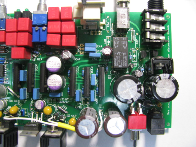

The new V2.1 boards arrived today already! Photos below. Now I'll build one up and test it. 🙂
