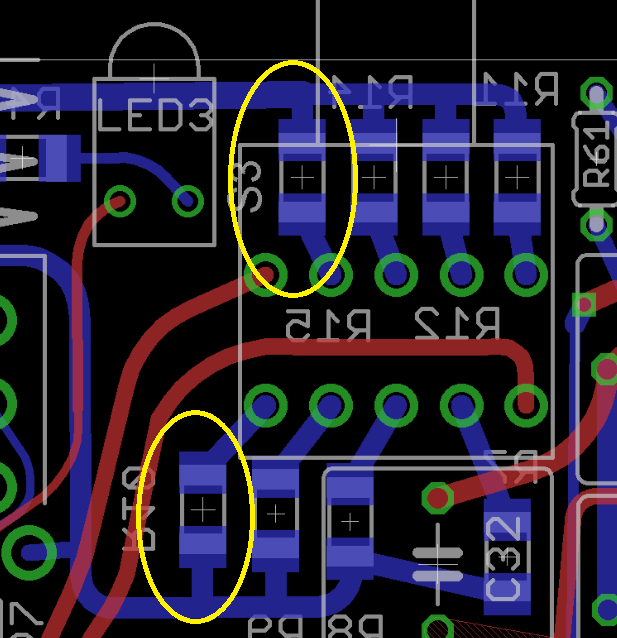

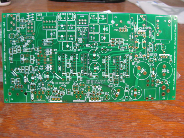

Remove R10 and R15 if using 1x gain, + V2.1 update
I just found a screw-up. 🙂 Luckily it is easy to correct. In the picture below R10 and R15 are the surface-mount resistor pads for the lowest gain switch position. I have that lowest position defaulting to 1x (or 1/2x if the attenuation resistors are used). In the BOM I have those resistors listed as 15K.
If you are using 1x gain those pads should actually be unpopulated - remove the 15K resistors if you have soldered them in. A super easy way to do it is place a piece of copper desoldering wick on top of the 1206 SMD resistor and then heat the braid. It will melt the solder on both ends of the resistor at once.
There doesn't need to be any resistor in that position if the gain is 1x. The stage then defaults to a unity gain voltage follower with the 1.5K feedback resistor on each channel. This is similar to cutting out the gain resistors on NwAvGuy's O2 Headphone Amp for 1x gain. Using the 15K resistor gives a gain of 1.1x rather than 1x. Worse still, it inserts a 15K resistor worth of Johnson noise into the feedback loop in the 1x gain position.
If your chosen lowest gain switch position is something other than 1x then you will need resistors in these two positions, of course.

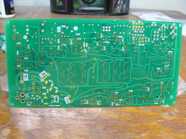

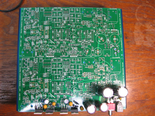

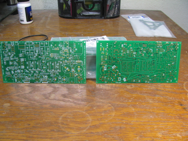

The new V2.1 boards arrived today already! Photos below. Now I'll build one up and test it. 🙂

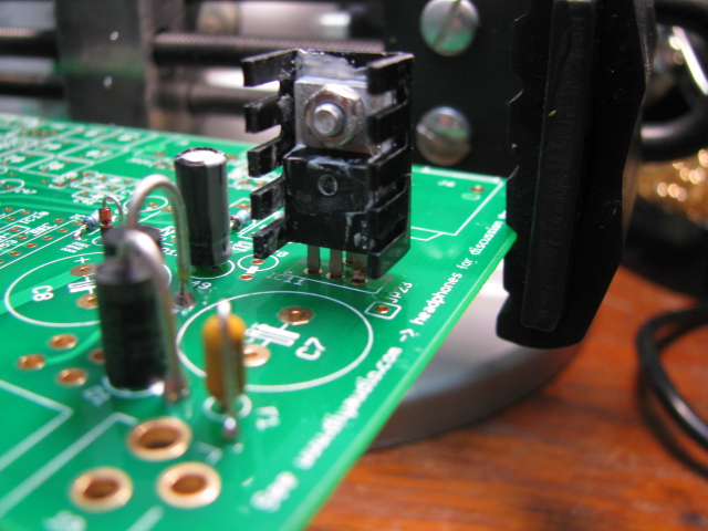

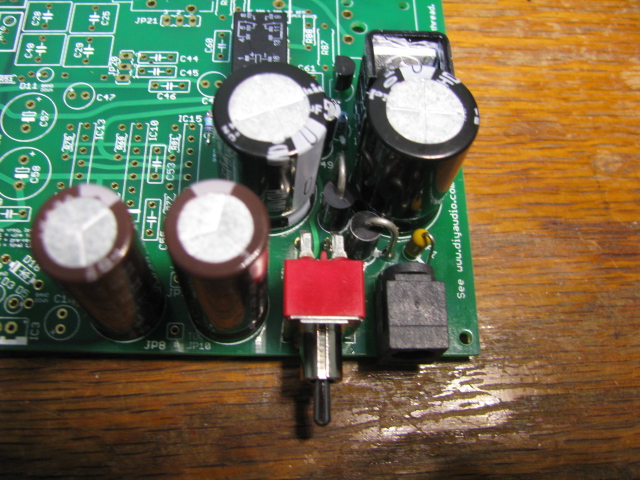

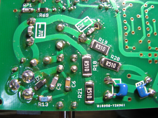

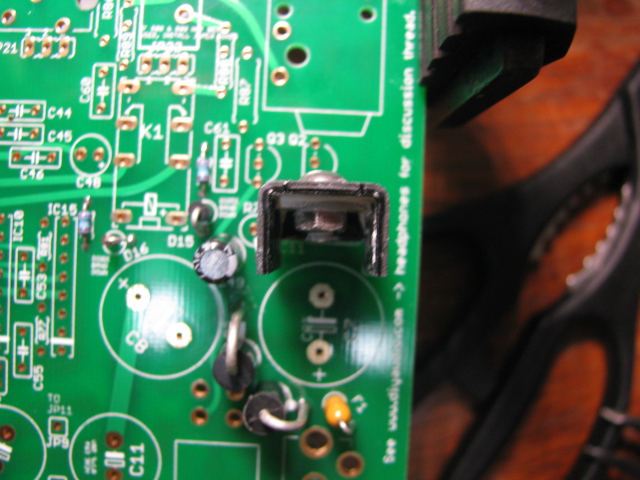

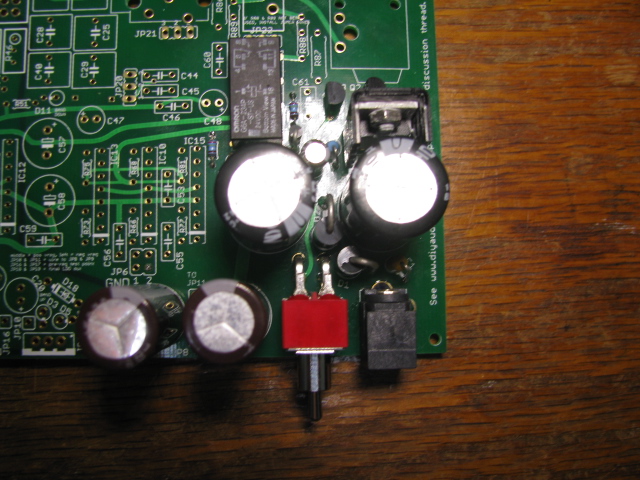

In other ODA news, below are some pictures of the power input section on the V2.1 board built up. Note the new larger PCB-pin mount heatsink on IC11, the 4.7uF relay timing capacitor now under the 1.4" jack as surface mount, and the new fuse. Also shown are the new 0.01uF ceramic capacitors across C11 & C12 (leaded parts) and C7 & C8 (through hole) on the bottom of the board.
D17, what was to be the new line transient absorber, is the first mistake I've discovered. 🙂 I had a brain hiccup somewhere along the way and specified a unidirectional part rather than bi-directional - and bi-directional is a different package size. So D17 will be left off the build and BOM (even though it shows soldered in here).
The whole pile of build photos will be posted on the project's V2.1 Google Drive. The steps are so similar to V2.0's photo build posted on the forum here that I will just include some text files there about the differences.

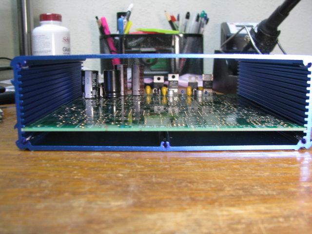

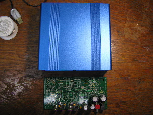

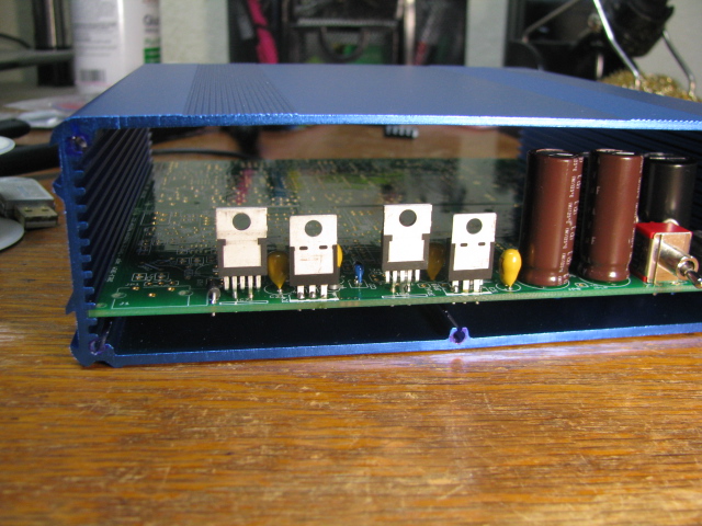

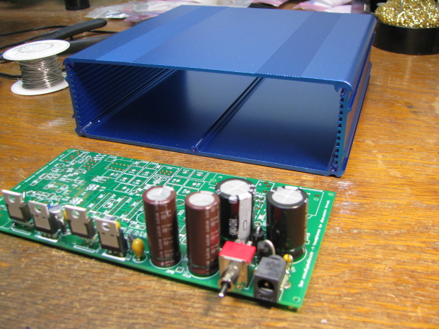

B4-160 case and the 2-board build option
I received one of the longer B4-160 Box Enclosures cases today for the 2-board option. Below are some pictures of how it looks. At Allied Electronics the B4-160 case is about $10 more than the B4-080 case.Two ODA boards fit end-to-end. The ODA board in the photo is one I'm building up specifically to be the "rear board" in a two board build. The parts shown in the photo are pretty much all it will have, just the power supply and relay sections. This one still needs the rear RCA jack and the relay circuit (minus the relay itself) added.
* The next photo shows the rear board and a blank board end-to-end on the top of the box. That "front" board will have all the parts populated except the parts on the rear board (power supply, relay circuit, rear RCA jack). In my case for testing purposes I'm going to use a fully populated ODA board for the front board, I'll just un-jumper the power disconnects, JP18 & JP19, and instead feed the power from the rear ODA board.
The six wires needed to connect the two boards are
1) ground, V+, and V- between the two boards. So any of the 4 holes in the rear board JP6 ground connection to any of the 4 holes in the front board JP6. Either of the bottom two JP18 V+ rail feed holes in the rear board to either of the top two JP18 V+ connection holes in the front board. Either of the bottom two JP19 V- rail feed holes in the rear board to either of the top two JP19 V- connection holes in the front board. All three wires should be twisted together.
2) two audio coaxial cables going from the rear RCA jack pins JP1 to exactly the same holes in the front board JP1. The front board won't have the rear RCA jack installed of course. I will probably also include instructions on how to cut the traces going from JP1 on the rear board (easy to do). That will remove the extra trace length along the left side that would normally connect the rear RCA jack to the input select switch, which would help eliminate any noise pickup.
3) one wire going from the relay out circuit on the rear board to the relay on the front board. The relay circuit is relative to the V- rail, so the other half of the relay connection gets made automatically when you connect the V- rail.
* The last two photos are front and back shots with both ODA board in the second slot up from the bottom end-to-end.
