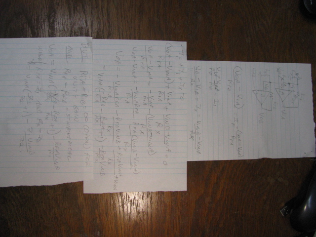

The simple parts addition to the ODA didn't work out. I was hoping that bridging the two gain stages at the non-inverting inputs would work but I ran through the math and no dice. It does come up with cross terms from the opposing input, but it isn't the same terms for the Meier crossfeed. Putting it in where the attenutaion resistors are might work, depending on loading by the 1K pot. I'll look into that.
