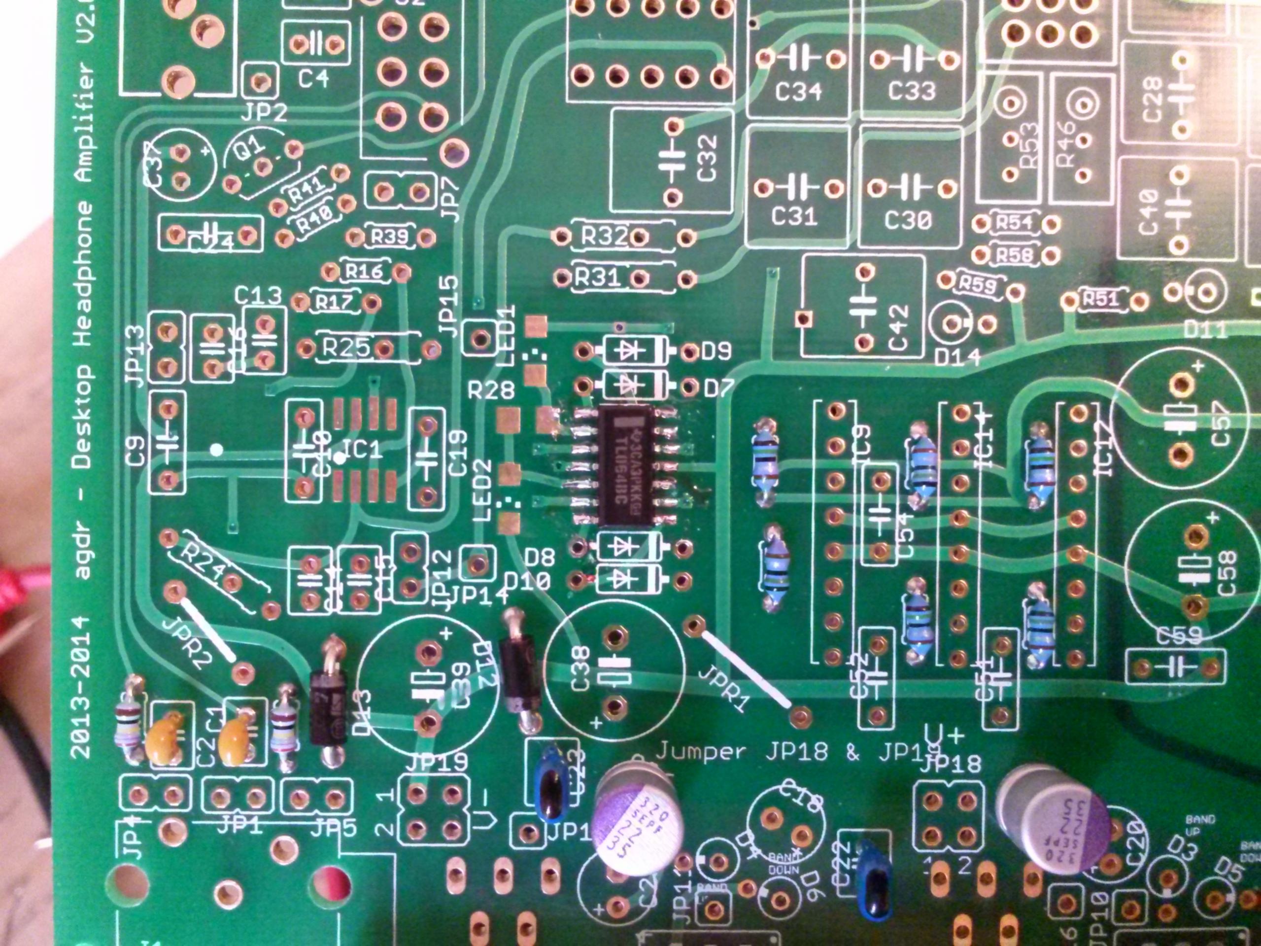

First mechanical fit issue, D16 1 amp 400v 1N4004GP E3/E4 diode doesn't fit in the hole for D16. D15 is ok, its a smaller dia set of leads on that diode (1N5260B-TR).
Same for D3, D4, D5 and D6.
Will try to open up with a small drill or "sand" down the diode leads carefully etc.

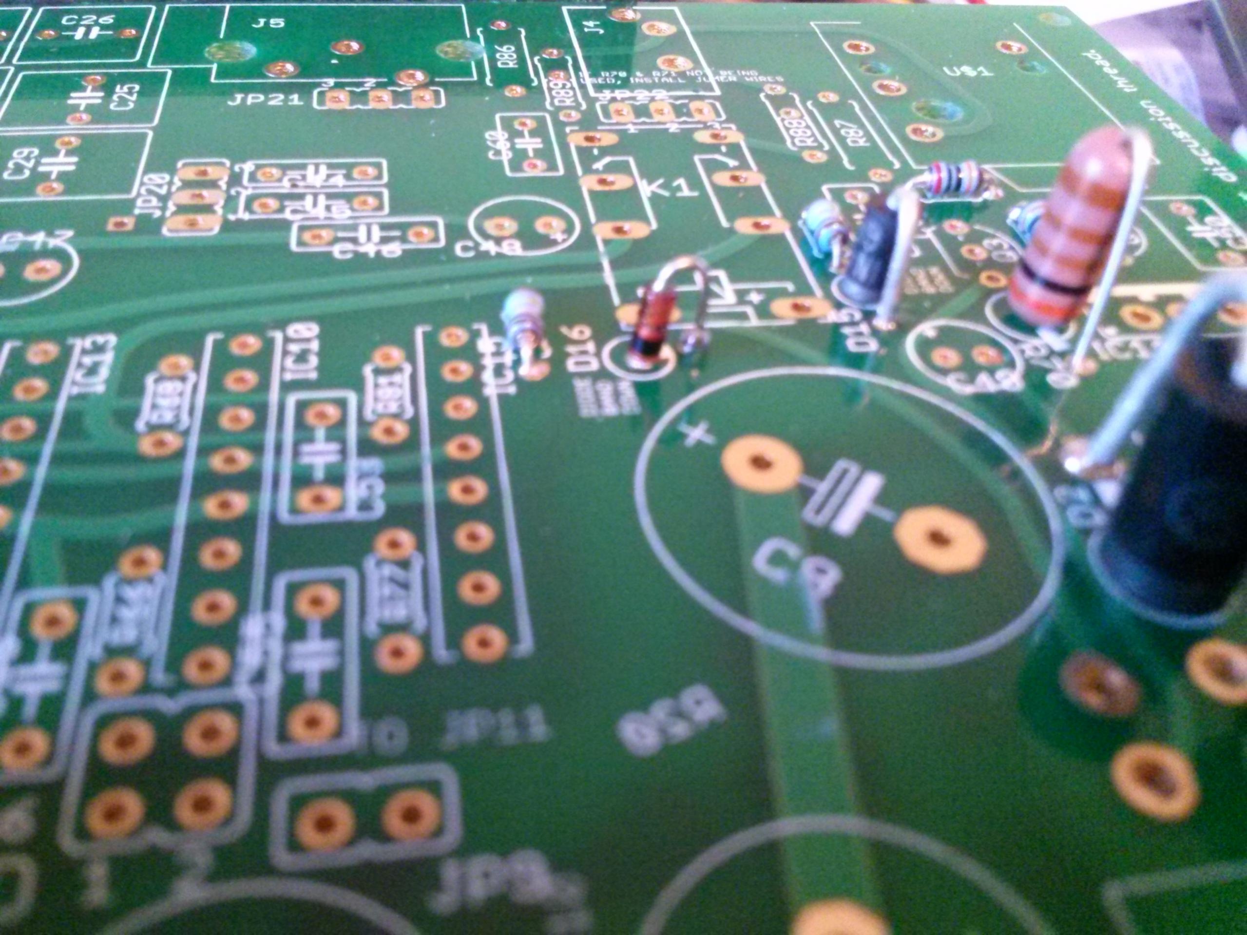

Alex, it sounds like you have your diodes swapped. D16 is the 1N5260B zener in the smaller DO-35 case, while D15 is the 1N4004 in the larger DO-41 package. Probably best not to drill the board right there - if swapping the diodes don't solve it please PM me and lets discuss. ALSO - I did have a larger 1W zener in for D16 in an earlier version of the BOM and changed that to the current 1/2W. That larger one (different part number) won't fit. If you ordered that by chance off an older BOM, let me know. I have a pile of the 1/2W here. That goes for anyone else building on this set of boards too - if you ordered the wrong zener diodes for D16 just let me know and I'll send you replacement no charge.

Here is the best photo of the zener in D16 band down and the larger fitting 1N4004 in D15.
Alex
Note the only 1N4004 diode I have installed is the one in pix D15, I had to take an emory board and ever so gently file down the leads to get it in the holes....np. So its not the wrong zener etc..

I looked at the mouser site for the 1n4004 diodes and the part number in the BOM is for the DO-41 package...so it looks like the holes in the board itself are just too small for this DO041 package lead size...

Well this has certainly been an interesting find. It would appear that you are right. In the photo build that I did the 1N4004's were one of the few parts where I used a bunch I had on hand rather than the Mouser part I specified. I did get some of those Mouser diodes in though last week and just tried one in MisterRoger's boards that I still have here. Sure enough, doesn't fit. Not sure what exactly is going on there yet, probably an Eagle library error, but there is an easy fix. I have a big pile here of the ones that do fit, so I'll simply send a set out to everyone, no charge of course. Problem solved for this build, and I'll get the Eagle issue corrected before the next board run.

I've found the problem. When I created that vertical 1N4004 part library I somehow screwed up and used DO-35 sized pads. Then I never noticed the problem because the pile of 1N4004 and 1N4006's I have on hand just happen to have leads sized at the lower end of the 0.072mm - 0.86mm range for DO-41 and fit just fine. 😱 Murphy's Law is still aliive and well.
The other few vertical diodes on the board are zeners and really are DO-35, so all is OK there.
I have the problem fixed now and I've re-posted the Gerber files out at the project Google Drive link. I'll mail out those diodes on Monday. Thanks again to Alex for finding this one!

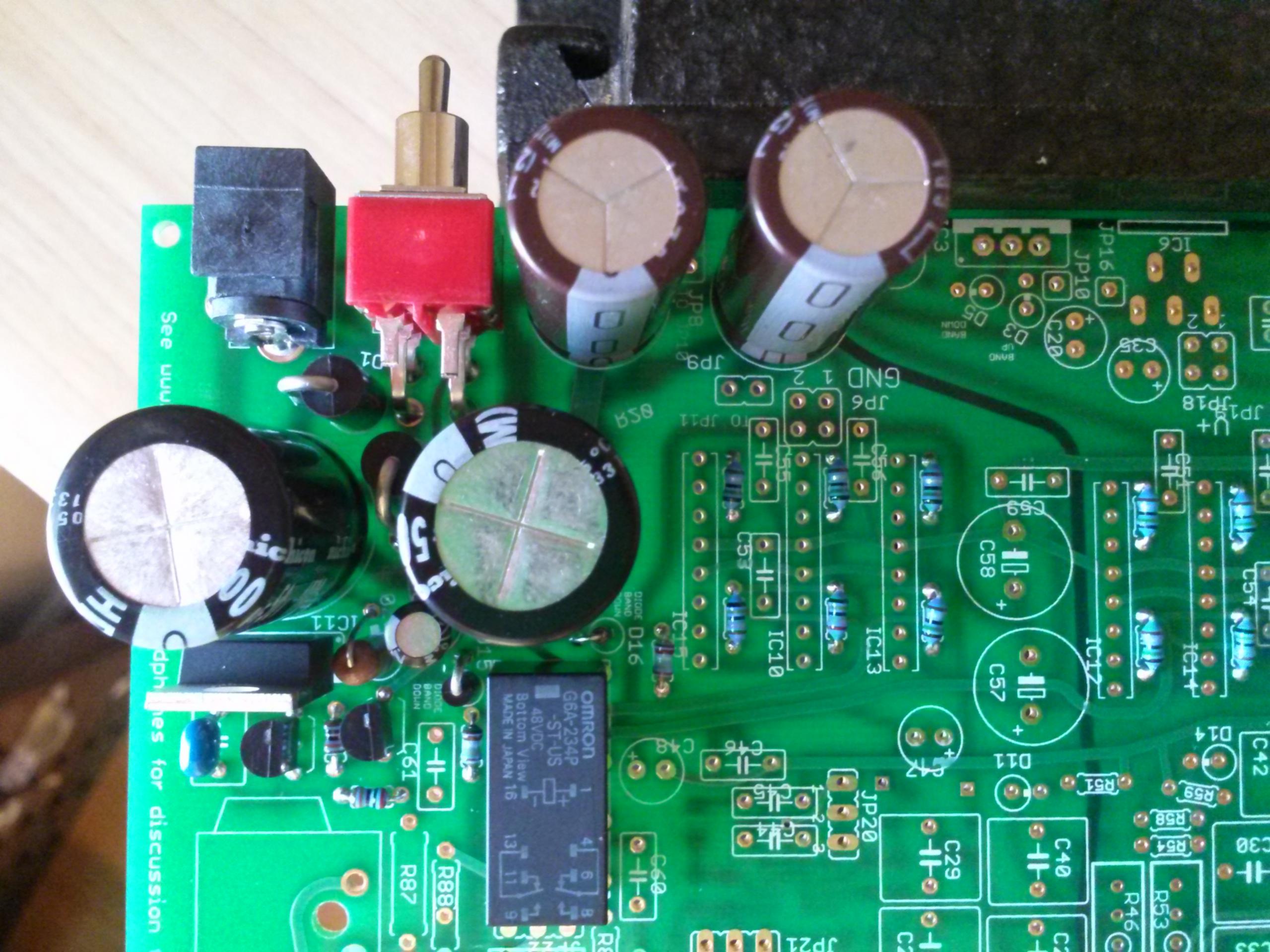

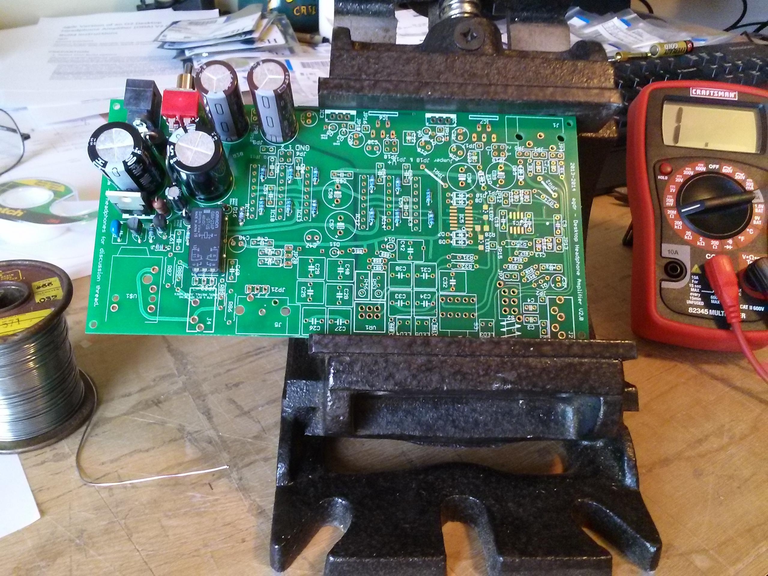

Ok Assembly Step 1 completed...
Including the 12 balancing resistors.
Less the "optional" C62, C63 HF Bypass caps across the electrolytics C7, C8.
Now I must wait for the ac adapter from mouser which has shipped and test the CRC part!! (JP8, JP9).
First Pix: Here is the board in my "Vise" its a really heavy drill press vise that doesn't move around much, very stable and allows me to angle if needed.
Second Pix: Top View so far...
Third Pix: Bottom Board
Fourth Pix...looking pretty!! LOL

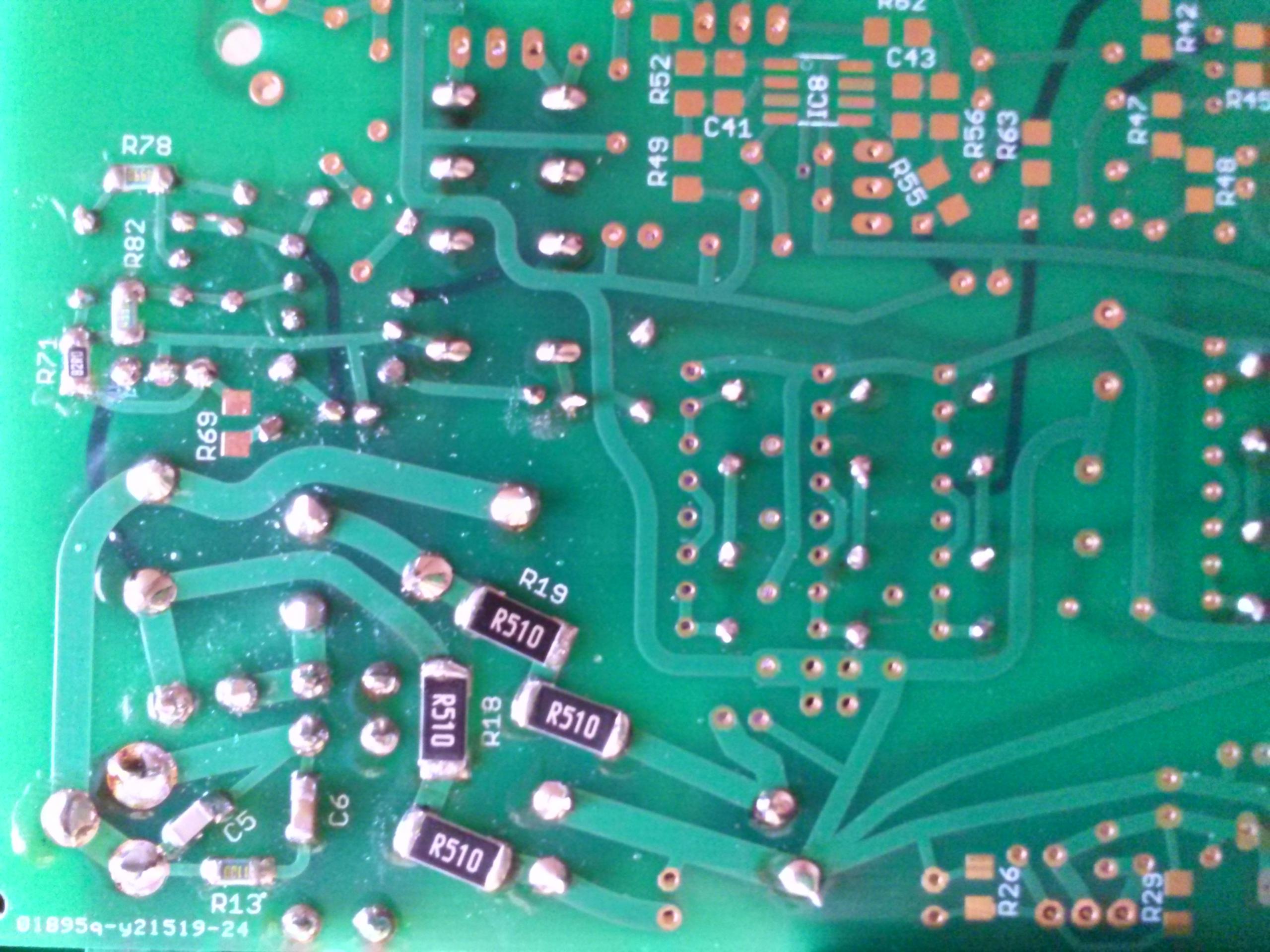

Well I just found my first mixup...no power Yahoo, but FYI there are three sets of SMD resistors that are very similar if your not careful identifying...I just had to remove R78 and R82 which wasn't as bad as I thought it would be...at least the parts didn't go flying across the floor and they weren't hurt in value removing them..
So: R78 and R82 are 499K Relay delay resistors
R8 and R12 are 499 ohm 4x gain resistors
R42 and R43 are 4.99K input bias gnd resistors..
So...its easy to overlook and pick the incorrect ones!!
even checking with a meter before and after installing I missed this.
I was identifying the remainder resistors and labeling them with there respective R numbers and came across 2 that I thought I had already installed!!
oh my.....64 yrs old and half blind...
