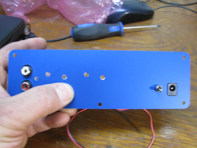

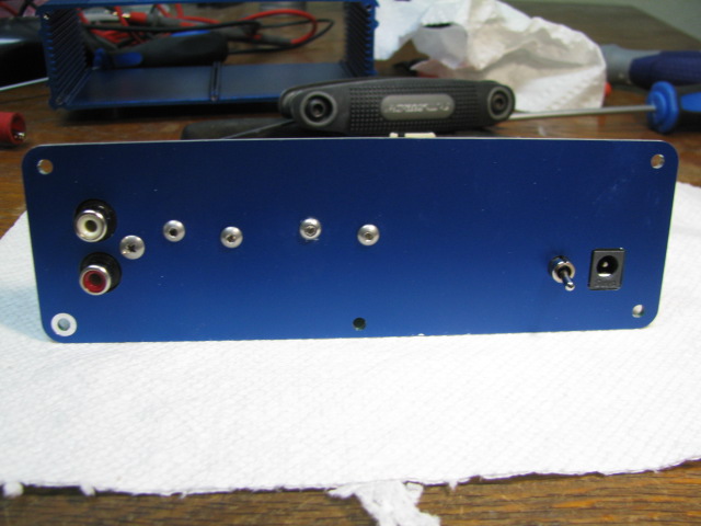

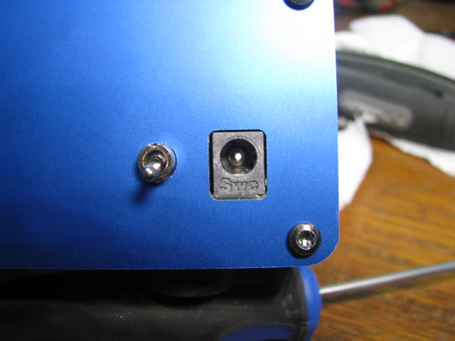

The rear panel arrived from Front Panel Express today. It fits perfectly! I nailed the measurements. 😀 So go ahead an use both the front and rear .fpd panel CAD files, and the measurements spreadsheet with the raw measurements for self-drilling, out at the Google Drive link in the "panels" folder.
Here are some photos of the panel and attaching it to the four voltage regulators with the TO-220 insulators in the BOM. I've gone up one notch on the camera here for some better resolution.
* The first photo shows the panel as it came in the box from Front Panel Express. I've never used these folks before. I'm impressed with how they have it packed. For this particular panel to test the measurements I did not add any text labeling to the panel. The one out at the Google Drive link does have the text added.

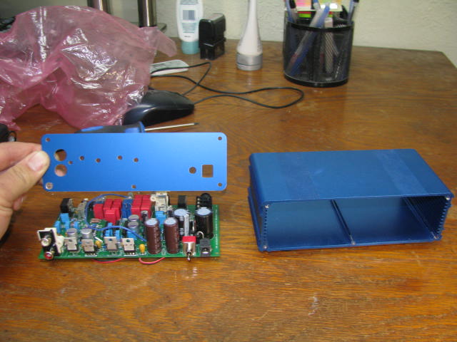

* Next shows the panel, rear of the ODA, and the B4-080 case. The panel used the "blue" anodization option in FPD. The the shade of blue matches the B4-080 reasonably well.
* Next is the panel over the switch, power jack, and RCA jacks showing the alignment of the voltage regulator holes with the panel. It fits! When you solder in the regulators make sure they are all the way down on the PC board. Then everything will line up fine like this. Notice that the on/off switch acts like a locator on the right of the panel and the RCA jack mounting screw hole is a locator on the left.

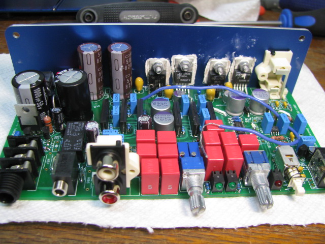

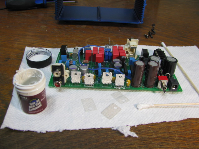

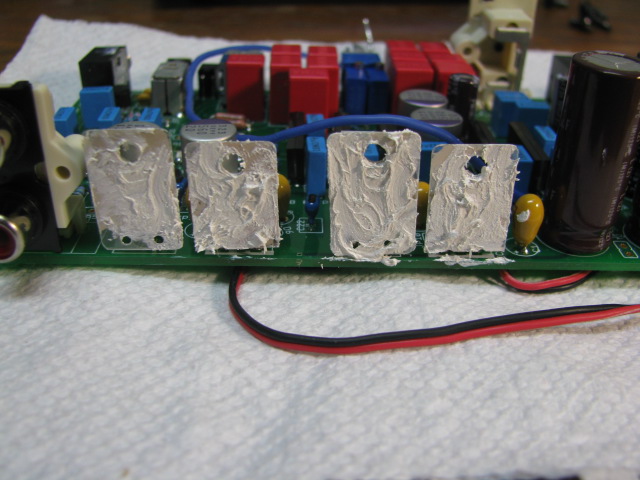

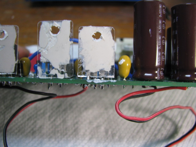

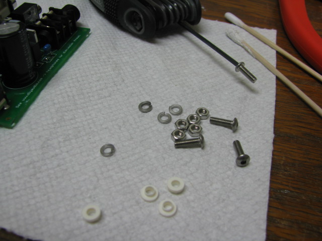

* The next 4 photos show how the heat sink grease and mica washers (from the TO-220 mounting kits in the BOM, one for each regulator) are attached. First just smear some zinc oxide heat sink grease over the tabs on all 4 voltage regulators.

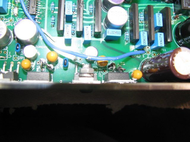

In the second photo here notice how the standard mica washer is too long and hits the PC board. This is by design. The regulator leads have two sizes. By pushing it all the way down until the larger size hits and is flush with the PC board like this you will get the same exactly height for the regulator hole every time. Easy. If I left the LM317/337 leads long to match up with the greater height of the LDO voltage regulator tabs it would have become hard to get the height correct. The next shot shows how I've just snipped the bottom of the mica insulator above the 2 holes using flush cutters. Then the final shot shows the mica insulators stuck to the grease on all 4 regulators, the holes in the mica lined up with the holes in the regulators (tip: stick the tip of needle nose pliers in to line them both right up) then more grease applied to the outside of the mica washer where the back panel will mate.
Note that the tabs on the LM317 and LM337 pre-regulators are also half as thick as those on the LT1963A aqnd LT3015 LDOs. The LDOs sit higher because of the 5 leg arrangement. The difference in tab thickness is why I have 10mm long bolts in the mounting kit. 8mm would be OK for the thinner tabs, but not for the thicker LDO tabs.
* The next three photos show attaching the hardware and nylon insulating washer from the TO-220 mounting kit. The kit in the BOM comes with 4-40 hardware. With the mounting kit I have in the vendor thread you can toss the 4-40 bolt and nut (keep the mica and nylon washers of course) and use the stainless steel button head stuff (what I'm using in these photos). The button head bolts take a 2mm metric allen wrench. That one I'm using in the photo is a set that is $2 at Harbor Freight tools here in the US. Most hardware stores have something similar. Be sure to get the metric allen wrenches though.
The first photo shows the pile of parts. Next shows one fully assembled with the bolt through the panel and the insulating washer, lockwasher, and nut on the other side. I find it is handy to keep a finger on the nut and washers on the back to push them against the panel (and the insulating nylon washer properly through the hole), then screw the bolt from the front. Keep the nuts jsut hand tight until all 4 are in, then put some needle nose on the nuts and tighten them up a bit - but not too much, don't want to punch through the mica washer. Just slightly firm.
Finally I do a resistance check between the panel and the tab to make sure everything was aligned properly. Interestingly enough, if you measure between the panel and the bolt you also may register nearly open, even though the bolt head touches the panel. That is due to the insulating properties of the blue anodization, which is why I have that lower left case screw corner slightly countersunk. That cuts through the anodization to provide a good electrical connection to ground the panel.

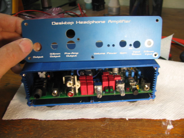

More photos of attaching the rear panel and inserting into the B4-080 case.

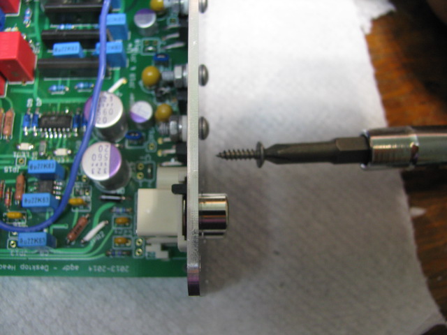

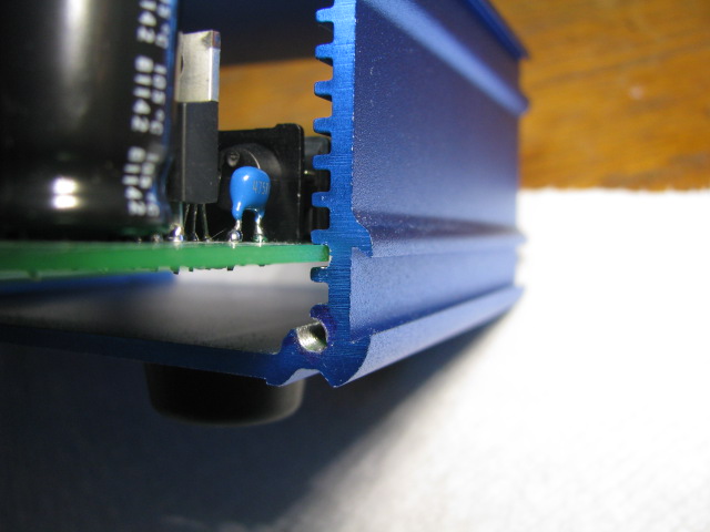

* The first photo shows the last remaining screw in the rear panel, the #4 truss head screw that comes with my mounting kit, which screws into the nylon RCA jack through the small hole in the panel.
* The next two photos shows both sides of the entire completed rear panel. 🙂 I've wiped the excess zinc oxide grease from the outside of the rear panel, but probably won't bother with the inside.
* The next photo is a reminder that the ODA board goes in the second slot up from the bottom. That is because of the extrusion that runs down the center at the bottom for the bottom center front and rear panel screws. So there is actually a pretty good amount of space in the ODA between the bottom of the board and the bottom of the case. Along with mounting the ODAC above a board in the case top slot, you could probably wrap one up and put under the PC board, as folks have done with NwAvGuy's O2 headamp. I would recommend the board in the top slot approach though to keep the noisy digital stuff on the ODAC far away from the sensitive analog ODA parts.

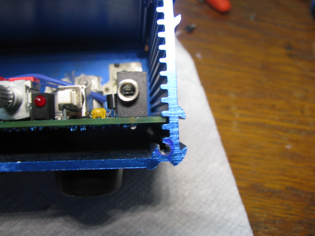

* The next photo shows the amount of space I've left between the sides of the case and the parts and traces on the PC board. 3mm to the parts and 5mm to the traces to stay away from side extrusions on the case. I probably overdid it if anything from the looks of things here. 🙂 That was a reaction to NwAvGuy not leaving enough space to the sides, and especially to that case rail under the edges of the board (that part leads shorted against if not trimmed close). No chance of that happening here.
* The next one just makes me smile. What are the odds of getting that spacing measurements around the DC power jack that even? 😀 I really like the way this has turned out, to have that jack forward and through the rectangular panel hole. Looks more professional and zero chance of the power adaptor barrel touching the panel.

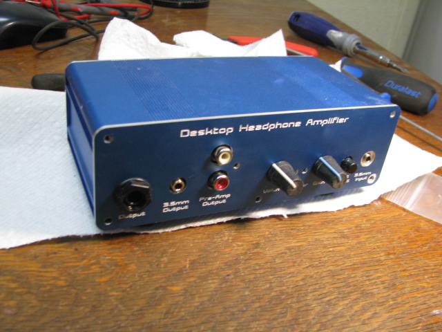

* The final 3 photos show the front panel installed. This is a front panel I had left over from the previous ODA version. Fits since no changes have happened to the front of the board. The first photo is without the knobs and nuts installed. The next photo has the knobs and nuts. I'm doing some sleight of hand with my finger here. Normally the truss head screw into the RCA jack (pre-amp out here on the front) would pull those jacks forward and flush against the panel. Since the screw is out I'm doing it with my finger for the photo. The final shot shows the cover off.
Remember how the whole grounding thing works here from the previous ODA version. I have the holes around the 3.5mm input jack and the lower right case screw countersunk to cut through the (insulating ) blue anodization. The 3.5mm jack nut then single point grounds the panel when installed, The lower right case screw single point grounds the case to the panel. Then in the back the similar case screw does the same for the rear panel. Just like that you have a real Faraday cage with minimal circulating ground loops. 🙂
The output jacks don't touch the front panel on purpose (the 1/4" is plastic for this reason). As far as the headphones are concerned the ground terminal on either jack is their ground and not the system star ground in the power supply section (although the output jack grounds do direclty star ground to the system star ground point - keep reading). The tiny difference this makes figures into how I managed to get the DC output offset so low. In the layout you can see that the DC output offset null circuit is the one thing on the board that does not reference back to the system star ground directly, but rather tp the headphone jack ground terminal before it in turn stars to the system star ground. That is because the headphone currents gonig back to star ground can cause 500uV or more drops across the PC board traces that would add to the DC output offset, and we are shooting for lower than 100 micovolts here. By referring the DC output offset null circuit back to the output jack ground those trace drops are moot and you get super low output DC offset numbers. Low enough to read "0Vdc" on a DMM that has only 1mV minimum resolution on its Vdc range.
Back to the panel, that is also why the large hole around the 3.5mm output jack, to make sure it does not touch the panel. Again no smoke or sparks if it did, it would just negate a few 100's of microvolts of DC offset nulling abilty.
It is less of a big deal if the shafts of the volume pot or gain switch touch, but I've left a fairly big hole around those too.
