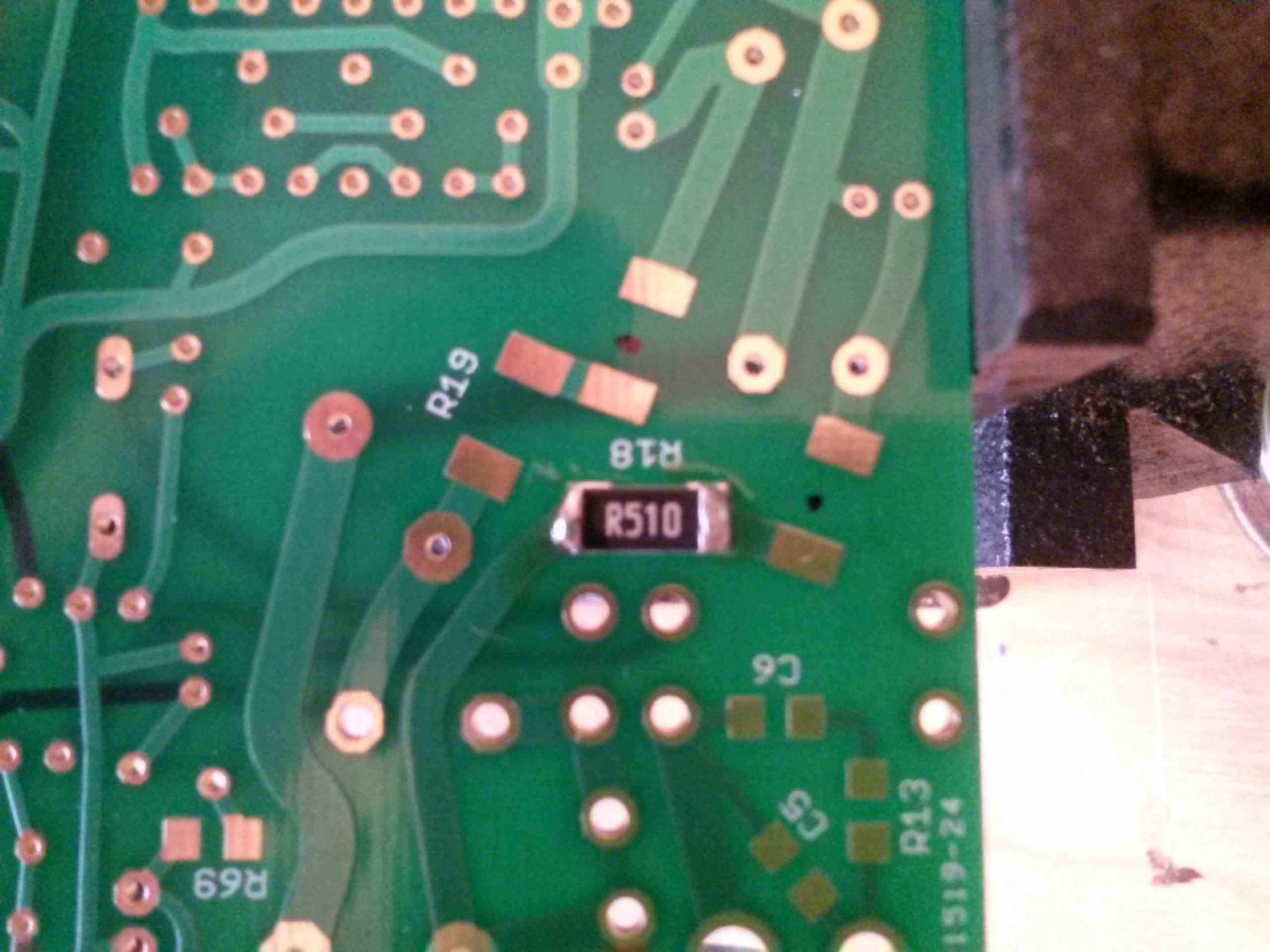

First .51 ohm R18 in place!!!
Alex
Alex
Hey you are on your way! :D Good soldering work on that resistor too.

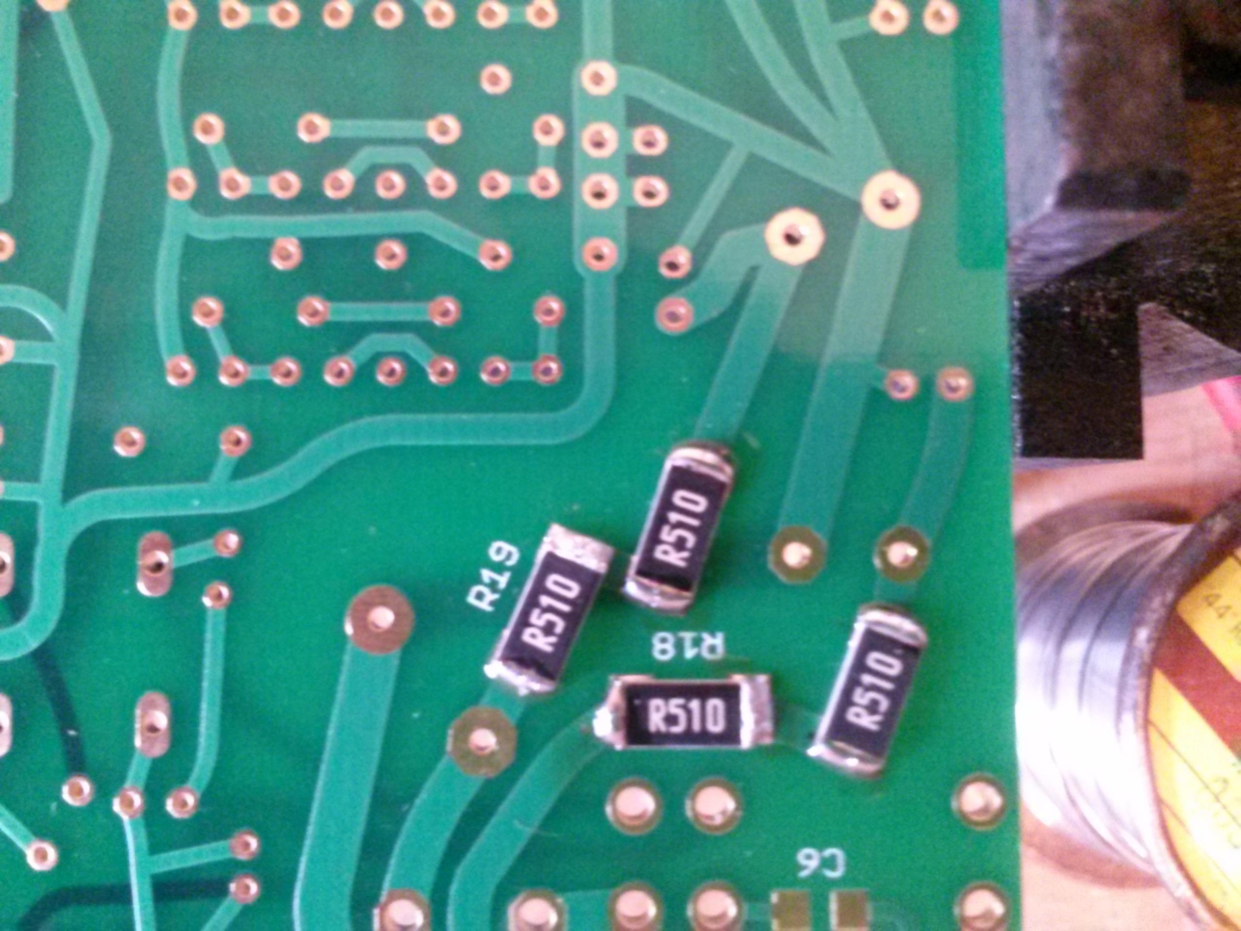

Looking good with those four resistors! Now everything gets a little smaller (1206 sized) from here. :D
Ok time for a break...
Those small 1206 parts are indeed a challenge.
Advice is GO SLOW...and recheck joints...I measure the values from a point away from the part if a resistor....just to be sure.

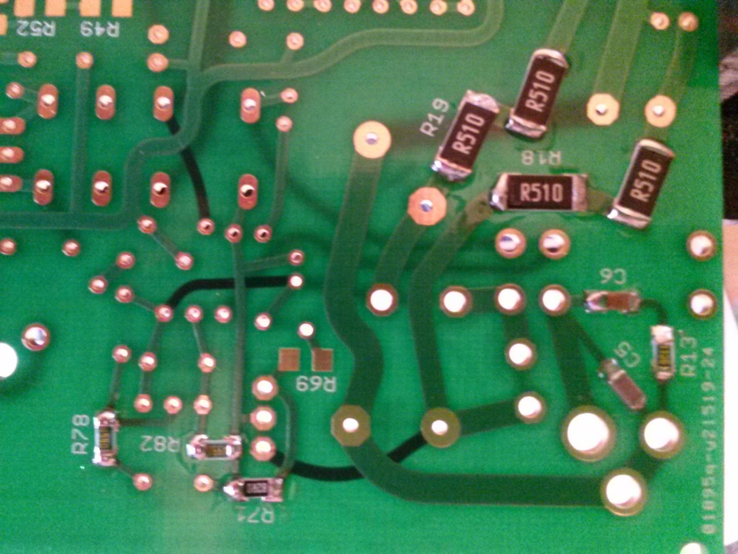

Ok finally got to solder some of those SMD 1206 parts!!!
They are an eye test for sure.
Its even a pain to get them out of their packaging!!!
Advice" GO SLOW and recheck your joints....have to use my most powerful WalMart 3x readers!!
LOL
Time for a break or a beer!
Sorry for the crappy focus, its my shakey hands an phone!
Alex

In Step 1 of the Build Instructions indicate R13, R16, R19, R20, R21, R71, R78, R82 , C5 and C9.
I think C9 was meant to be C6, the snubber cap?
Alex
Yep, another good find! Fixed. I just re-posted the build instructions at the Google Drive link. I know how it happened. The text on the parts under the board is mirrored on the layout, so C6 looks like C9. :) I was onto that though and used the actual layout editor rather than the PDF image for most of the build instruction editing, so I could call up the part name directly and make sure I wasn't reading it backwards. But I definitely missed that one.
