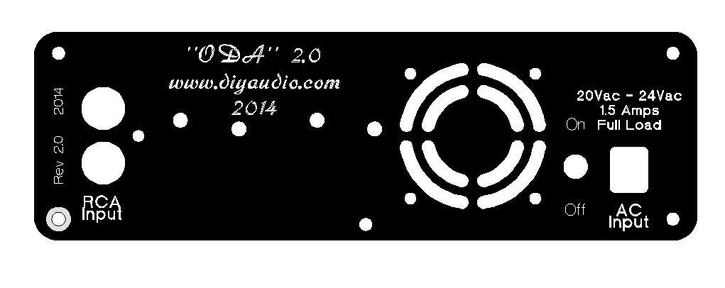

well mounting a fan inside the box isn't an option so the only option would be to mount it outside, but then you loose on the esthetic, another option is to change the box for a taller one, but then you lose on portability, so passive vent is a compromise i think.
If you want the passive ventilation to have any real effect you need to pay close attention to where you place the in- and outlets. I don't know how much energy those four devices at the back need to dissipate, but by making large cut-outs in what is effectively a heat sink, you might actually make things worse.
I'm sure agdr is much more experienced with applied thermodynamics than what I am, so I won't make a fool of myself by making any suggestions.
On a completely different note. In the drawings and pictures I can't seem to find holes providing for an ODAC with standoffs. Have this been considered?
There appears to be room enough.
adgr - Your 100% right, the metal case will dissipate the heat but only albo 50% of it becouse of the fact of a closed box, a lot of the heat will still sit inside generated over time of use ( and they're only generated by the Vreg's at the back ), so placing a passive vent on the metal back plate of the panel will drop the inside box temps really well, where the back panel temperature will drop only a little bit, but the vent will allow to dissipate that heat using air circulation rule, where the hot air goes up and the cooler stays down,
Infact you dont need to place any inlets in the case, becouse of this fact, as You dont need to cool the entire PCB, only dissipate the heat from the back panel, and dont let it build up in the case itself.

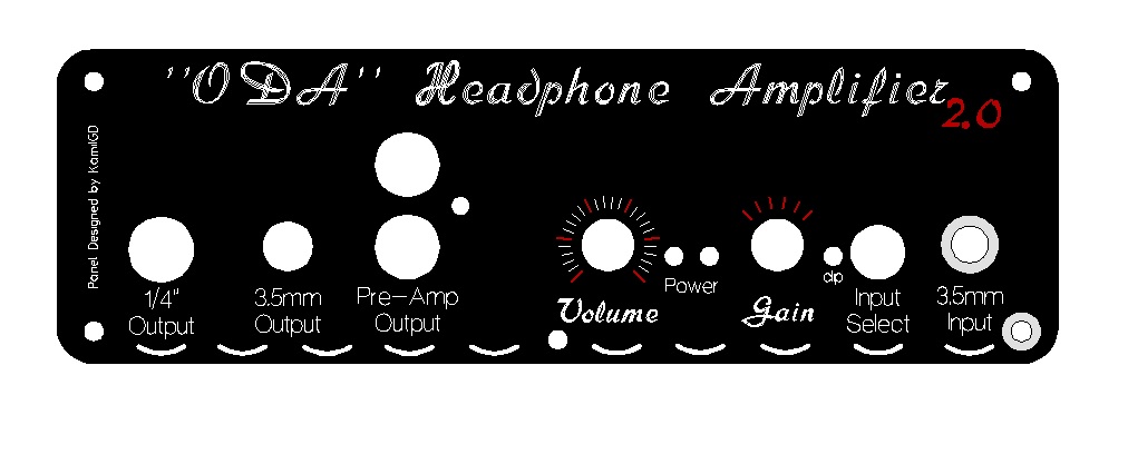

well after some thoughts i came up with such an design, still isnt 100% final but brings me few other ideas, like outside radiators mounted to the backpanel, but i need to find some nice looking ones.
Will keep updating this for you.
Kamil

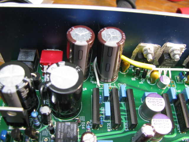

Hey good work guys on the panels and thermal considerations!
I did a surface IR temperature measurement on the O2 amplifier back panel, with a modification I posted a couple of years ago, that mounted the two O2 voltage regulators on the back panel. The temperature drop-off with distance past the regulators on each side was significant. I didn't plot it but looked like it was the typical Gaussian curve distribution. I've only done "finger measurements" on the ODA since it only gets in the warm range, not really super hot, and it feels the same. Most of the dissipation is right around the 4 regulators with pretty quick drop off after on either side. Plus in this case there will be some heat transmission to the case along the edges and mounting screws.
Good thoughts on the fan - or passive - hole blocking heat flow. Adding cross-links perpendicalar to the hole, like kamilgd has there, is probably a good idea to help the heat flow. In this instance though since the area around the hole will be cooler due to the fan air flow and/or convection air flow, I'll take a guess that things will pretty much end up a wash. Any blocked heat flow traveling sideways through the panel will more-or-less be made up by lower temperatures around the hole. If the regulator area was getting much hotter than it does then that probably wouldn't be the case, but with the current dissipation levels it should be OK.
Yeah, that back panel will radiate heat in both directions, outside the box and inside the box! A passive - or fan - vent hole is just a really good idea. The output chips dissipate quite a bit of power too. The passive radiator is an excellent idea also. The place to put it would be just below that row of 4 holes for the regulators. Something like the typical small TO-220 heat sink here:

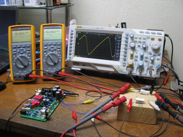

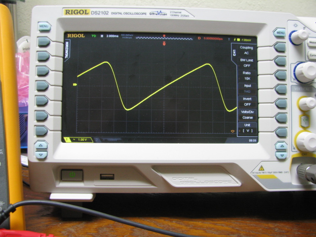

16Vac 2.4A vs. 16Vac 1A transformer for +/-12.5Vdc rails
Here is the verdict about which transformer is needed for the new +/-12.5Vdc "standard" power rails in the ODA - it is the larger 16Vac 2.4amp WAU16-2400 unit at Mouser. Their 20Vac 2A transformer could be used too, the WAU20-2000, but they have that priced at nearly double for some reason. The back panel would also get hotter with the 20Vac unit since that extra 4Vac would all be burned off by the pre-regulators.
BTW, I forgot to say in the previous post where that extra 0.5 volts in the +/-12.5Vdc power rails comes from. That really is not an attempt to just one-up NwAvGuy's +/-12.0Vdc power rails in his O2 headamp. The inline SIP package of the NJM4556AL chips is rated at 100mW more, 800mW, vs. the DIP8 package (NJM4556A) at 700mW in the O2. So that extra 0.5 volts is using 20mW of the extra 100mW package power dissipation in each chip from quiescent (idle) current, leaving 80mW more for signal output per chip.

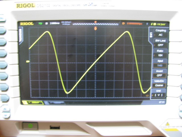

Below are some tests on the power transformer at the output of the CRC section. This is actually Alex's board under test here, after I converted it over to the new BOM parts. I asked Alex to mail it to me a few days ago since he already had his parts installed. I have a Hakko 808 here that can suck a golf ball through a garden hose. The parts that have been changed are the relay from the 48Vdc coil to 24Vdc, the D16 zener from 43V to 19V, and R70 from 3.01K to 1.47K
* The first photo shows the WAU16-2400 (16Vac 2.4A) on the left and the WAU16-1000 (16vac 1A) on the right. The blue wires I have soldered to the ODA board are just hooked to the outputs (JP8, JP9) and ground.
* The next photo shows the test setup with 33R load resistors on each power supply rail. The result is around 17Vdc / 33R = 510mA That comes from the maximum current output of the 6 op amps on each channel, 320mA, converted to rms which is 226mA (rms). Multiplied by 2 channels, plus about 60mA total quiescent current from all the chips gives (2)(226) + 60 = 512mA.
* The next one is a closeup of the scope in the above shot, which is using the smaller 16Vac 1A transformer. That is 500mV/div with the scope AC coupled, so we are looking at about 3.75V of ripple riding on top of the voltage.

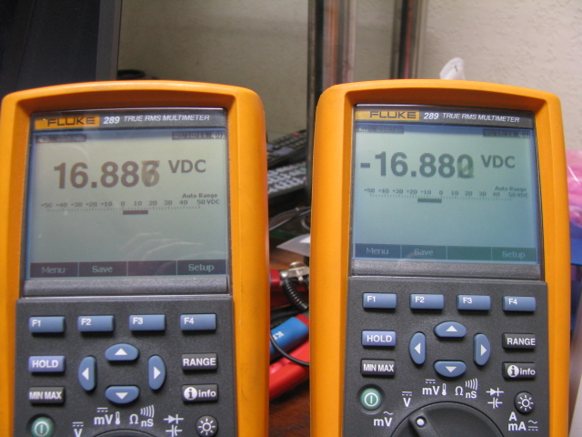

* Next is the true RMS voltage on each rail, about +/-16.8Vdc. The true RMS value would be right in the middle of that fairly symmetrical ripple waveform above, so the bottom of the ripple would be this minus 1/2 of the ripple, or 16.8V - (3.75V/2) = 14.9Vdc. Already we have a problem. The output of the pre-regulators is set for 14.5Vdc now, to leave 2Vdc across the LDO chips producing the +/-12.5Vdc rails. The data sheet on the LM317/337 chips recommends a minimum of 3V drop to stay out of dropout, but experience recommends more like 5Vdc drop. But with these readings we would get only 14.9Vdc - 14.5Vdc - 0.4Vdc, which would put both pre-regulators into dropout. So the 16Vac 1A transformer is a no-go. Now keep in mind with a lighter load the transformer output voltage will rise several volts, but this is the worse-case testing under maximum load which is the limiting factor.

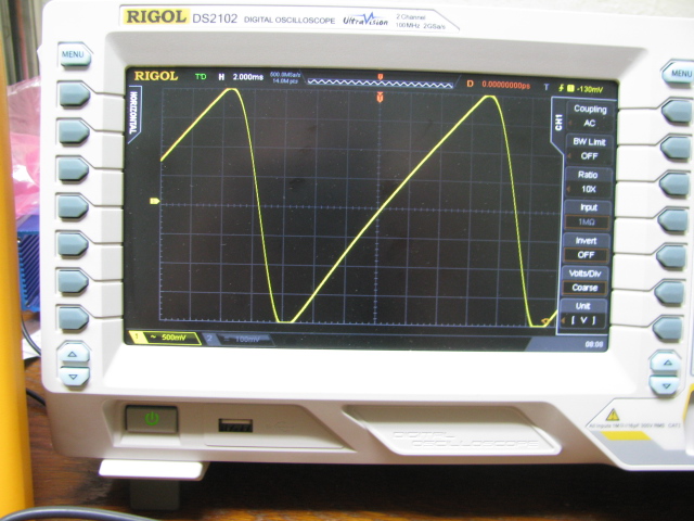

* Lets try again with the 16Vac 2.4A transformer in the next photo. This just shows the thicker supply lead from the beefier transformer.
* The scope shot and true RMS voltage readings are next, still with the 16Vac 2.4A transformer. Looking much better! The true RMS voltage is now all the way up to +/-19.8Vdc. Backing the scope down a range to get an accurate reading on the wave tips gives about 4.2V of ripple, or 2.1V for half. So now the voltage across the pre-regulators during the ripple minimums (at the absolute maximum load condition here) would be (19.8 - 2.1) - 14.5 = 3.1Vac = no dropout, as per the datasheet numbers. Now keep in mind this is full load continuous testing, which would never happen with real music coming out. Maximum load peaks like this are intermittant, giving me my preferred 5Vdc across the pre-regulators. So QED as they say in math class, 16Vac 2.4A is the transformer to use.

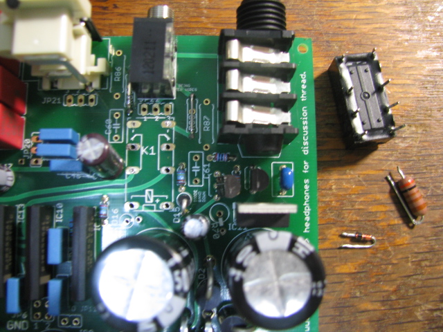

* The final two photos show the old parts after being extracted from Alex's board, then with the new parts installed. The only part that looks any different is R70, the relay circuit voltage set resistors, which is smaller.

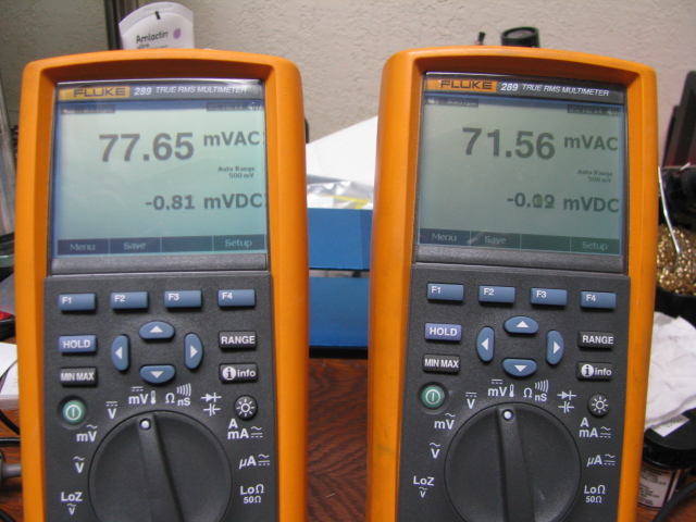

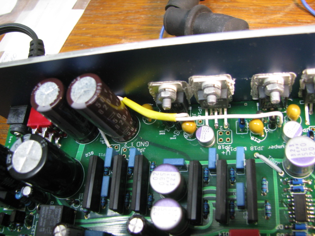

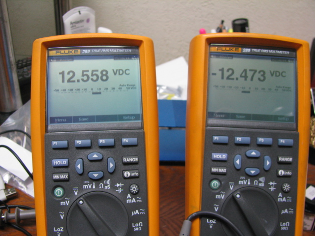

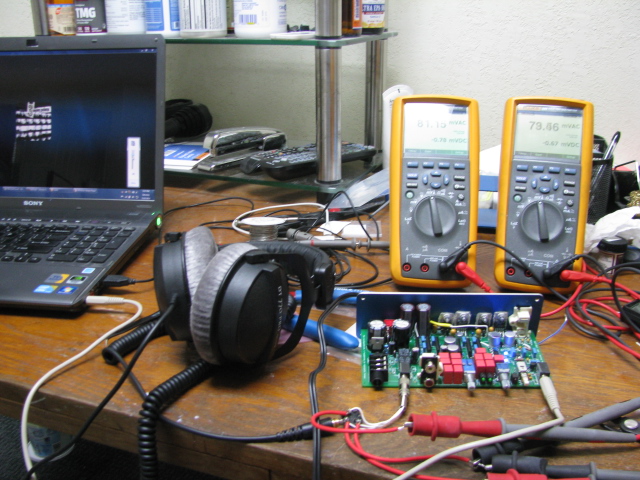

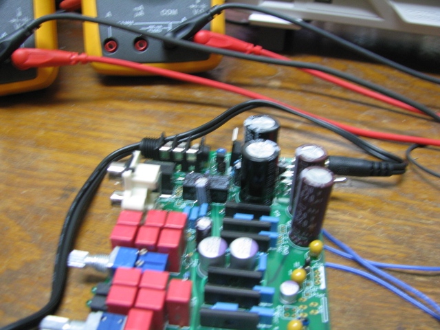

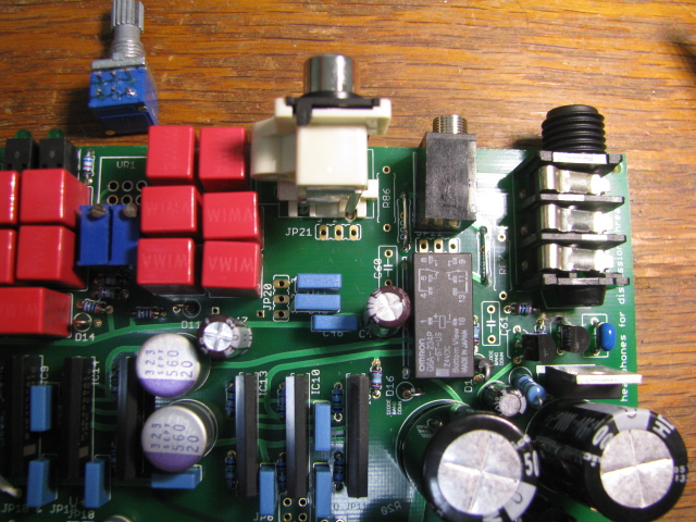

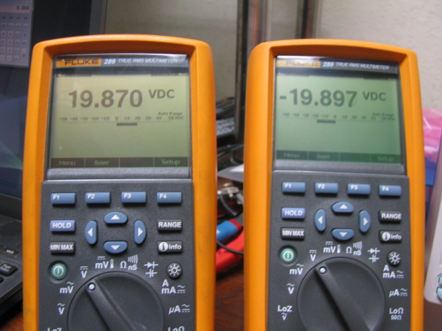

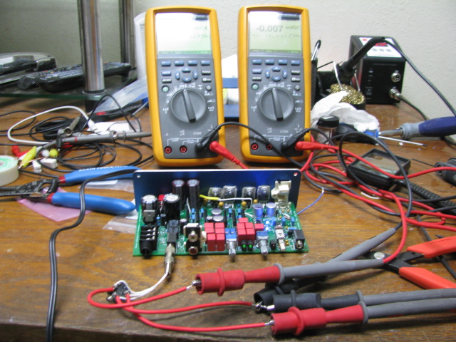

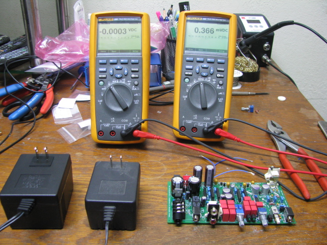

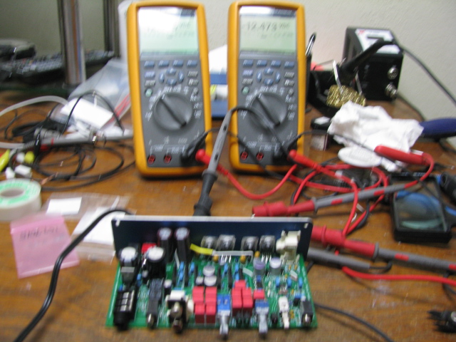

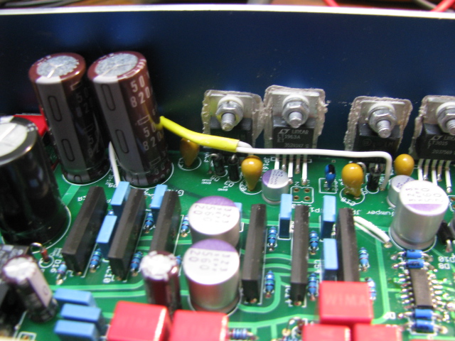

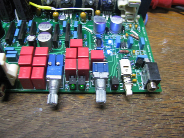

Alex's ODA works!!
I've just completed the rest of the power supply section on Alex's ODA, powered it up and... it works!! A big congratulations goes out to Alex on his build. Only one small mistake I see so far. The output levels are different on the 3rd gain switch setting so a gain resistor was put in the wrong place there. But out of this whole build that is trivial. GOOD JOB ALEX!
The back panel is just moderately warm around the voltage regulators (using the 16Vac 2.4A transformer here). That is just sitting here on the table, not even screwed onto the rest of the aluminum case which would heatsink it further. The Beyer DT770's I'm listening to it with right now are not much of a load though, as the photos below show. I would suggest waiting before you bolt any additional heatsinking on the back of your ODAs. You will probably find it not necessary, although I do think it looks kind of cool! Might want to do it just for looks. The vent hole is a very good idea and will get added to the rear panel CAD. Unfortunately that will also raise the panel cost. It looks like FPE charges $1 a hole or such.
I've also swapped the pot in Alex' build for the new 1K linear.
The photos are...
* I appologize for the blurry first one. This is the test setup for measuring the power supply voltages before the disconnects (JP18, JP19) have been connected to power the rest of the board. You can get the general idea. The 4 voltage regulators have been soldered on, mounted to a back panel, and the connection jumpers from the CRC section to the power section added (JP8 -> JP10, JP9 -JP11), Alex, I used some (yellow) sleeving over part of it to make the wires a little neater, as the next 3 photos show.
* The next one shows the power supply output voltages. We are shooting for +/-12.5Vdc and actually have +12.56 and -12.47. That is just fine. I've put the R33 and R36 positions in the power supply section specifically so folks can tweak that further just as much as they want. The references voltages built into the voltage regulators have a +/-tolerance, so there will always be a tiny amount of variance.
* Two green power LEDs in the next one.. it lives! I measured the resistance to ground on the two power supply rails after the disconnects first, before jumpering them, just to make sure nothing was shorted on the rails. Then I had DMMs on the rails when I first power up, after jumpering the disconnects, to make sure the power rails were OK.
* The next two photos show the typical setup for measuring the DC output offset, along with the results after adjusting the trimpots. 2uV (microvolts!) on one channel and 4uV on the other. I didn't take a picture of the intial power-on numbers before adjusting the trimpots, but one started out at about 140uV and the other at about 60uV. It took about 4 turns of the 25 turn trimpot to zero the first one out and 2 turns or so to zero out the other. Thermally they only drift about 15uV or so over time from the set point. Keep in mind NwAvGuy's O2 typically has 3000uV of DC output offset, so even if you adjusted nothing (if your DMM doesn't read below 1mA) you would still have 3000uV/140uV = 21 times lower DC output offset than the O2.
* The last two are Alex's ODA powering my Beyer DT770s. Not much a drive challenge though, just 77mV(rms). These are instantanous readings now, so they jump around all over the place with the music.
A fun first thing to try with any new ODA is pull out the input cable and flip the input select switch out so you get the grounded 3.5mm inputs. Then turn your volume control all the way up and your gain switch all the way up, then have a listen for any background noise. It is quiet out in space.. Don't forget to turn your control back down before listening to music.

Great, I am really glad the board works, at least no caps popped or smoked!!
I really enjoyed the build process and soldering, even the tiny SMD parts and IC's.
I did center the pots before I soldered them into the board...looks like it didn't take much to get them adjusted.
I am wondering about the gain resistor, haven't looked at the schematic for the values that I must have gotten mixed up but like you indicate its a easy fix. What I am wondering is if I indeed mixed these up where I put the correct gain resistor!!!
The heat-sinking looks like its probably not really needed, but it would look "cool" LOL
Looking forward to listening comparisons to the O2 across a wide variety of headphones in the neat future.
Thanks for all the help and assistance.
Alex
Alex
Well your build job is back to being 100% perfect. I just did some measurements and the problem is a bad rotary gain switch. That one particular contact in the 3rd position isn't working. I'm sending a Mouser order out on Monday anyway so I'll get one and swap that out. The Hakko 808 rocks for getting multi-legged things like that rotary switch out without any damage to the part or PC board.
