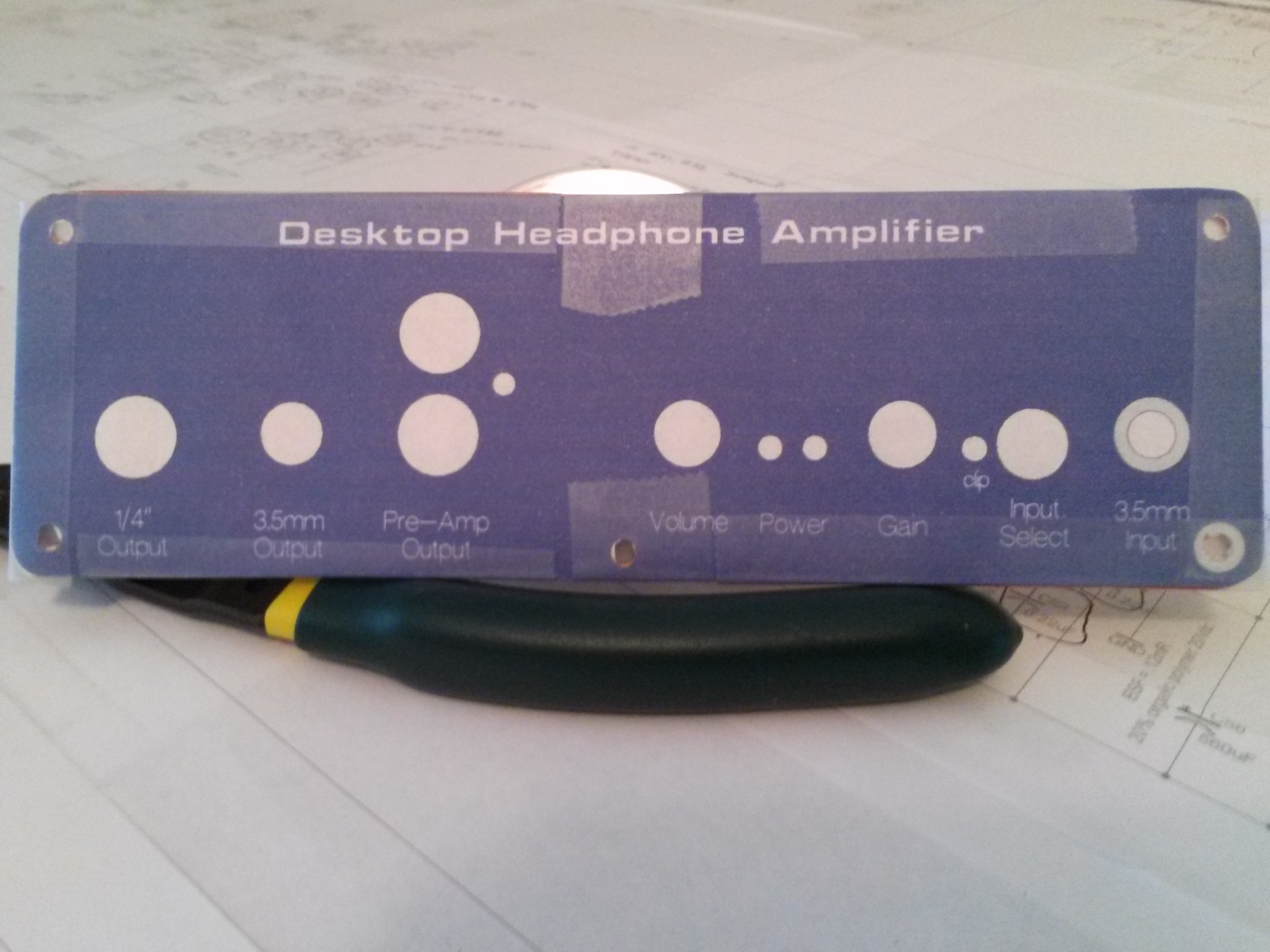

Ok...
Getting ready for the drill press and drilling out all the front panel holes....simple tape the panel layout agdr provides at the google docs link....print out with a printer and cut and use the 5 holes for alignment.
Then I will carefully punch starter holes with a metal punch and use a small diameter drill to start the holes one at a time.
I start out smaller and enlarge slowly in drill size and checking the fit to the board in the enclosure...
I will post final pix when I am done.
Alex
Yup...I don't show the center lines in the picture, but have them on it now and will use them. When I did my O2 panels even with the drill centerlines and a punch I still had to file somewhat by hand to get the shapes of the micro-usb openings to mate well.
Its a patient and time consuming job for sure.
I am more worried about how to letter or label the various items....thinking..
Alex

Pilot holes have been drilled!! Fairly easy so far....
When I get the board I will finish up to custom fit etc....just in case I need to make an adjustment!! LOL.....can u say "file"...
From reading the post about not having the jacks touch the front panel I need to make sure they don't touch the front panel.
Alex

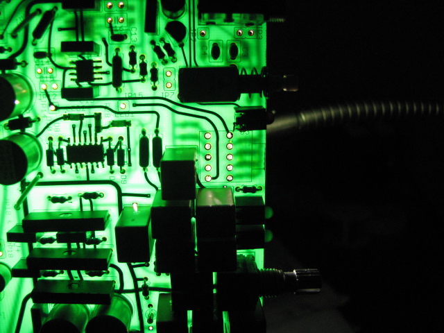

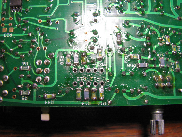

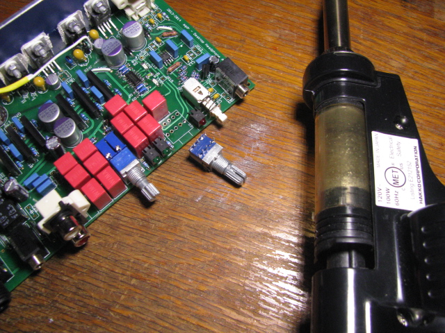

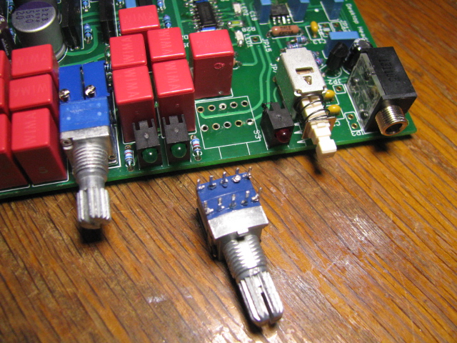

I had to share these photos of removing the defective gain switch on Alex's board with the Hakko 808. I just can't recommend this tool highly enough. If you are looking for something to drop hints about for Father's day, may I suggest... :p
From the first three photos you can see that all 10 legs were sucked clean of solder. No damage to the part or to the PC board pads. Even the nearby SMD resistors on the back were spared. Try doing that with solder wick and watch what happens. With wick the best shot is break the part open with pliers or a Dremel, or cut it off at the legs if possible (this works well with SMD op amps), then remove the legs one at time with wick and needle nose pliers. With the Hakko 808 the whole thing is done in about 2 minutes.
That photo of the board with the light behind it just shows that the holes are nice and clean too, ready for the new part.
That beige barrel on the 808 is spring loaded and pops right off for cleaning. At the end of the barrel there is a replaceable ceramic filter and replaceable aluminum "splash plate" that I change after every 20 desolderings or so. It also comes with spring steel cleaning wires to run up the barrel if needed. If things really get stuck they have hand-twisted drill bits for cleaning the nozzle out. I've never had to do that yet. In fact, pretty much every part on this thing is available from Hakko for repair.
I'm kind of a tool freak.:) I really appreciate running into a well built tool like this that does a job 110%.
Ditto on the Hakko 808. This tool has saved hours (days?) of production time in our facility.
