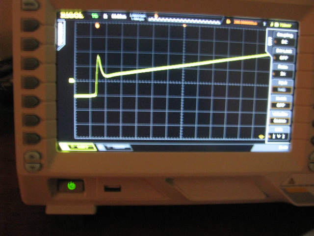

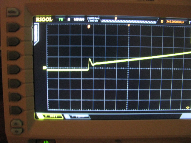

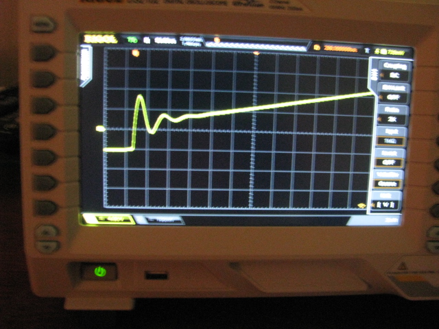

I've had a chance this weekend to make a test I've been wanting to for awhile. Tuning the ODA's snubber for the specific transformer being used, now that the WAU16-2400 is the pick for the standard +/-12.5Vdc power rails. Turns out changing the 110R resistor to 52R will result in being closer to critical damping with this specific transformer.
Details:
The snubber in the ODA comes right out of Hagerman's famous paper:
http://www.hagtech.com/pdf/snubber.pdf
0.01uF (C5) to lower the ringing frequency, then the series 0.068uF + 110R pair (C8, R13) to damp what is left.
The rest comes out of Mark Johnson's excellent Quasimodo thread:
http://www.diyaudio.com/forums/powe...sformer-snubber-using-quasimodo-test-jig.html
As mark points out, a person could go to a lot of effort and math measuring the leakage inductance of the specific transformer winding and plugging it in the equations. Or...simply replace the 110R with a pot, as Mark did, and adjust for critical damping. Then read the value off the pot. Simple and easy! In my case I used a 500R linear 25 turn taper. I think Mark used a 1K in his writeup.
My appologies upfront for the fuzzy photos below. I should have had the room lights on instead of just relying on the scope screen's brightness.

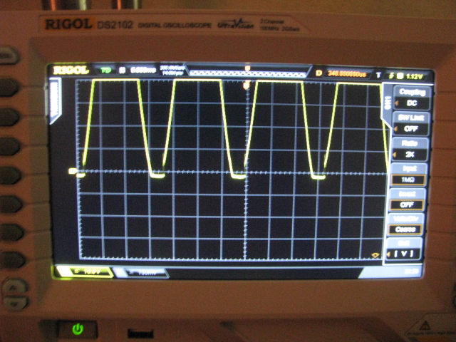

The scope is across one of the ODA's power rectifier diodes, D1.
* The first photo shows the transformer's secondary leakage inductance ringing in the lower right corner of each half-cycle, that small part that fades out at this level of resolution. This is with the orignal 110R resistor.

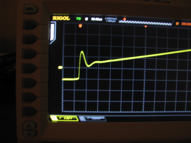

* The next photo is a closeup of the ringing with the scope's timebase stretched out. This is still the original 110R resistor. I can see the ringing dying out after one cycle. Not bad, but we can probably do better.

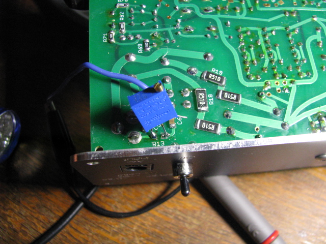

* The next photo shows the test setup, with the 500R linear trimpot soldered onto the SMD pads where the 110R R13 used to go. The blue wire is going to the end-munted end of D1 for the scope probe. I pre-set the trimpot to 110R on that side so it would start out the same as the original resistor. I've soldered the pot directly on the board like this to keep from introducing any additional inductance or capacitance from using wire leads.
* The next waveform shows pretty close to critical damping at 52R. For each of these I unsoldered the pot, measured it, then soldered it back in. Note I've increased the vertical scale on the scope from the first two pictures to show the ringing more clearly.

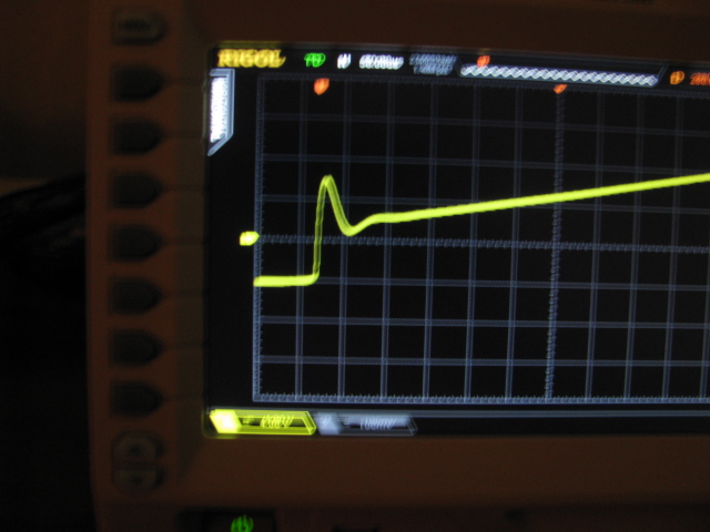

* The next waveform is with the pot in the other direction at 190R. Clearly we have ringing! I count three cycles before it damps out.
* Next I just turned the pot until the waveform was damped inone cycle and measured the pot: 102R. Nearly the same as the 110R.
* The final waveform is back to the original 110R resistor.
If you use a different transformer than the 16Vac 2.4A in the BOM and have access to a scope, just use this procedure to tune the snubber. I would suspect though that most transformers in this general voltage and amperage range will be snubbed adequately by something in the 52R range. 51R or 49.9R would be standard values.

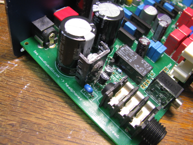

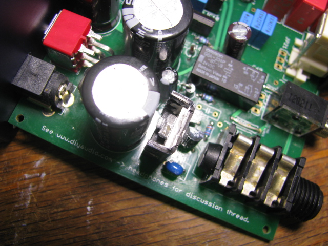

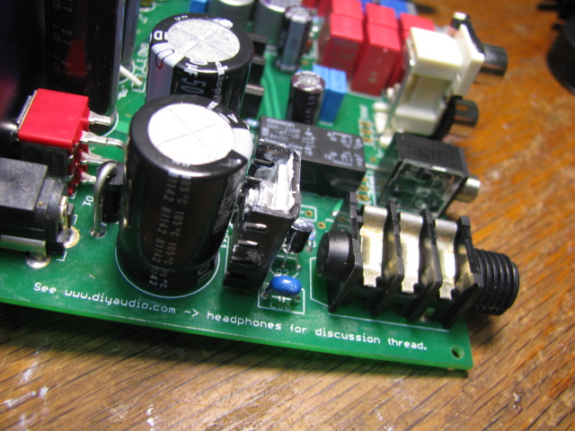

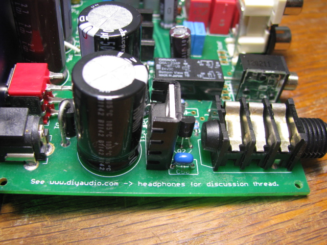

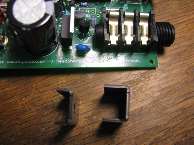

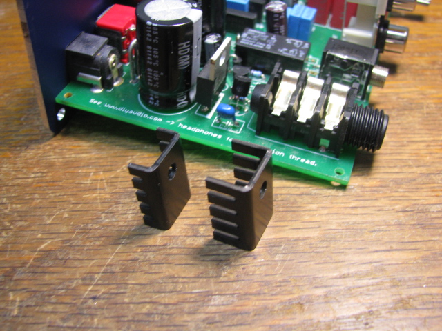

Heat sink for IC11
kamilgd - that transformer is a nice find! Very compact. At that size it may very well fit inside one of the box enclosures cases, but I would still recommend putting it an a separate case from the ODA. Less chance of magnetic fields coupling into things. Essentially just wire it up like it is a wall transformer, with the power cord in one side (fuse highly recommended) and a cord with a 2.1mm barrel plug out the other end. I see those pre-molded 2.1mm cords with stripped leads on the other end available at a bunch of places.
Alex - my package from Mouser arrived today with a big pile of assorted TO-220 heat sinks. Below are two candidates that will work. The only difference between the two is the length of the side fins. The one with the shorter fins is an Aavid Thermalloy 577002B00000G, Mouser # 532-577002B00. That is the one I'm going to be adding to the BOM. I've secured it with a M3 (metric 3mm) 6mm long stainless button head bolt and nut from boltdepot.com. Going forward I'm going to include both in that ODA hardward kit with the other other screws. For now I'll send the heatsinks and bolt/nut out no charge to everyone building the V2.0 ODA right now.
The other heat sink with the longer fins is an Aavid Thermaloy 577102B00000G, Mouser #532-577102B00. The fins do clear the big capacitor if the the regulator is straight up and down. That capacitor is rated at 105C by the way, which is 220 degrees F - it isn't going to care about the proximity of the heat sink in either case. But the shorter fins will do the job just fine so that's what I'm going to run with. If someone decides to use the longer fin heatsink you might want to put a thin piece of double-stick foam (the stuff used for picture mounting) between the end of the IC11 bolt and the big capacitor to keep them spaced a bit for air flow and to prevent any chance of the fins rubbing their way through the capacitor sleeving over the years and making electrical contact with the cap.
I was going to use that lockwasher in the photo but gave up. 🙂 Not needed and just one more thing to align. It would probably require a 8mm long bolt too for a lockwasher. Works fine just to hold the nut on the back with pliers while the bolt is turned with the M2 allen wrench from the other side. For the folks here in the US, you can get that metric Allen wrench set for $1.60 at any Harbor Freight tool store.
As for how well it works, with the heatsink attached it is warm but I can hold it indefinitely now with no problem. This is with the 169R resistor change too.

Ok heatsink on IC11, fits perfectly and R13 has been updated....playing for a few hours now, no issue and sounds very, very nice.....time to button it up !!

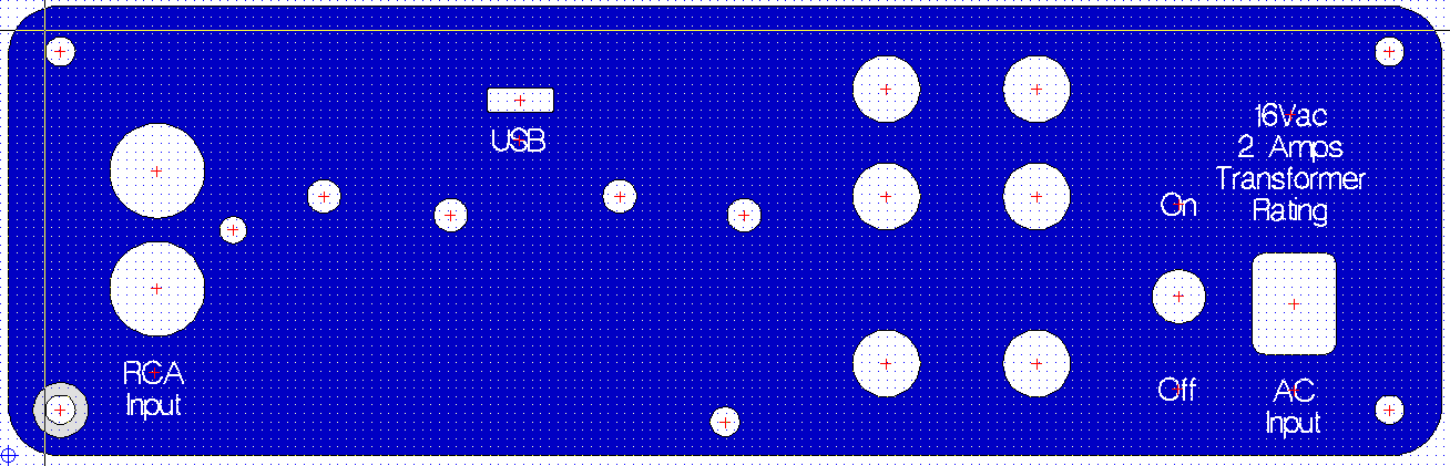

Finally I'm working on the revised backpanel this week. It may wind up more or less with two rows of vent holes and the USB hole for the ODAC.
Looks like 4 holes on top of the board and 2 below the board.
Interesting....
Alex
Yeah the ODA PC board will act like an air flow divider in the box. So I figure a couple of holes below the board level and a few above.

So I completed my first box earlier today and have been listening to it for a few hours with various cans, and overall am loving it so far!
Congratulations on your build!! That looks absolutely terrific. 😀 I like how the black turned out.
Excellent work on that ODAC addition too! Kamilgd has been eager to do more panel work for that and I haven't had the time yet to make measurements. Hey please let us know if you would be willing to either sell those panels and your ODAC mounting board over in the vendor forum, or post the CAD dimensions. One way to the other I know a lot of work went into getting it right. I'll bet several folks would be interested in both. That was a good idea having FPE cut the mounting board. It would probably be hard to get the cuts and holes exactly right with home measurements and drilling. I see that Seeed Studio also has a laser cutting service that I've been meaning to look into.
As far as I know you are the first to integrate the ODAC and ODA!
Good point about the bass boost. If the headphones involved are already using more than half of the 7.25Vrms available swing, then the bass boost would come along and double that at low frequencies, causing clipping. At least the ODA has a clipping light to let people know that is happening, unlike the O2 headamp. What is the impedance and sensitivity of the headphones that clip? If they are 300R or above they may be a candidate for the +/-15Vdc rail version. That would supply about 3Vrms more voltage swing. Another thought is to back the boost off from 3dB to 1.5dB.
Also good thoughts about the molex connectors for the RCA jack! I'll add that to my list of things to look at for the next board run. 🙂
And a big thanks again for helping root out several issues in the build instructions. 🙂
