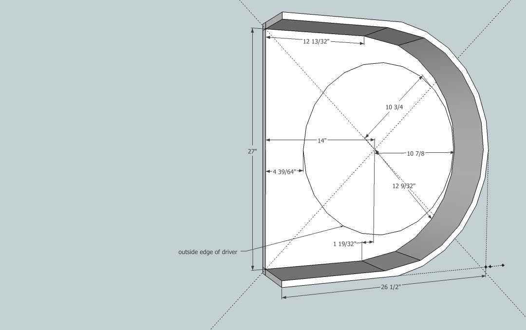

I'm looking at this exact shape to experiment with as a manifold design for a PPSL-IB build. Would contain one pair of 21SW152-4 drivers.

It's hard to see but the design I posted utilizes a semi Parabolic trough.
larry,
I just finished the math.. keep the driver as close to the "back wall / reflector" as possible.
You can also trade of width v. height in the opening:
er? trade of width
Tricks to reduce the rear corner volume of the plenum are to extend the midrange response, are you planning on running a pair of 21SW152-4 up into the midrange?
I wonder if it's possible to treat the cavity resonance by another means? For example, extend the cavity a bit, then fill it with just enough damping material to tame the resonance? Or is that too much bother for what can be dealt with via active filtering? 🙂

Hi revboden,
Sorry I didn't make myself clearer, maybe this will help:
Hi revboden,
Hi revboden,
Yes, that helps. I must build two of these and test to see if the back reflections /top-to-bottom, are positive or negative in-room. I suspect all energy being reflected out is better but you never know with physics...

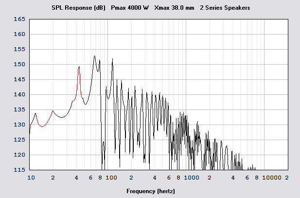

'Too much' is an individual's choice. If I had a house capable of handling such output without having it collapse around/on me, a pair of DTS 'wannabes' and a few kW would be just about right for the dynamic headroom/low distortion/BW I'd want for some movies, games: AVS Forum - View Single Post - Top 5Hz-15Hz BluRey movies
GM

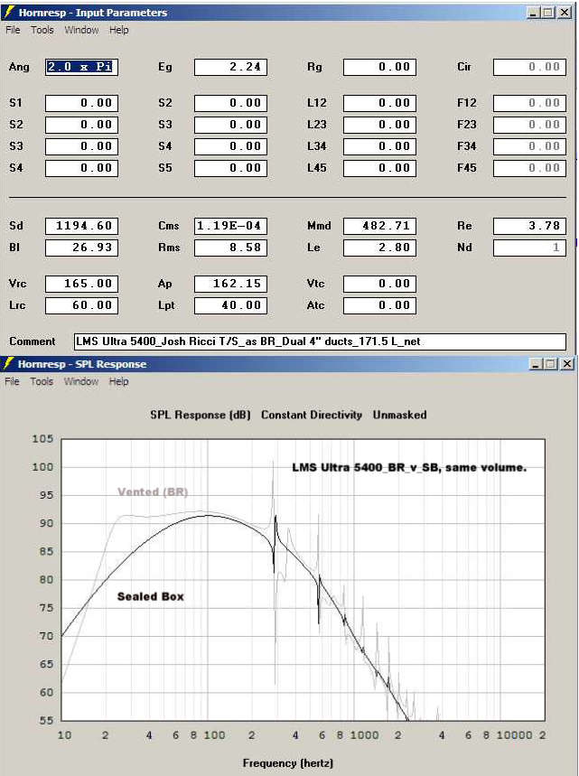

Thanks TB46. The graph you posted seems underwhelming. I am not sure I am reading it right, but LMS ultra 5400 achieving only 90 dbs at 20hz, is that right? BTW< I have Lab Gruppen 14000 powering these.
GM, thats the LMS Ultra 5400 series 2? I believe I have an older version of the lms 5400...
