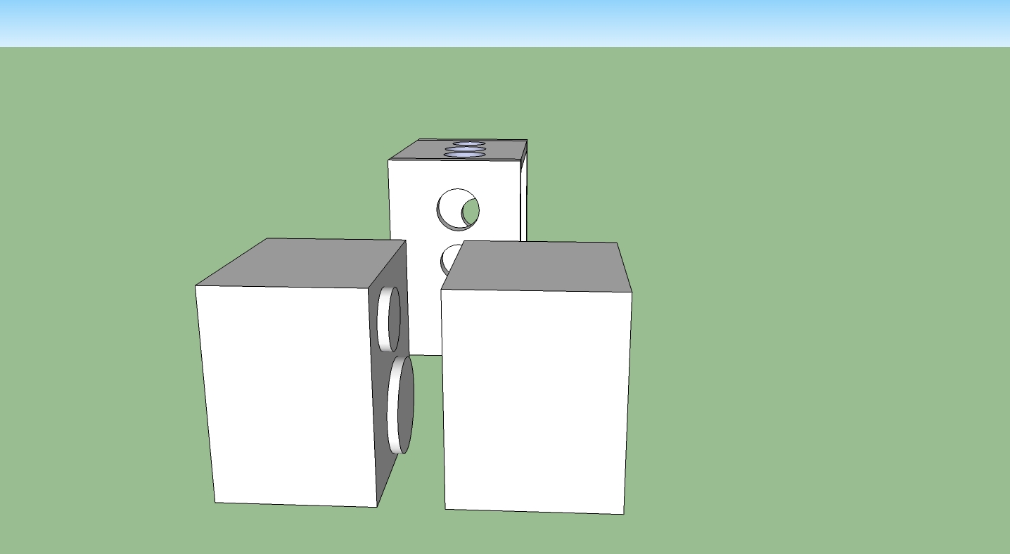

Conceptualizing a different style
Using some of the concepts of PPSL, I'm looking at doing a dual passive radiator setup. What is proposed is 2 standalone subwoofer enclosures with passive radiators, one with frames inside the cab, one with frames outside (push pull). These two independent cabs are then joined together with a U-shaped frame with holes, bridging the gap between the cabinets, and are firmly affixed to the original cabinets with screws/bolts/whatever.
The holes should allow plenty of surface area and breathing room for both the PRs and the drivers, but still act as something of a lowpass filter, while gaining some even order distortion cancellation from the "push pull" mounting. Additionally, the U-shaped frame could be lined with felt or some such for some additional absorbtion of higher frequency harmonic components.
While the manifold PPSL design has an advantage in better mechanical coupling/force cancellation, this design has one big advantage- it's easy to retrofit to existing subwoofers, and can be divided up for ease of transportation or for those times when you want 2 smaller subs instead of one manifold monster. There would be some directionality effects at higher frequencies, but I don't think they're relevant to discussion as both PPSL and this concept are "pure sub" designs, and not really meant for >150Hz operation.
Attached is a concept pic, 2 cabs next to each other with a U-frame to bridge the gap.
