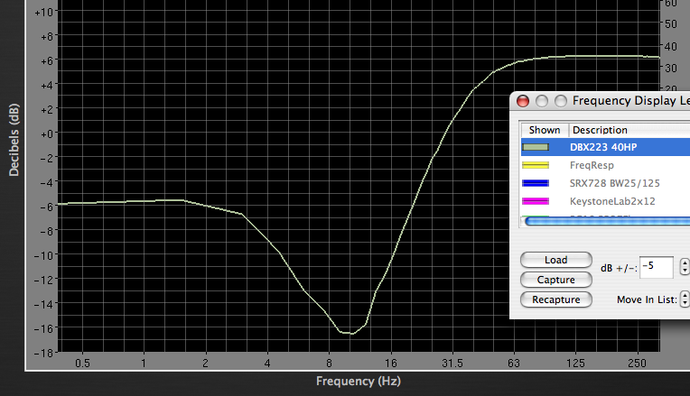

A while back I checked out the response of my DBX 223 crossover with the 40 Hz HP engaged.
The curve looks like what a 24 dB per octave slope should until about 10 Hz.
Though it would provide adequate protection for most musical sources, the rising response below 10 Hz could be a problem with dropped needles and some sound effects etc.
Did you happen to check the response of your DBX 234 before and after modification?

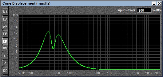

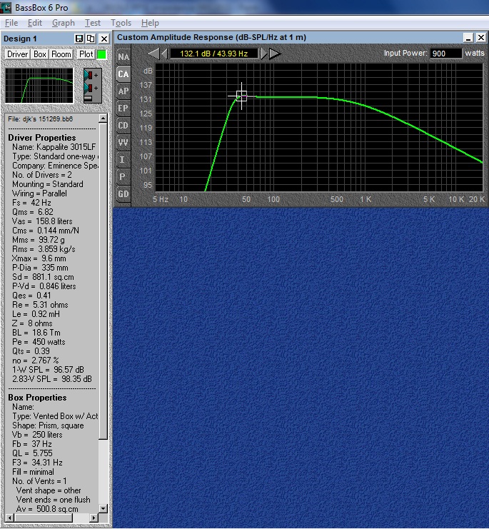

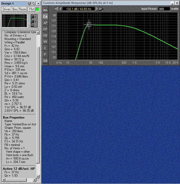

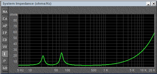

I'm trying to think of smart enclosure and plenum dimensions to box this PPSL enclosure with the two 3015LF drivers I still have in the box. Do any mistakes jump out at you? Any help = much appreciation! :cheers:

Sorry for my English....Try this script in Akabak...you need change driver TS-parametres

I'll try that when I get home tonight. I will mention that I find no way to model the plenum with the very irregular driver shapes in it, thus the graphs produced are not accurate at the higher frequencies. GIGO.
