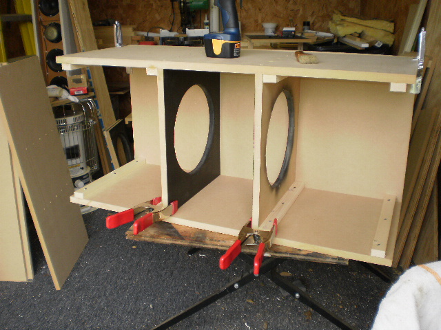

Well I finally started cutting plywood. It took me a while to get going.
Well being new at wood working I have a tendency to over think things. I bought a router table extension for my table saw and thought a 45° Lock Miter Router Bit would be the perfect way of joining the corners without showing an edge. Well I learned all about tear out. So I gave up on that. So now I am using butt joints. Maybe some pics next week when I start screwing it together.
Any assembly hints?

premium glue and clamps. (screws always help)
Nothing else is really as important and most of the joint stuff is just overkill extra wasted time.

Any special glue?
I am planning on painting them. I want the corners to be good. Need to find out how to seal the ends of the plywood so the paint will look good.
Man those butt joints are ugly!

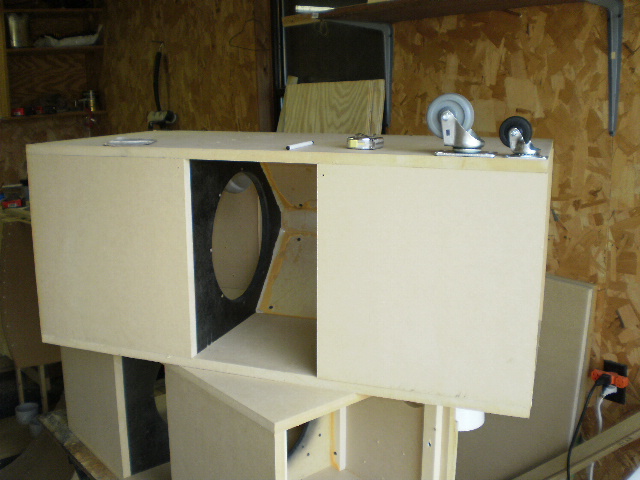

Seeking critique
DJK: Awaiting your thoughts on why my ppsl's did not work out so well ?

The coupling mustbe as tight as possible for the ghigher frequencies to work.
I ordder to work you must be withing 1/4W of the second harmonic of the highest frequency to intent the box to work at.
Yours look way to big.
You might even have to slant the plenum like EV did with the MTS-1, it was crossed at 800hz.
Les Hudson has run some very high crossover points too, but his plenums are very compact.

ppsl exit area
Well, I thought that might be the case, so why did i do these as such ? Because, i did not want to restrict the exit area. I made it that size to equal 2x SD of one driver. Evidently, a big mistake. Thankyou kindly, for you prompt reply. I'll do another ppsl next summer, but with very close coupled 15's.

"I heard a pair of Les' ppsl's down in Atlanta- they were awesum! "
Great, at least you have an idea of what to expect.
Also, if using with a subwoofer, it might be a good idea to go for a sealed system to avoid the group delay issues associated with a vented system. Venting is not an issue without a sub, but with a low crossover point to a sub, and venting of the mid-bass, the phase/delay can get funny.

In addition to djk's reply about spacing to get higher frequencies than subwoofer, looking at your box, the rear of the drivers are not sharing a common enclosure. You have seem to have 2 drivers in totally seperate boxes. You need to have the drivers share the same enclosure.
see post #60 if I am confusing you, ppsl.

Sorry to interrupt but it can work Norman, as long the tolerances of the TS parameters between the two drivers are very close and the boxes behind the drivers have exact the same volume...
But realistically, only top (expensive) drivers have such small tolerances and Scott seems to have 'forgotten' to make up the volume differences made by the drivers...
