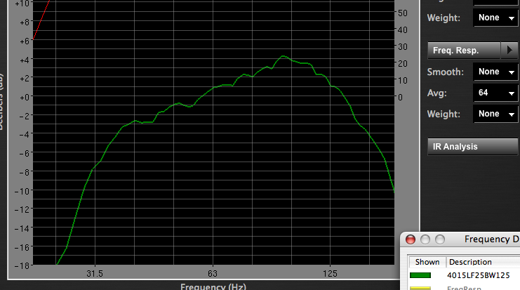

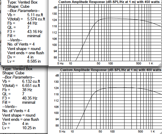

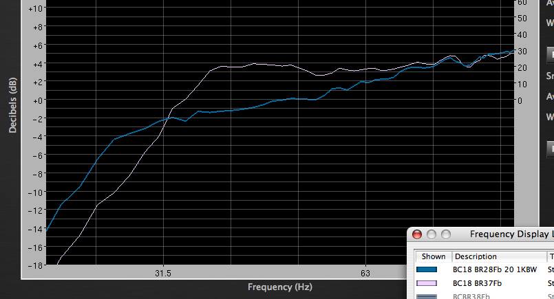

"Flat" is a relative term. The low corner will drop below Fb, but tuning so low will cause a rolloff above Fb.
Note in the sims below that a larger box is required to get basically the same output at 40 Hz when Fb is lowered.
Your box is roughly the size (per speaker) of the 44Fb, tuning it to 30 Hz will lower the low corner at the expense of upper output.
It will have a knee around 30 Hz, but will droop from the upper response down to that point. You will sacrifice a lot of 40 Hz level to achieve the lower corner.
The 36 Fb example below is a 4015LF with a 36 Fb "too small" box, your response will look something like that tuned low.
Anyway, it's all a tradeoff, and you can always shorten the port if you find the rolloff above Fb is not worth the extension.
Using the speaker you have, I'd probably tune no lower than 36 Hz as a compromise between extension and kick.
Edit: just added charts of a 37Fb and 28Fb in the same box size to better illustrate the choice: loose 4 dB at 40 Hz for the same response at 31.5, but gain about 4 dB at 28 Hz.
For the music I work with, the 37 Hz tuning works better.

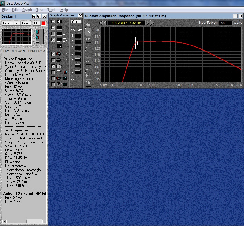

Sorry for the confusion. This design has an Fb of 37. I posted a few pages back, but will post again to save searching time. Any idea how close to this sim it may perform?
