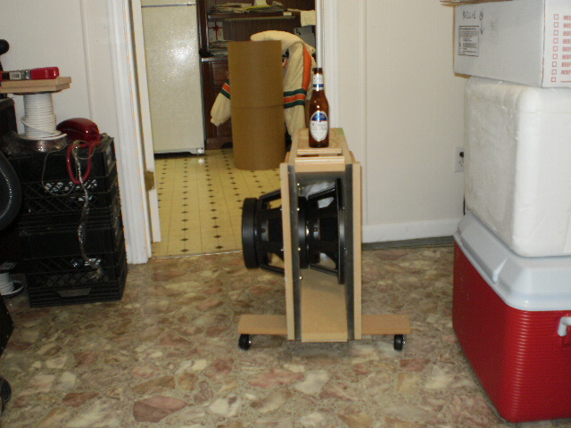

winter build
To my fellow diy'ers: please bear in mind this thread contains a wealth of information. A lot of questions have been asked, answered and then asked again. The most amazing aspect of this thread is, it went off topic by the 3rd post and never agained returned. Even I, as in myself, missed this the first 2 times i read everything on here, in it's entirety. It wasn't until (by coincidence) that I came up with the idea of using a ppsl "motor" as a compression chamber for a mid-bass horn, that i went back (again) and read the beginning, only to see that's what "jamikl" had in mind, in the first place.
Please allow me to re-iterate. This ppsl concept is not as complicated as some would make it out to be. For me, my adaptation of the ppsl principle has given me the exact: accurate, full, punchy and dynamic system I had been seeking for a long time. For my application, it's mid-bass, and the most twisted hybrid style never seen before, but I also plan on doing a conventional in box ppsl woofer system for a 3 way in another project.
My hat's off to djk.

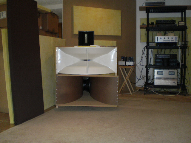

wow, the most right pic looks most interesting - PPSL coupled with mid horn, EV's big whale and TPL-150. is this your system scott?
what do you expect to get attaching a front horn there (except maybe to harmonize the crossing and smooth the sound characters from sub/bass and mid-horn)?
yes
Yes, this is my system aka "the beast". The ribbon tweeter is the Stage Accompany SA 8535. I listend to the ppsl motor sans the horn for a while,
but when I added it, the directivity factor increased, as well as the dynamic impact. So, yes, you are correct. This is the best system I have ever had.
Only took 39.5 years of building, and trying different things. Tube amps and horns for me. Having said that, I realize they're not for everybody. For me, this approach allows me to emotionally connect to the peformance.
Not visable in any of the above pics, is the sub-bass system. Mono because of space restrictions/ room layout. 8x AE IB15's in an infinite baffle.50Hz and down to about 17, but I am considering changing up to 60 Hz.
Throw Thiel/Small out the windown when dealing with this type of ppsl. There is strong response down to the mid 30's. I can't expalin why, it just is.
Of special note: the fs of the Eminence Definimax4012HO is 46, but when coupled in the ppsl with the partnering driver, the fs dropped to 40. Then, after I added the sealed back-wave enclosures (which are of differing volumes to compensate for the fact one driver is "flipped") the system resonance (Fc as oppossed to Fs) was @ 57Hz with a Qtc of about .6 if memory serves correct. Stunning, articulate, and dynamic bass with no hint of a "box" sound at all. Highly reccomended.

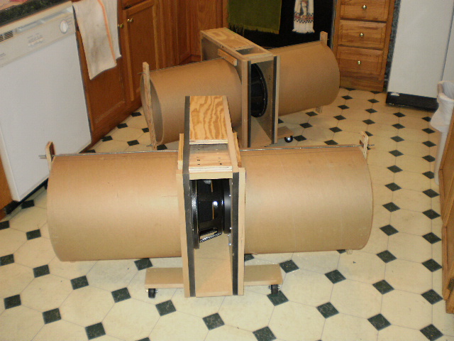

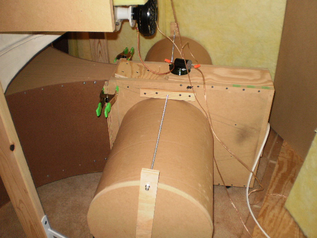

non common enclosure for my mid-bass
In my case, each woofer sees it's own "volume" of air. The preferred and djk approved method uses a common air volume for both woofers. It's not the first time I have gone against the grain in my life.
Most of the reason why I did this was: I hate wooden boxy sound !
I had built a previous version of a ppsl (using the exact same woofs) that ended in disasterous results. Part of the reason was [that] I had the 2 woofs too far apart physically. So, while back at the drawing board I came up with the next plan, which was to have minimal use of a wooden structure; the volumes of air would be contained by sono-tubes, and the end caps are mutliple/alternating layers of smaller and smaller diameter plywood/mdf.
Thus, there are NO PARALELL surfaces in the enclosure. The two volumes of air are different because of the fact one woofer is flipped. This is probably not ideal, but it worked in my case. I fully intend to build another version of a ppsl in a conventional boxed enclosure (double constrained layers). The next version will use 2@ 15 inchers. Speaking of size, I see no reason why there's a limitation on woofer size. Persoanally, though, i wouldn't go any smaller than an eight inch, because 6 1/2 inches is not a woofer size. Ten inchers might just be the ideal compromise between bass extention and enclosure size. As with any other woofer/or/ sub-woofer system, the lower in frequency one wishes to go requires a bigger and bigger volume. In a ppsl the plenum volume gets added in to the equation. This is why djk has adopted the use of 6th order assisted (equalized) alignments. There has been much discussion on that topic in this thread. I also should mention, since my ppsl's act as compression chambers to load a horn, they are indeed sealed. For a stand alone subwoofer, I'd go the vented route. My conclusion is, the ppsl approach is brilliant. I fully echo Les Hudson's view- I won't waste my time doing any other woofer system other than a ppsl. Pictures show the minimalist use of wood in the motor structure.

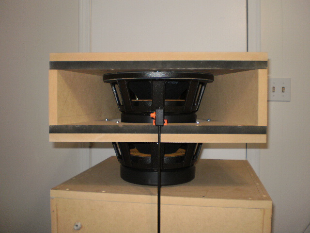

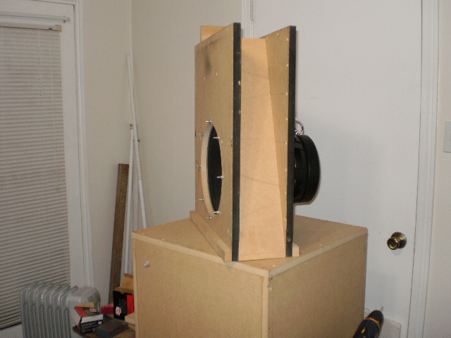

"I have been meaning to make a dual 8 version with the JBL 2118 and mount the drivers so close to each other that the magnet nestles inside the opposing cone. With a slot with a 4:1 compression ratio coupled to a horn I am expecting to be able to push it quite high. Should be interesting."
If you look closely at my above pics, you can see I did indeed that- the drivers are so close the magnet nestles inside the cone. I remember before you instructed me (my last attempt) that my woofers were too far apart, so I went to the other extreme 🙂
My plenum slot is 2:1, but the horn throat is then again somewhat smaller, resulting in a compression ratio of about 2.5 :1
