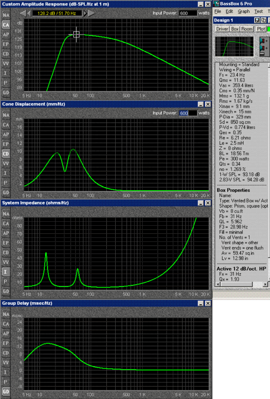

Question regarding the djk PPSL design using the Martin Sound 1844 drivers
Hi djk,
I seriously consider using your PPSL design for the Martin Sound #1844 drivers (please see attached file) for home use (not PA).
1. Is it correctly understood that the total internal volume for each box (Fb = 31Hz) for two drivers is 8 cf? (I just want to make sure about the size before I start drawing)
2. It says "minimal fill" in the simulation. Would 1" of foam/fill on all internal surfaces be ok, or what will you recommend?
3. Are the two drivers in each box wired with the same polarity or one of them reversed?
Thanks a lot!
Best regards
Peter
I'm not djk, but can help a bit.
1. Yes. Make sure to accommodate for extra space needed for the plenum and port.
2. He doesn't use fill on his sub cabs
3. One driver is wired in reverse
Just some simple answers. Maybe djk will report w/more info if needed.
Justin
1) Yes, the net-net volume is 8 cu ft. The boxes are 36W x 24H x 30D (3/4" ply) and take about 1-1/2 sheets per box (IIRC).
2) I don't actually use any fill for PA, minimal to prevent reflections getting out of the port should be fine. Use your judgment here.
3) The driver you can see the magnet on is wired with reverse polarity.
Depending on your room gain you may be able to lower the Q of the filter. In one home I was able to lower the Q to 1 (no boost) and the response was still flat to 30hz. Use your judgment here too, especially if playing records (you need the filter).
