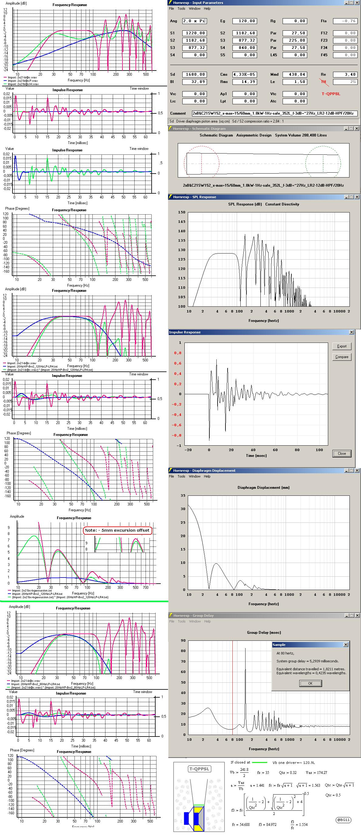

"T-QPPSL to be played at lower input powers:"
It would have to be for lower power, the output slot is 4:1 for area, and you are using it for the 'port' output as well.
The pressure/velocity would be very, very high at any kind of real power.

DJK. You make a good point about building. However, I am still unclear how to model a sealed PPSL or a 6th order bandpass PPSL. I use WinISD and Hornresp (amateur). I would really like to know what is optimal, including the effective frequency range of operation, for a driver before building. I have a pair of 12" drivers I would like to use in such a design. Is there some sort of tutorial on this?

I don't worry to much about trying to model it, I designed it BC (before computers) with a four function calculator and 6th order formulas from Keele.
The first dual 15 PPSL had an exit of 16.5"x5" (3.3:1) and I was concerned about the intense pressure it had. Subsequently I changed it to 22.5"x7" (1.7:1) and feel a lot more comfortable with the pressure. A Klipschorn runs a 13"x3" (3.4:1) in the throat.
