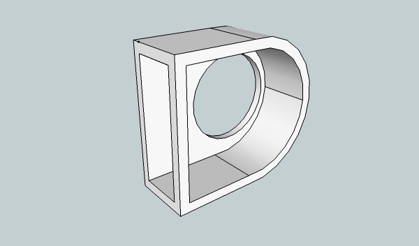

Hi doug20,
Maybe it would help to think about PPSL more as a driver mounting method than a destinct type of enclosure. You can use the PPSL plenum mounting method with any type of enclosure.
Plug the T/S values for your drivers (e.g.: the TD12S) into Hornresp, and take a look at what you can model.
