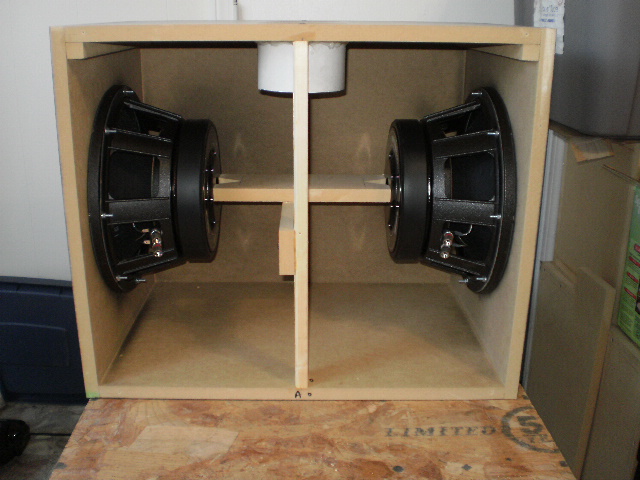

The PPSL is a slot loaded manifold like in the picture above. There is a plenum in the middle of the enclosure where the speakers are very close.
I suggested and my question was why not use a regular dual sealed with opposing drivers. Invert 1 of the drivers to face into the box.

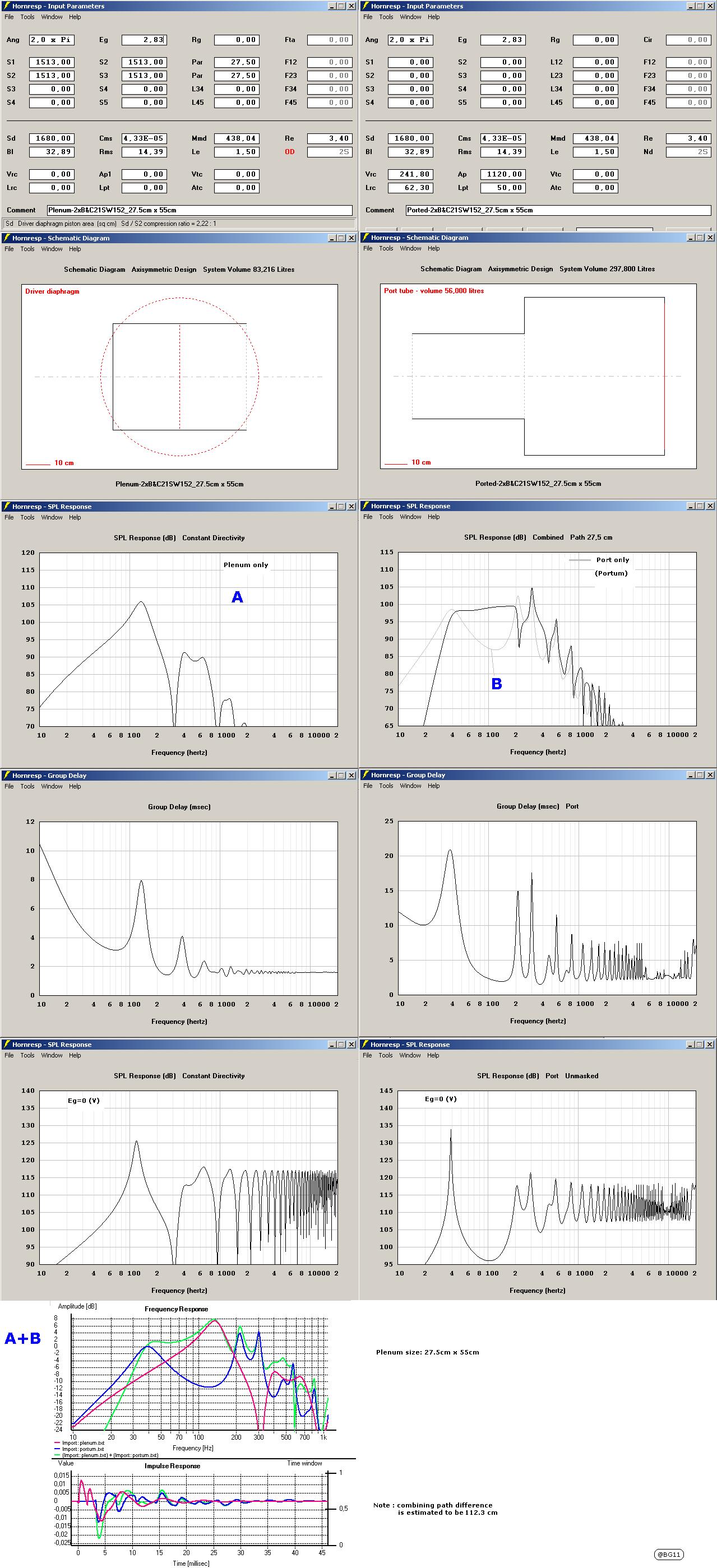

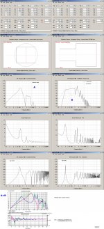

Vented and sealed are both ok. Some users are having difficulty modelling the build with a 6th order vented designed.

Decide what you want, sealed, vented, equalized vented (6th order), or dipole.
Ignore the volume of the plenum.
Model the drivers loaded as above.

Hawkson the problem in your example is the relation between frequency and its wavelength. It will work for coupling of the drivers but not in relation to PPSL effect.
The PPSL works on the principal of loading the same air molecules ('captured' air in a slot) while in traditional PP setting they don’t. The smaller (volume) the plenum the wider the effect in frequency becomes (and in the same time drop its upper limit, still following
However, if you make the opening to small the pressure inside becomes to high. This will result in air resistance (friction -> heat) -> higher airmass -> lower SPL.
Secondly, there are also physical relations between the drivers that become more important in Djk's PPSL. But that's a much longer story and needs more understanding of the push-pull in relation to impulse behaviour, system damping and time domain (distance related).

When both drivers face into the plenum your model is correct.
But your model of the plenum is incomplete, it does not take into consideration the space occupied by the drivers and the irregular resulting cavity.
In actual tests, with both drivers facing into the plenum I measured about 6dB of cavity resonance. When I flipped the one driver, the resonance went away, and the cabinet measured flat, no peaking, no bandpass gain type behavior.

perhaps here is some inspiration.
Yes, those are 18's with a 12" diameter port.
