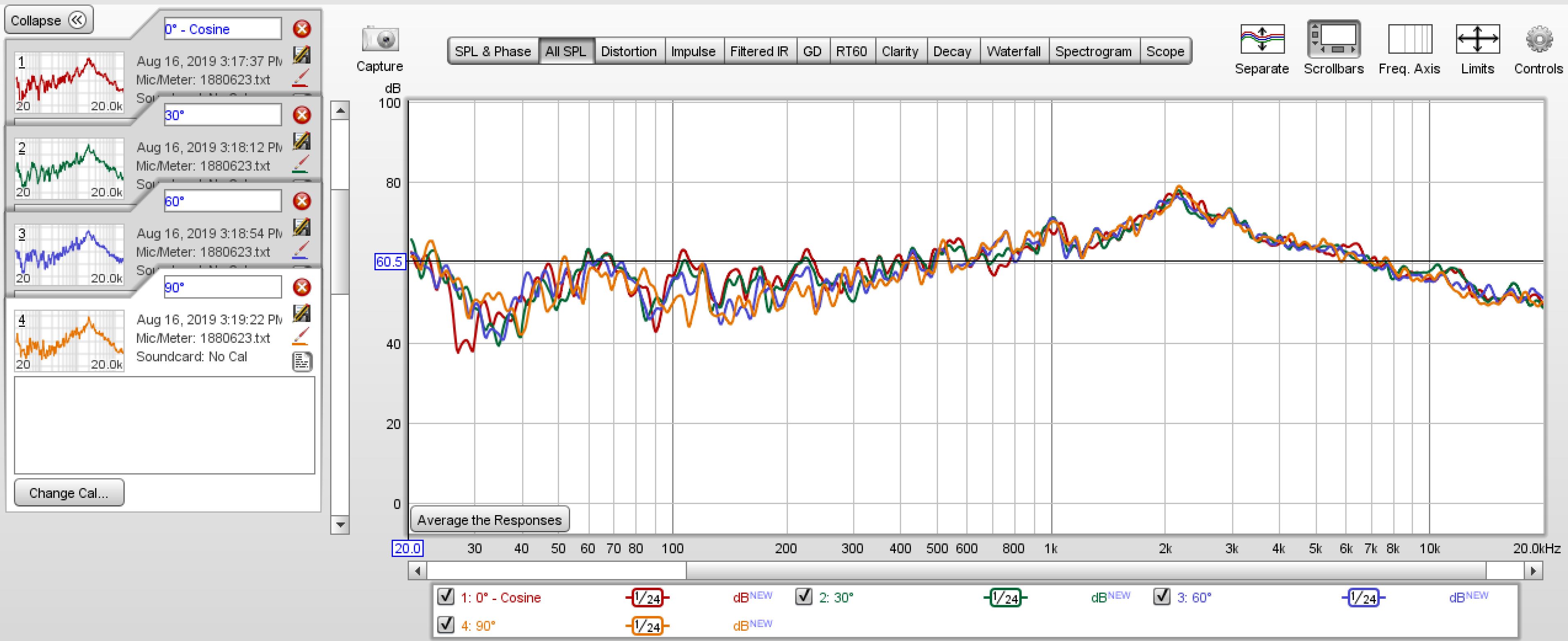

Hi all,
It's been a while but I've finally managed to finish my first test pair. They are small'ish carved XPS panels (350mm X 560mm) suspended within a hardwood frame, polyfill and cork backed because I want them to be wall mounted.
They sound very good paired with a small subwoofer but they did lose a tiny bit of magic when I closed up the back.
Attached is just a few quick pics and a REW measurement.
........on to the next panels 😀
JMatt,
Those look great and the REW plot looks good too.
Can you tell us about the carving you did? Did you try the XPS panels without carving before you machined them? What did you hope to achieve by machining them?
Eric

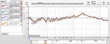

I don't know. But here's my REW measurements while rotating the speaker 90 degrees. There's no cancellation on the 90 degree axis. However, there should be cancellation because I have tall thin panels that move in pistonic motion.

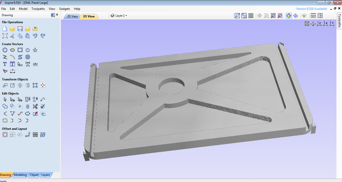

JMatt,
Eric
Thank you Veleric, the attached photo is what I ended up carving on my cnc. It might just be a placebo but to me the carving improved the overall sound on smaller panels a bit. On my next build I'll do a lot more measurements to see if there's really a difference.
