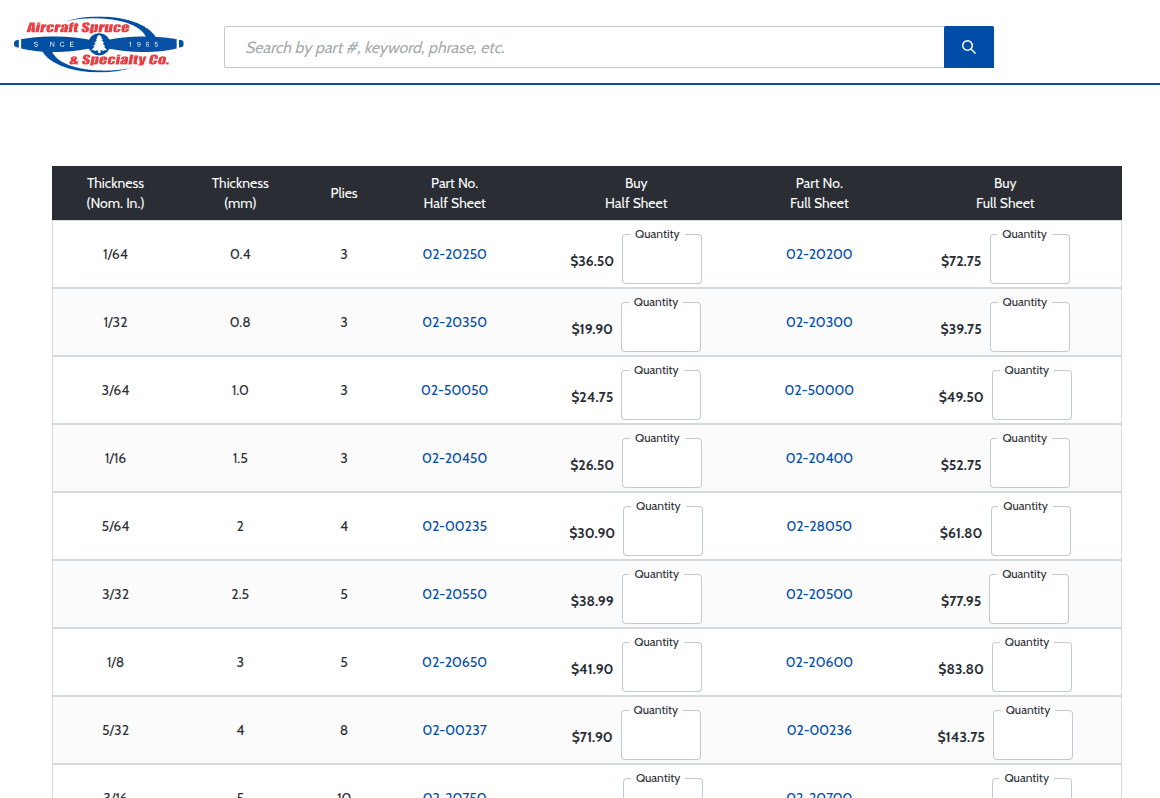

Here's a screen shot of the US source I found:
I don't know if tariffs will be tacked onto these prices. Sometimes they only show up when completing the purchase. And then there's the shipping.
If the US Sheet Dimensions are the same as the UK's, the Full Size Sheet will be approx' 50% Cheaper to acquire in the US.
Either way, if a Wood Based Panel is the most desired and is now needing to be purchased, in my world this Wood Type in the Thickness under 1mm, is the way to go.

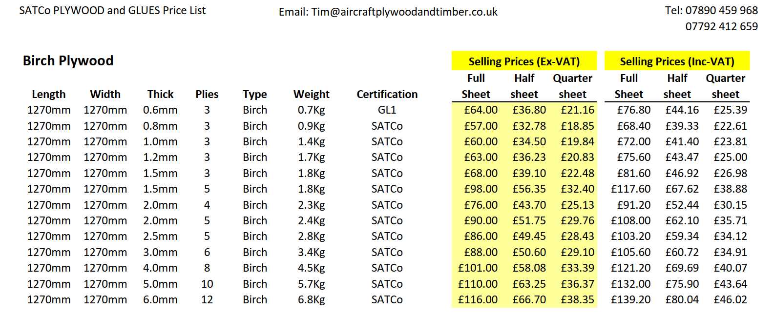

This was about the cheapest option I found on eBay.
https://www.ebay.co.uk/itm/26594076...lp:2332490&itmmeta=01JSV3P3WRJVQ6WHX6FAJNA98C
Free shipping.
