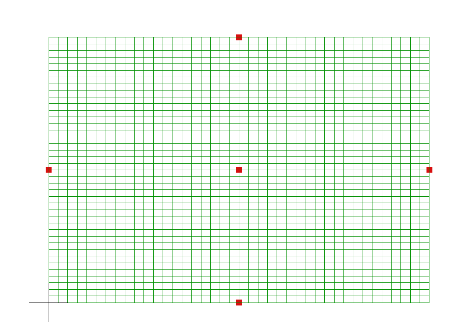

I have also been thinking about and exploring ways to support a panel in a way that "mimics" a free panel, but is more robust and practical than just hanging it, plus avoids the problem of vibrations of the hanging members, and also provides the opportunity to provide support for the exciter. As you know, I have doubts about any true benefit of the "free" panel (other than simplicity of construction), over a well damped perimeter mounted panel, but it is an interesting technical exploration, in any event.

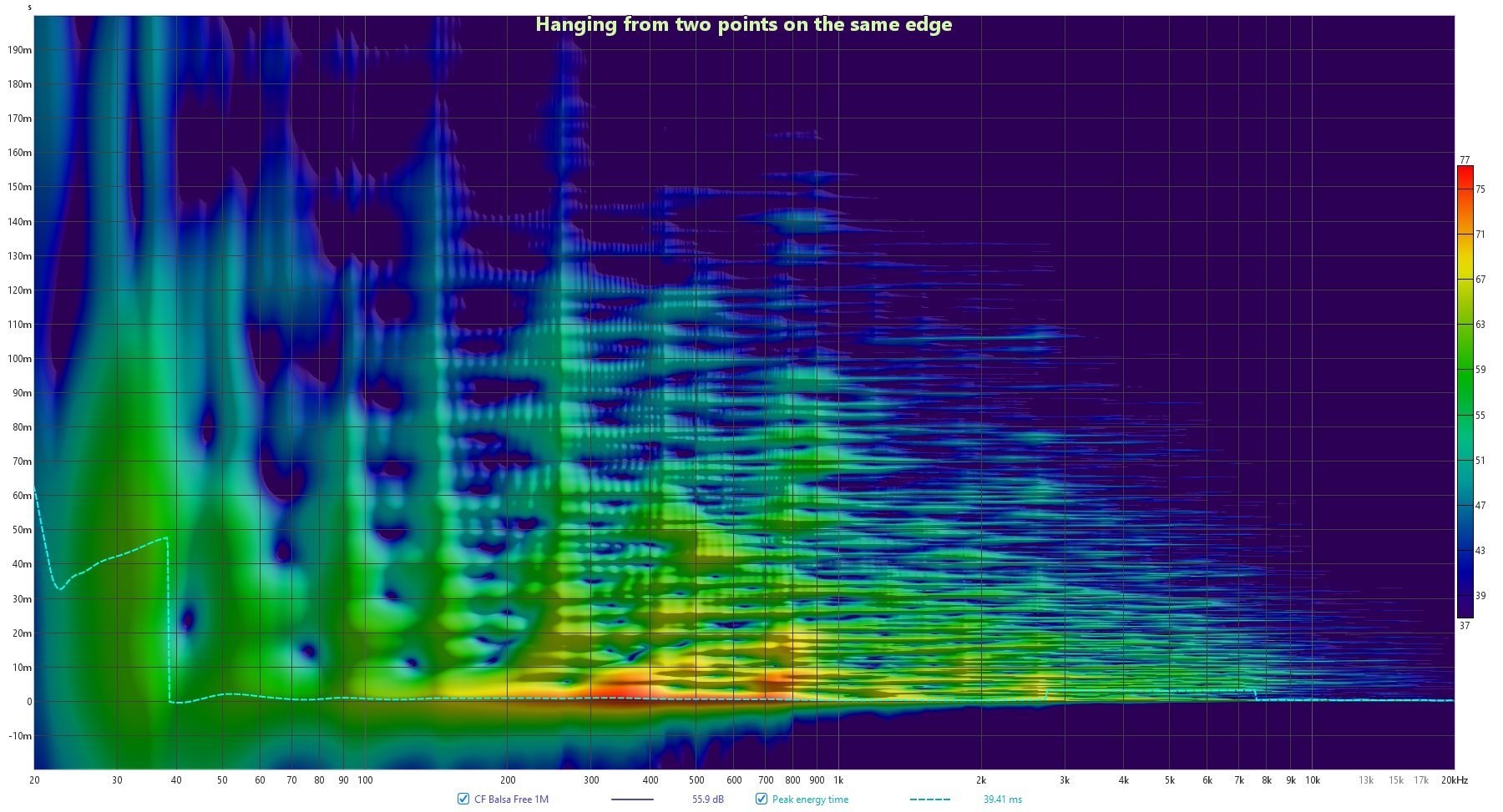

Originally, my thought was to use only three mounting points (the minimum to define a plane), using very soft foam to minimize any restraint. Also, I thought that the mounting points should avoid the perimeter, since virtually all the modes of a free plate have antinodes along the perimeter. Also, I thought the mounting points should be in an irregular pattern, to minimize the impact on any given mode. And finally to avoid mounting points near the exciter. But after trying many such mountings, they all suffered from ringing at one frequency or another. So I abandoned that approach.

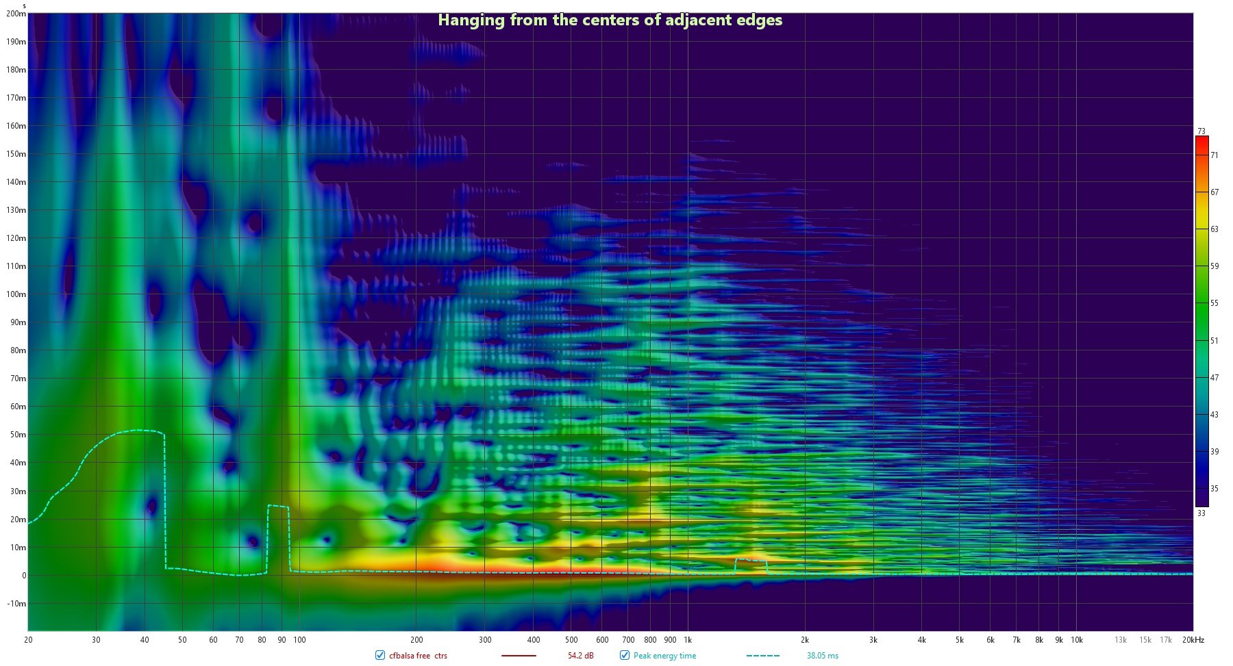

But I recalled that hanging the panel from the centers of two adjacent sides helped minimize ringing. For example, these two spectrograms compare hanging from two points along the same edge (first images), vs. hanging from the center points (second images). Clearly, there is less ringing in the second mounting, presumably because it inhibits some of the modes most prone to ringing.

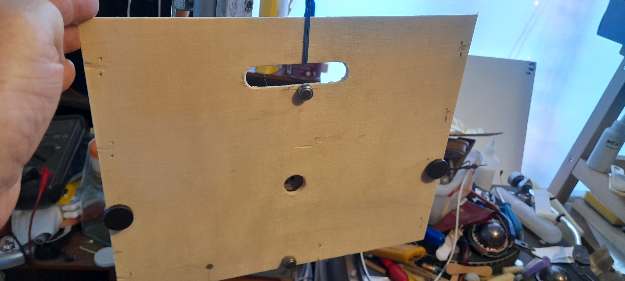

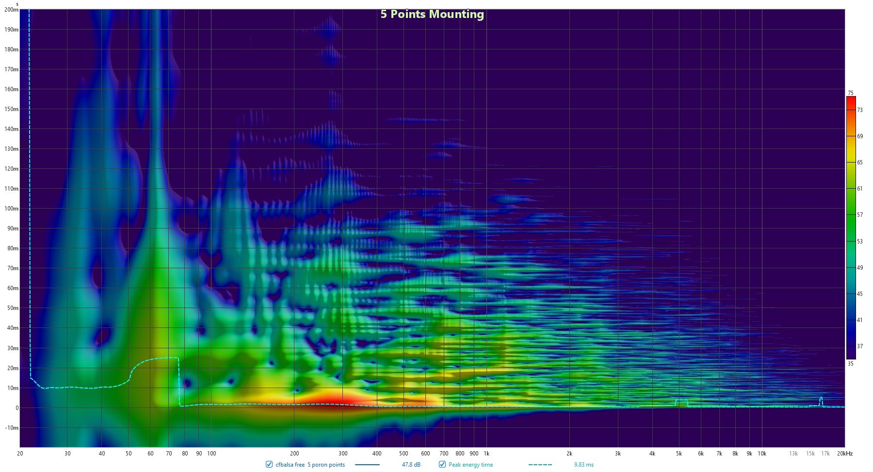

Taking inspiration from the second hanging method, and playing around a bit, I found that mounting the panel at these five points (using 18 mm squares of Poron foam) provided interesting results. Ringing isn't eliminated (still some at 60 Hz), but it's much better than the first "hanging" case. I have to admit that it is about the best sounding of any "free-ish" panel that I have tested.

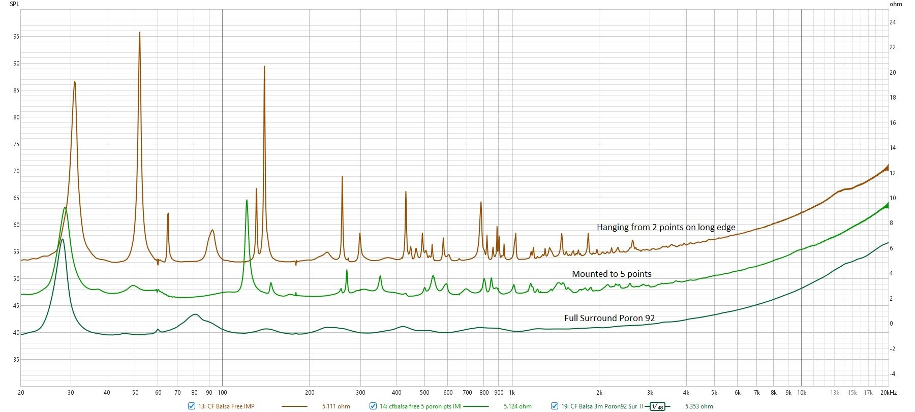

And here's a comparison of a few impedance curves to provide some perspective. On top is the case of hanging from two wires on the same side, probably the worst case of ringing. The middle curve is with the "five points" mounting, and the last is for mounting with Poron foam around the entire perimeter. The "five points mounting" seems to provide very strong damping at low frequencies, but at high frequencies, the "five point" looks a lot more like the "free" (hanging) panel than the damped (Poron surround) panel.
I should note for the record that all these results are using a 2.1x584x406 mm cf/balsa sandwich panel, and a VT25-4 exciter mounted at 0.4/0.4.

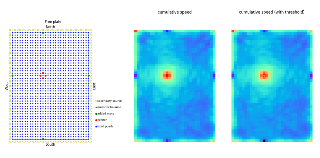

Maybe by this picture:

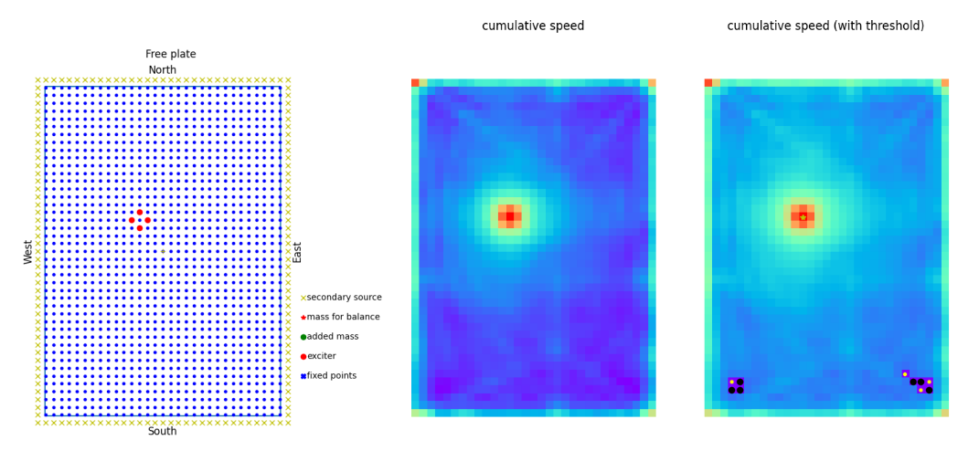

It is from the current status of my FDM simulation script. Frankly, I don't know up to which level this script is able to simulate a panel. What we know currently is its outputs about modes make sense and are closed of FEM simulation. I have implemented the electrical impedance, the SPL in a half space (like the SPL from PETTaLLS) and just few days ago the SPL of an open back panel but also a tentative to find possible suspension points.

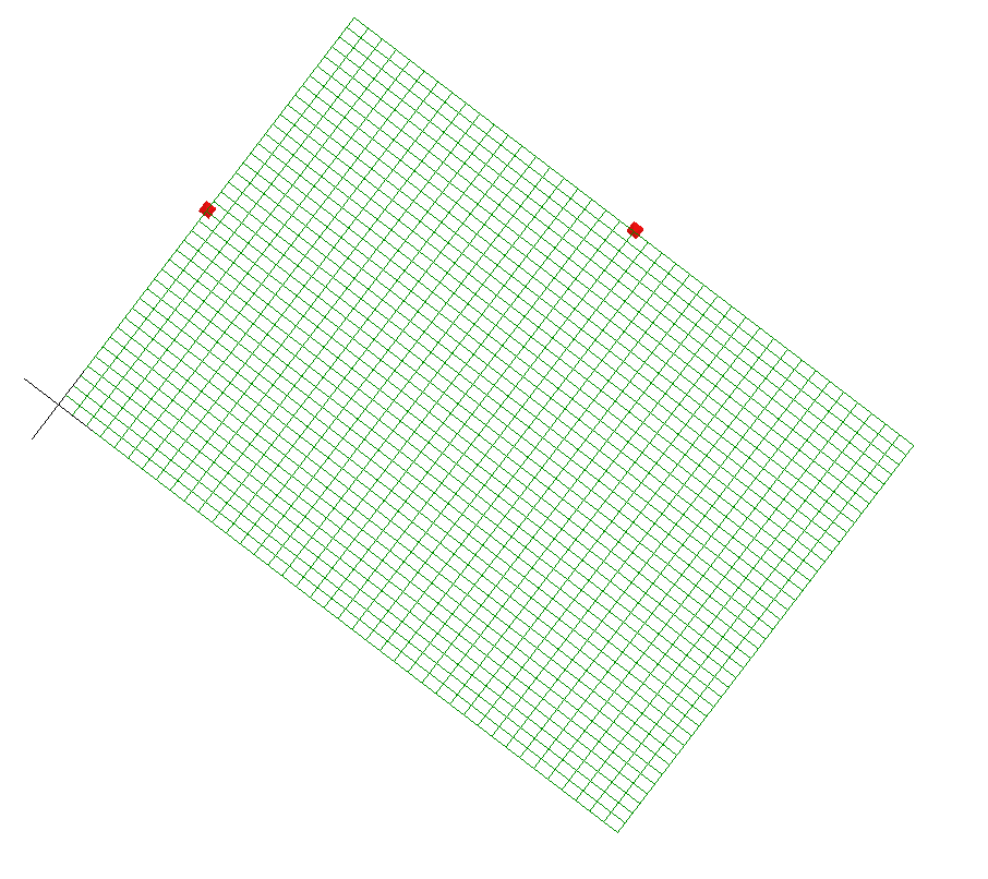

On the left of the picture is a view of the panel simulated. Here a free edges 300x420mm with something suppose to be a polystyrene and a DAEX25VT at 0.4/0.4.
The 2 other plots are a tentative to see what are the possible suspension points. It is the sum of the speed at each points (blue dots on the left) above a certain frequency (200Hz). The points with the lower movements (or better to say lower contribution to the SPL) are the darker one.
Why 200Hz? It is because if there is a compromise to be done, better is to alter the response below this threshold than above.
As you mentioned, the edges are anti-nodes (light blue). There are even more movements at the corners (yellow to red). It is maybe the reason of the advice to round them.
There is no point of zero speed so any tentative to hang the panel should change the behavior somewhere in the FR.
But what appear from this picture is some points not far from the edges have the minimum speed. I haven't tried for now to confirm it with PETaLLS...
The plot on the right is the same with the minimum speed points set to 0 (black dot) and the points just above set to give white dots.
2 small areas appear at about 10% from the corners far from the exciter.
As I am more working on the script currently, I haven't tested them. From a simulation with those points fixed, the FR was changed more than expected. If I think those areas are a good information, nothing says the simulation is right about the FR.
If you are interested, fill free to add this to your tests.
Great progress Christian.
Yes, that's good evidence that your FDM model is working. The corners are antinodes for virtually every "free" mode, so it makes sense for them to be "yellow to red".
That is interesting. I was wondering myself about where the minimums would be. I ws inclined originally to try areas closer to 20% from the corners, rather than 10%, but I was really just guessing.

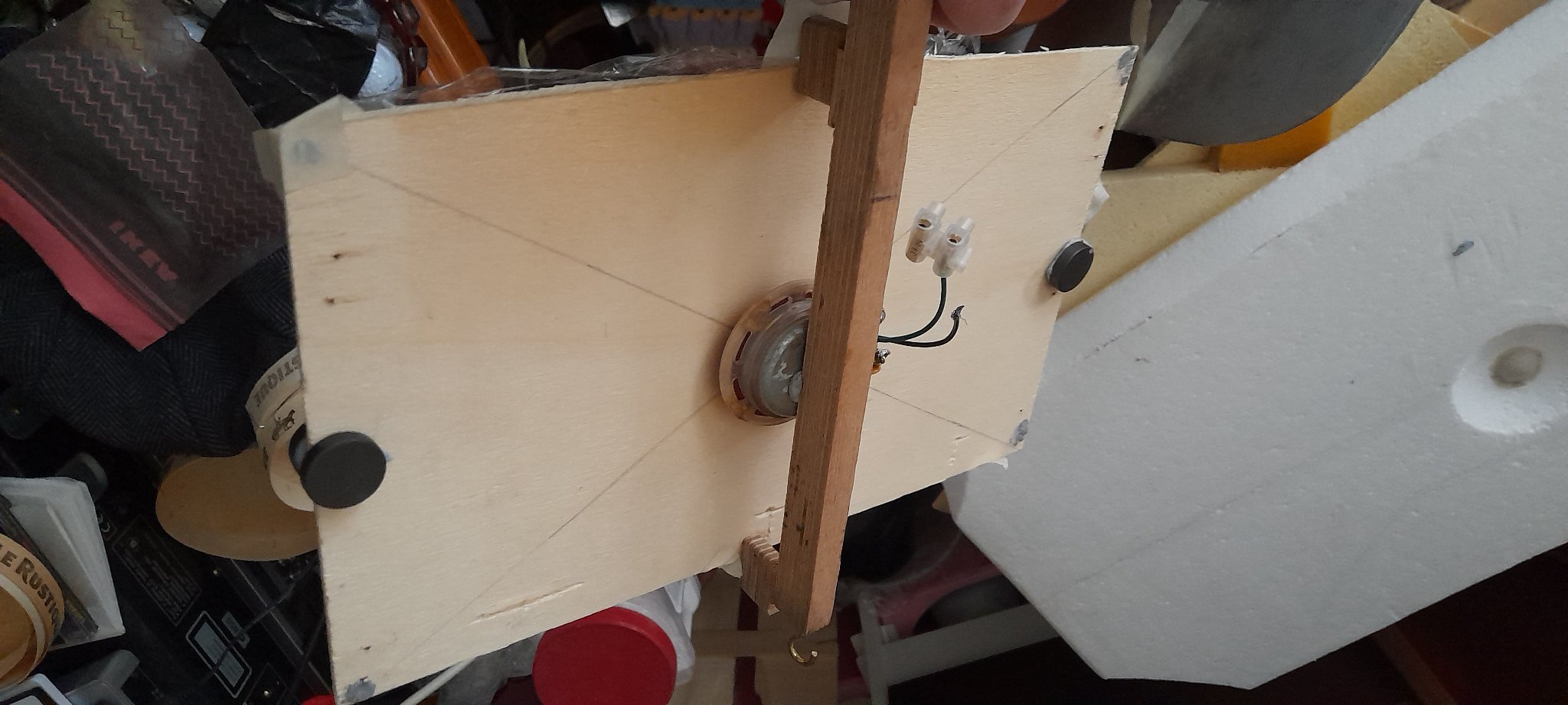

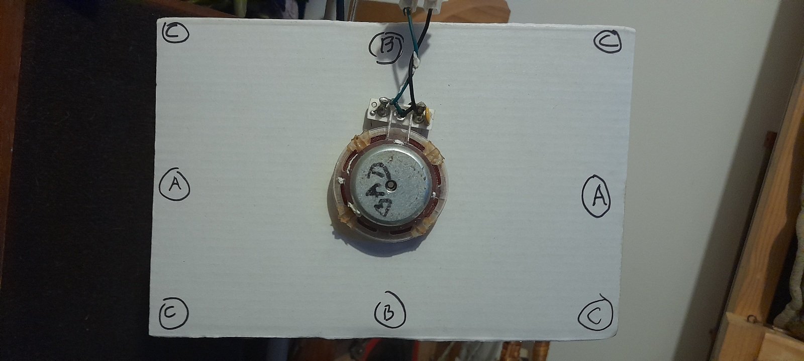

Hello Eric.
Thank you for confirming that my weight points which can also used as mounting points are correct.

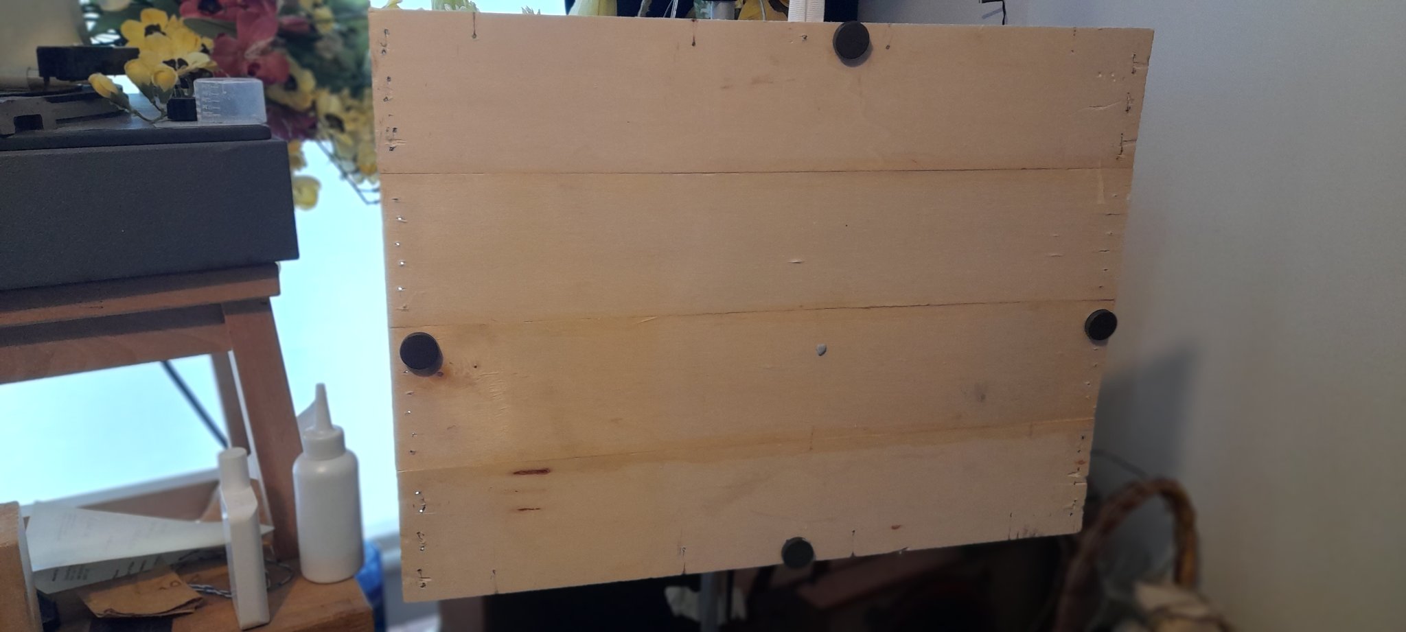

These are a few old pictures of some of the panels I have created using weights or mounting points to improve the frequency response and sound of the panels .
Notice on the first three small crate ply panels that the weights are at the first 4 reflection points.
Note, that the center point is the exciter mounting point.
If the exciter is used off centre then these points must be moved too.
This is very important.
In the last picture I think this was a square fluted panel of 2ft square.
You can see that these positions are different for this panel.
This is all done by looking at the frequency response as I touch different points on the panel surface.
This is very easy on small panels, but larger panels are more complicated and complex.
My original 3ft x 2ft rigidity mounted ply panel from about 14 years ago had about 5 or 6 AA batteries stuck to it using blu-tack, but now, all but one has fallen off.
These were also at good random mounting points on that panel.
I might have some pictures on the AudioCircle forum of this but not on my phone.
I have now, been going on about these points on my panels for years now and am happy that someone has finally taken notice.
I have said many times that randomly placing weights, foam , or any other type of mounting onto the panel is like pinning the tail on a donkey while blindfolded.
They must be in the correct places or it will not look or sound correct.
Placing one weight in the wrong position could ruin everything.
Steve.
By curiosity and because it is one goal of my FDM script to evaluate point mounting, added mass, I modified the script to add 4 5g mass at the edge points.
Same panel as in my previous post:
The added mass are at the green points of the left plot.
As expected, the added mass are the points of the lowest speed.
More interesting is that I have implemented a function that evaluate how smooth is the on axis frequency response. It works for now on the half space response (as if the panel was radiating from a wall with no effect of the rear wave) and would be probably subject to change... So the interesting result is the added mass panel has a better "smoothness figure".
Too early to make conclusions but very encouraging as each time calculation approach and experience show the same way.

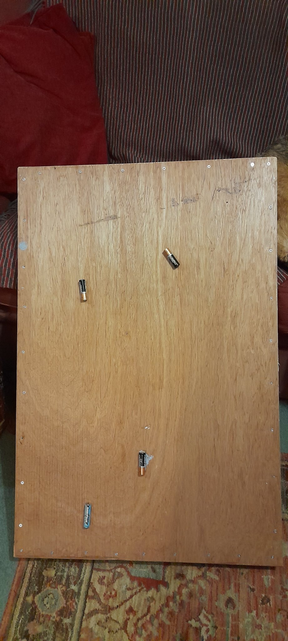

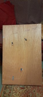

Hello Christian.
The batteries were used on a 3ft x 2ft panel that had the edges firmly attached to 4cmx6cm wood frame.
The batteries were placed inside the frame area at various points.
Using light weights in these positions would have made little difference.
The weights depends on the weight of the panel itself.
You would not use the same size weights for an eps as you would for a 5mm ply panel.
Also what would be best for the sound , a rigid mounting a soft mounting or something like rubber or mastic, either reflective or absorbing.
I use these points to either fill in the large dips I the response in the 100hz to ,let's say 300hz area.
But this can also affect the sound of the panel overall.
This picture is one I posted on this forum in September 2022 with a recording of the sound of the panel changing when I placed my fingers in these different positions while playing pink noise.
This is a small cc panel , so the edges are the best places for these positions.
This shows why it is so important to place the weights in the correct places for best sound quality.
Steve.

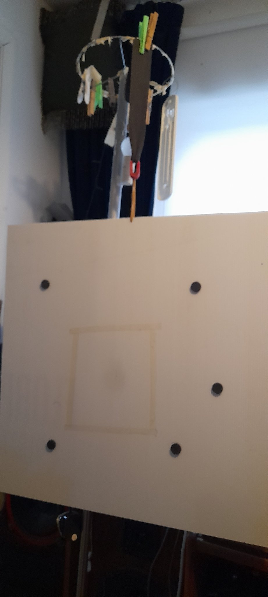

Hello Christian.
The batteries are about 25grm plus the blu-tack used to attach them.
I tried to find the positions of the batteries on this panel, I could only be sure of these 4 positions in the photo.
The magnets weigh about 8grms plus blu-tack.
I have found it much easier on thin panels to use two magnets , one on each side of the panel, so that I can slide the magnet one side and the other magnet will follow.
When a good position is found I just leave it there, then apply two more magnets and do the same again until I am happy with the response and sound.
On small panels I sometimes use old small button batteries which are much lighter.
Steve.
