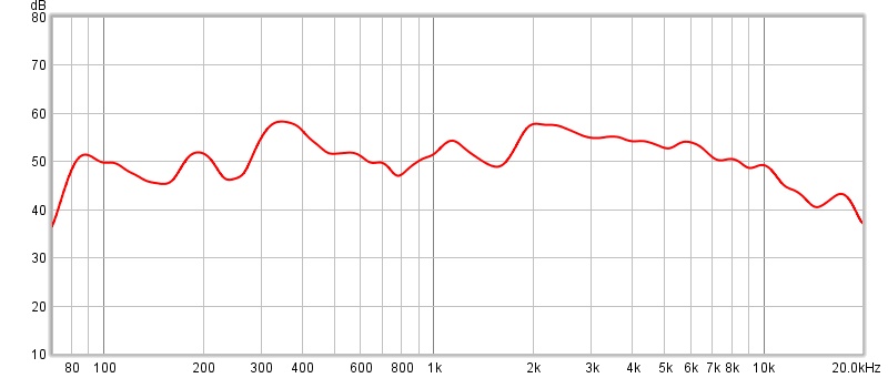

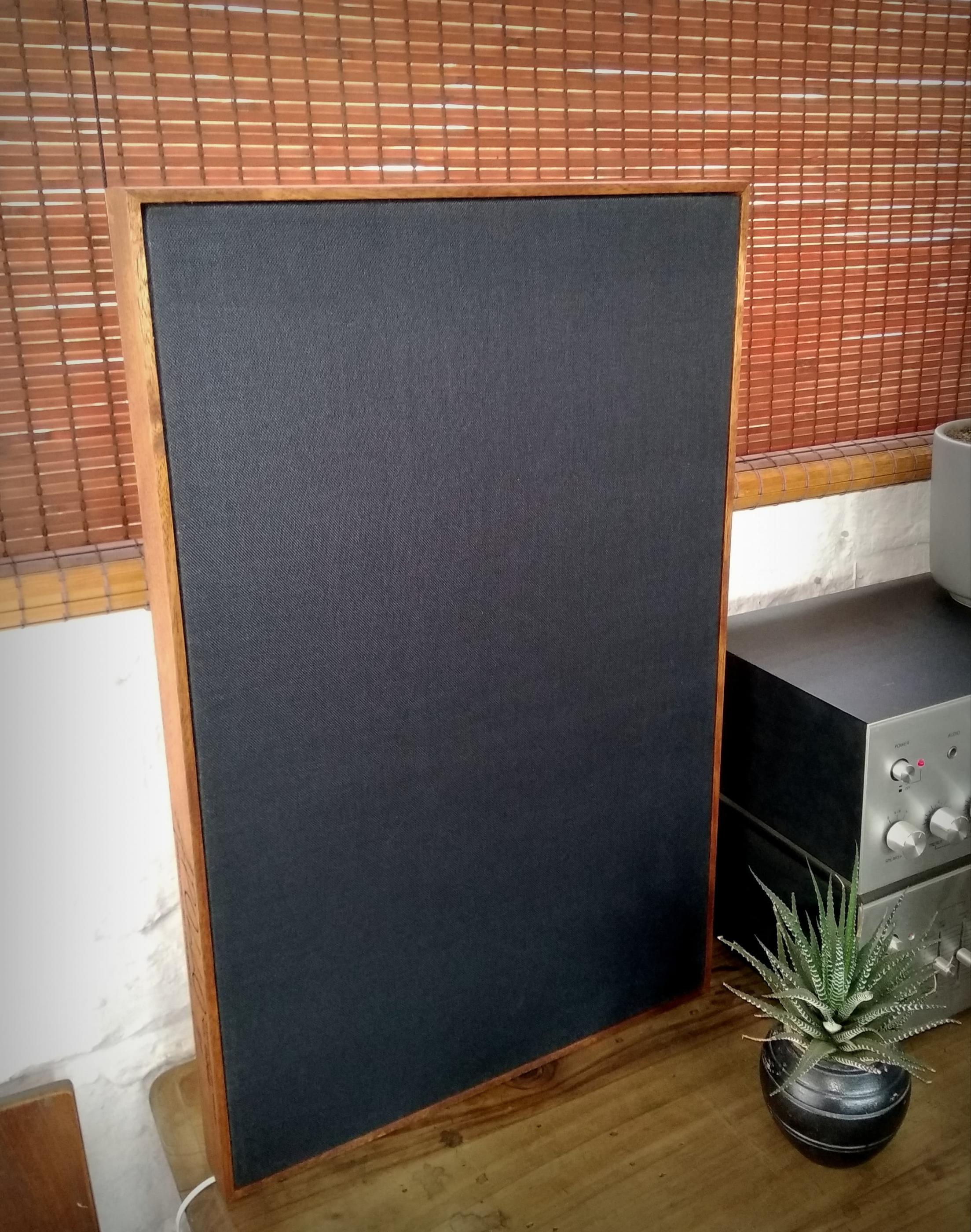

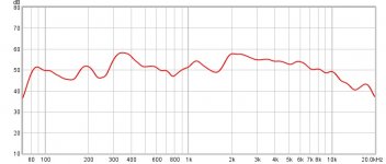

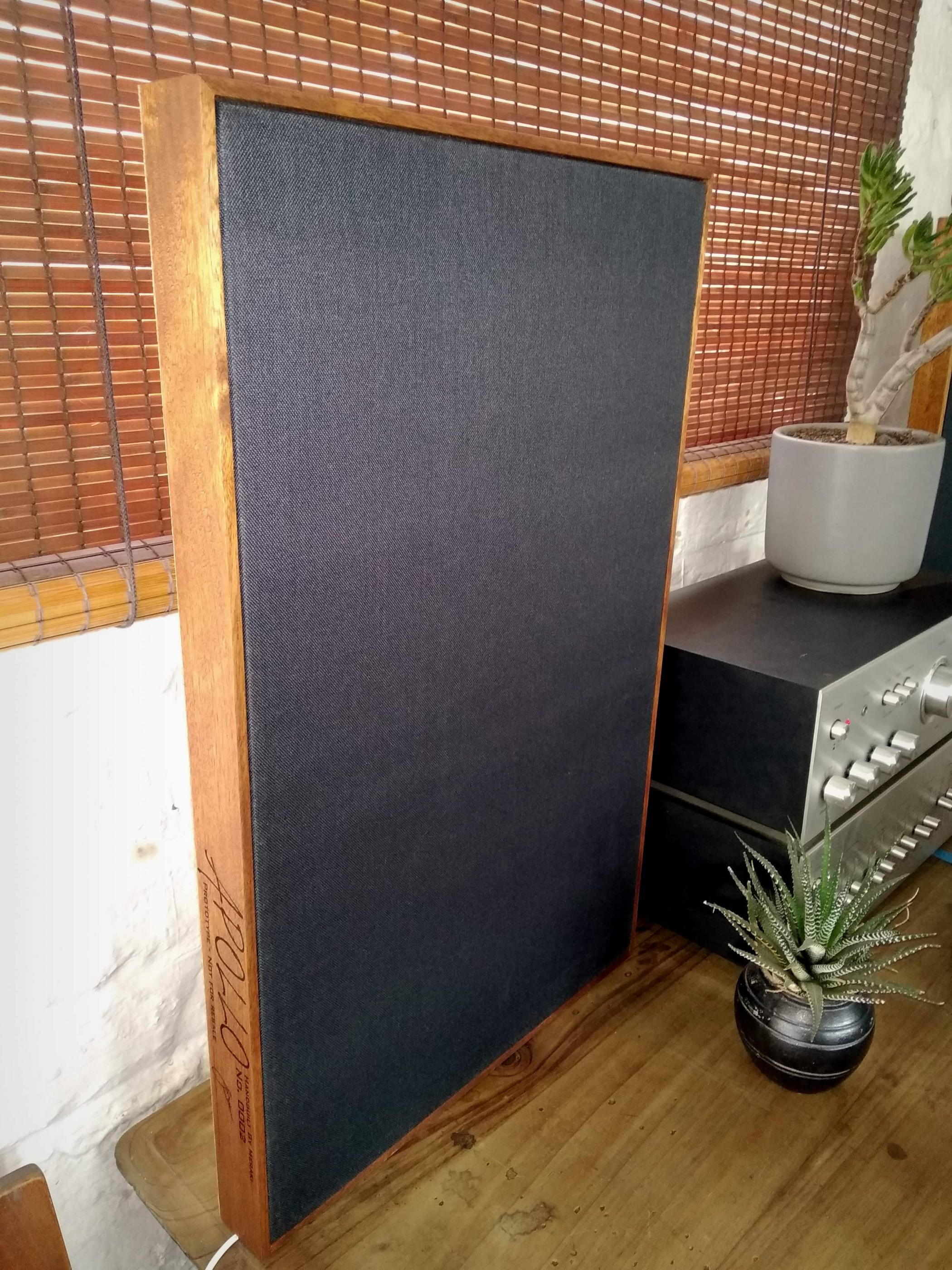

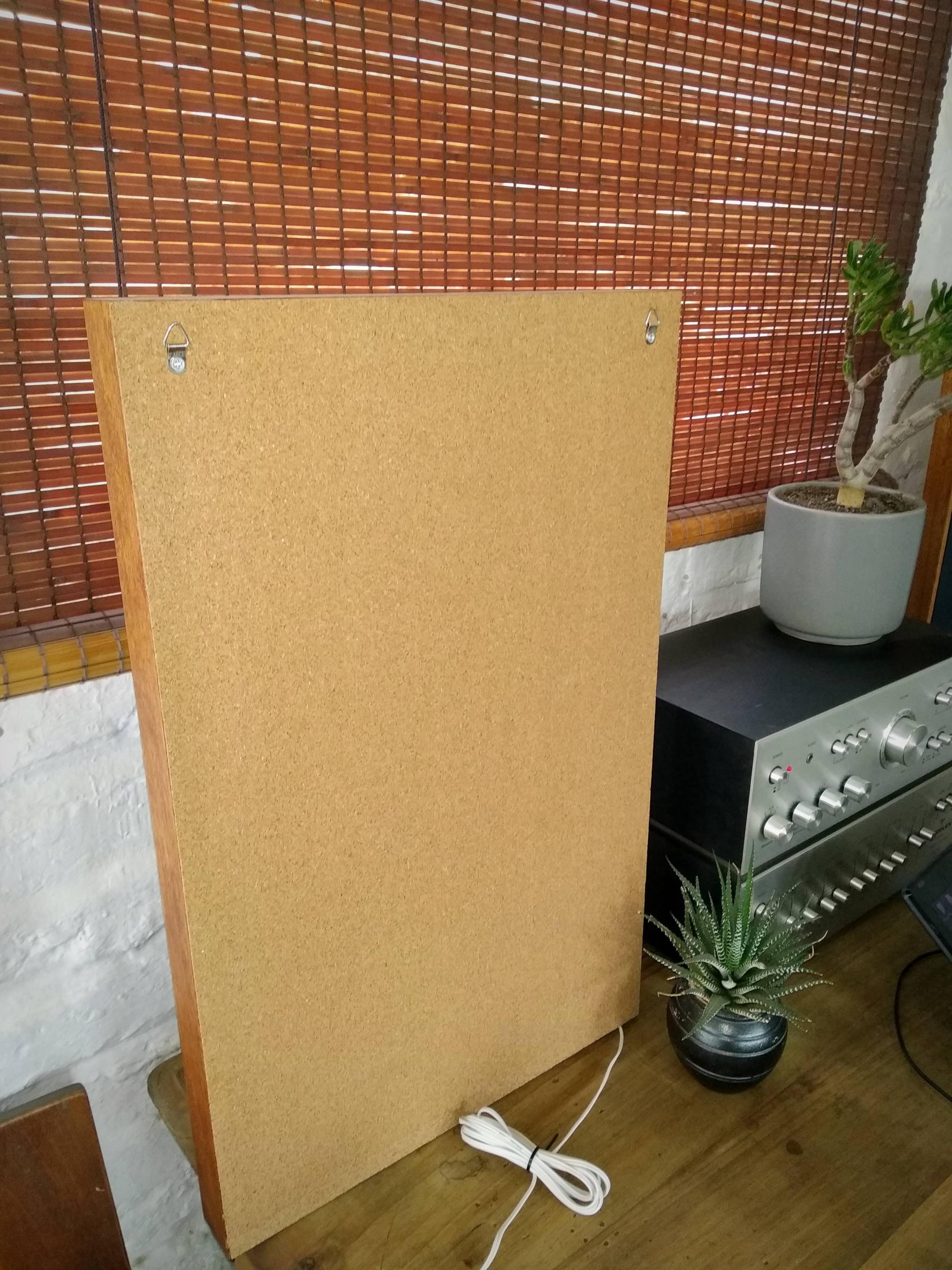

Hi all,
It's been a while but I've finally managed to finish my first test pair. They are small'ish carved XPS panels (350mm X 560mm) suspended within a hardwood frame, polyfill and cork backed because I want them to be wall mounted.
They sound very good paired with a small subwoofer but they did lose a tiny bit of magic when I closed up the back.
Attached is just a few quick pics and a REW measurement.
........on to the next panels

Jmatt,
Those look great. Is the REW measurement with the back on or off, and what is the suspension method for the XPS panel within the frame?
Thank you, the measurement is with the back on. The panel is suspended by a bead of silicone on top and bottom tabs.

Here are 2 tips.
1. you could of left the back open and put 1-2inch spacers (with foam) to get some of that bipolar magic back.
2. If the wood frame is touching the wall it will vibrate the wall so some type of foam damping can be used in the back on each corner.
Also is that Grill cloth? If so you are the first person that I've seen (besides myself) use grill cloth. Grill cloth can help in taming the sound of the panels making them sound less harsh.
